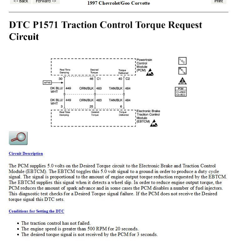

The PCM supply a 5 volt to the EBCTM module.
The EBCTM toggles the 5volt to ground depending on the amount of torq reduction the EBCTM want .
The signal looks like the last screendump .This DTC could be caused by a faulty EBCTM

The first thing I recommend to do when having a EBCTM problem is to verify proper voltages and grounds to the module .
Depending on the DTC I would verifty the wirings of the faulty signal
Below is the schematic of the rear mounted ebctm on your car
