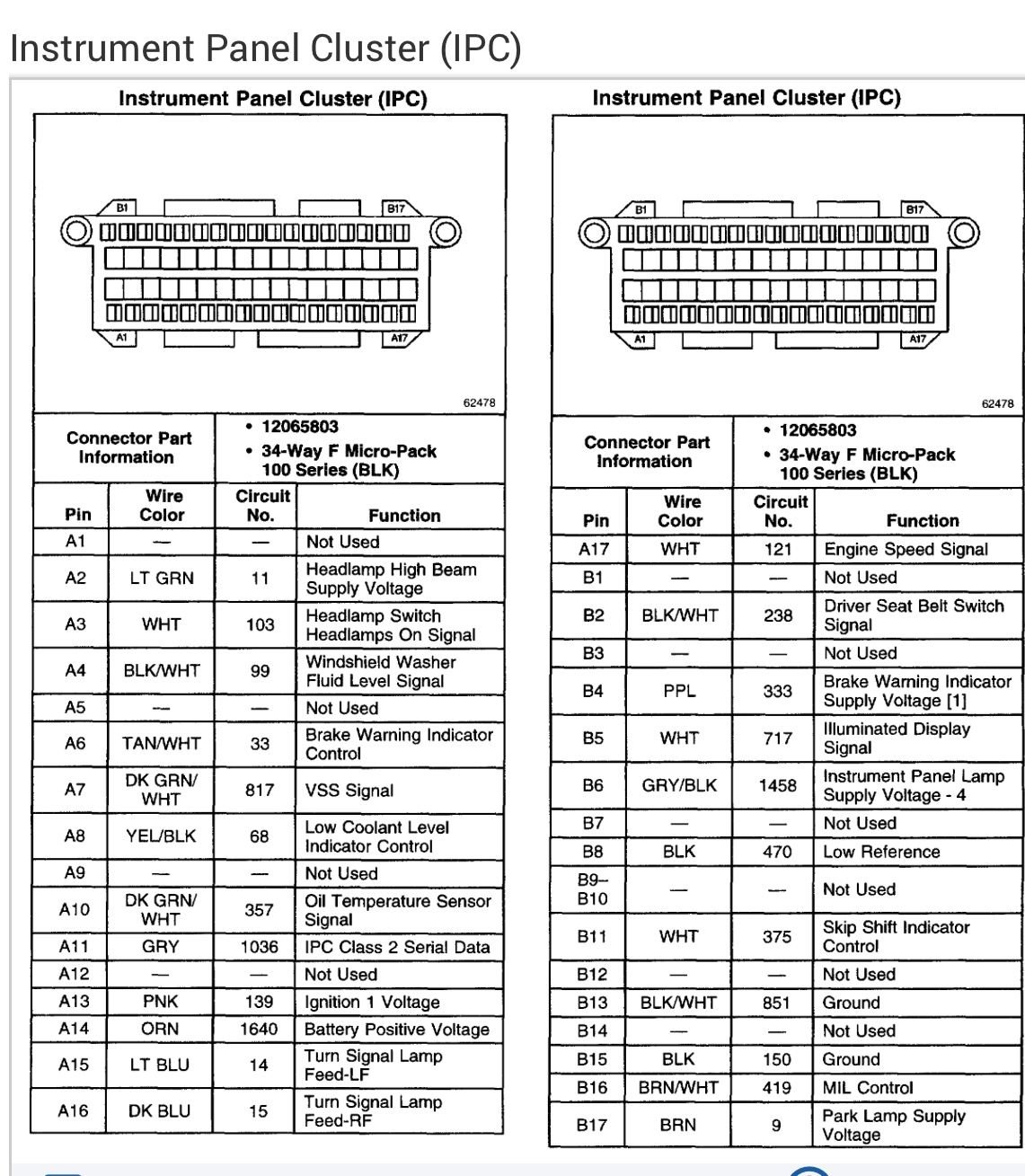

Bought an Autel MK808S, cleared every DTC code. Re.ran diagnostic. In the hot function I can make the windows operate. But I find it hard to believe both switches go out at the same time. As far as the instrument cluster, all I get is cannot communicate... any ideas anyone? There are zero codes now coming up on the vehicle.
Old Aug 3, 2024 | 01:02 PM
C5 Diag's Avatar
C5 Diag
Moderator, Tech Contributor
Posts: 15,627
Likes: 4,071
From: Cape Coral, Florida
For any module “no comm” the first thing you want to do is check the IPC power and grounds…pull the IPC and then check A13 with key on and A14 is battery voltage…you can just use a 12 volt test light…to check the 2 grounds B13 and B15 connect test light to A14 and probe both grounds…if grounds are both good IPC is bad…there is something you can try is find the 2 splice packs to the left of the BCM and remove the “comb” or buss bar off the connector with the 8 or 9 wires and clean that comb with some sand paper…if it has some corrosion the scan tool will not be able to communicate with it or any other module…you may also want to check for continuity between A11 at the IPC and the splice pack…if the wire is broken somewhere you also will not be able to communicate with the IPC.
