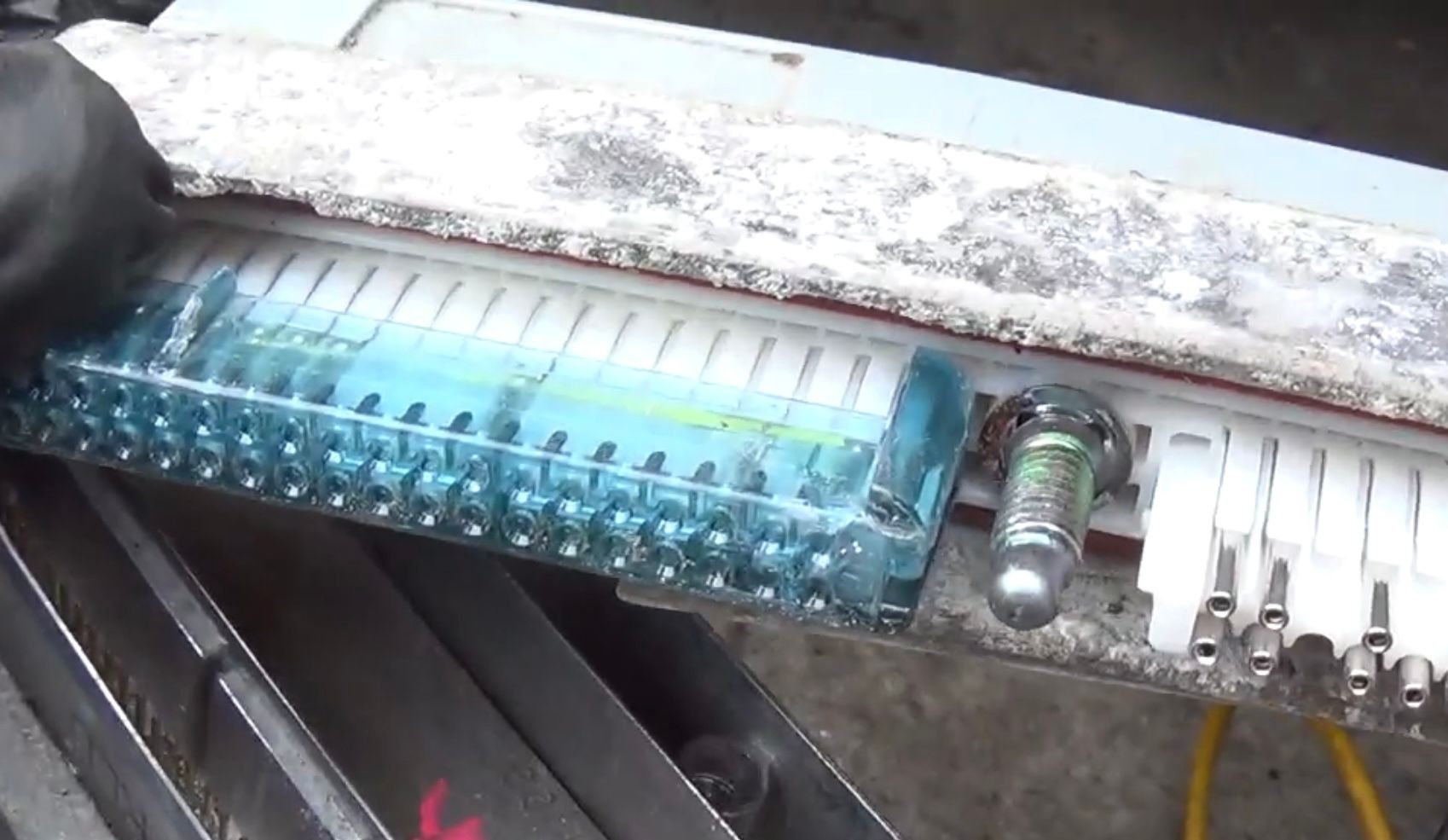

Originally Posted by mmartinez
Might check the PCM wiring, pull connectors off and blow dry the cable connectors and the matting connectors on the PCM.
Disconnected pcm and these hit the floor
Old Jul 29, 2024 | 09:59 PM
mmartinez's Avatar
mmartinez
Joined: Sep 2008
Posts: 3,134
Likes: 802
From: Espanola New Mexico
Sorry to see that, unfamiliar with that sort of problem, does that mean that the connectors will have to be replaced?

Originally Posted by C5 Diag
CKP sensor is not usually ohm’ed out to check it but you should check it for the 12 volt feed, low reference (ground) and signal before replacing…and use an OEM sensor if you do replace it…has the car has been running fine with the LS3 ???
Yes car was running good with LS3.
I dont know if it is a LS1 or LS3 crank sensor.
cam sensor has an adapter but crank sensor does not. Guessing it is a pcm issue with the broken connector pieces. Looks like I will purchase a blue/red connector kit and replace the broken parts and see of that does it.
