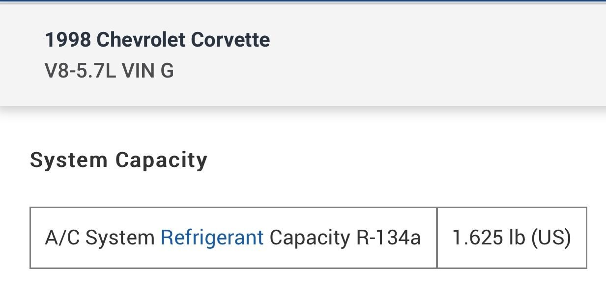

FYI…capacity for a 1998 is 1.625 lbs (26 oz)….OP is 2 oz short but I personally wouldn’t sweat 2 oz !!…you know I don’t like misinformation !!…a 1997 is 1.63 lbs and a 2001 is 1.50 lbs for instance…year matters.
For sure. Not sure why I thought the OP had an 2004 ...he did not disclose the year.

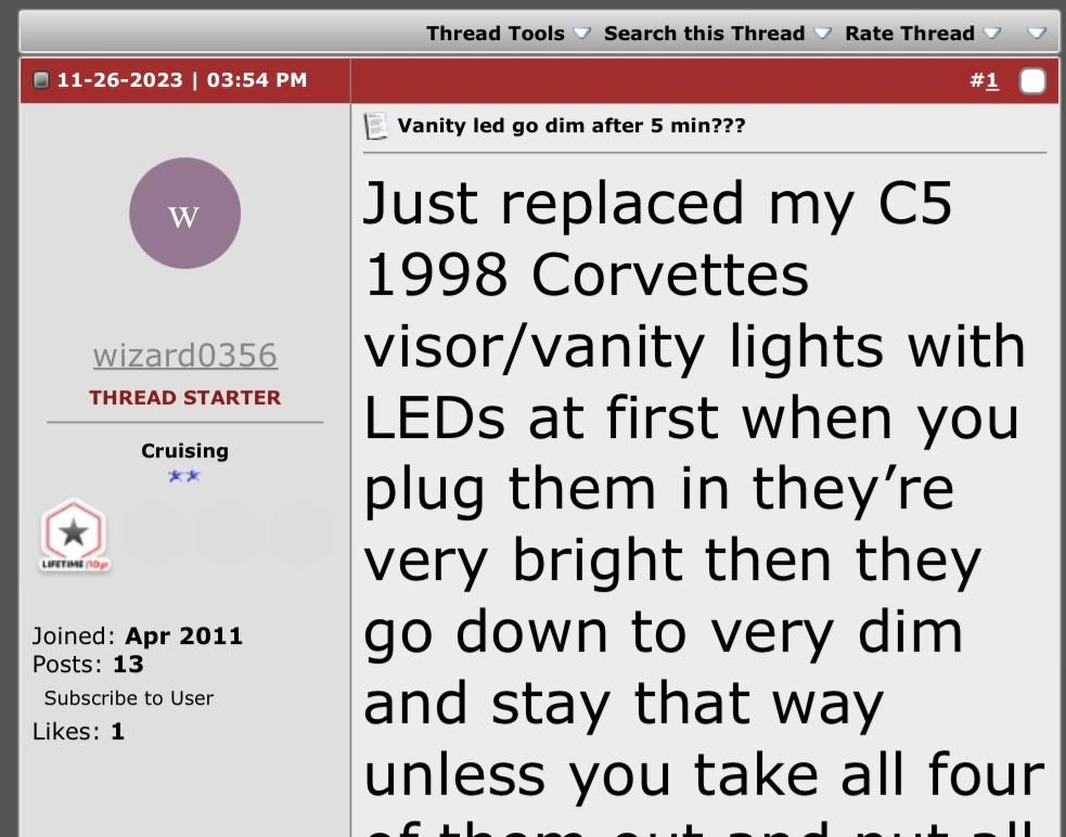

So he disclosed the year in a post from November of last year. Ok.
