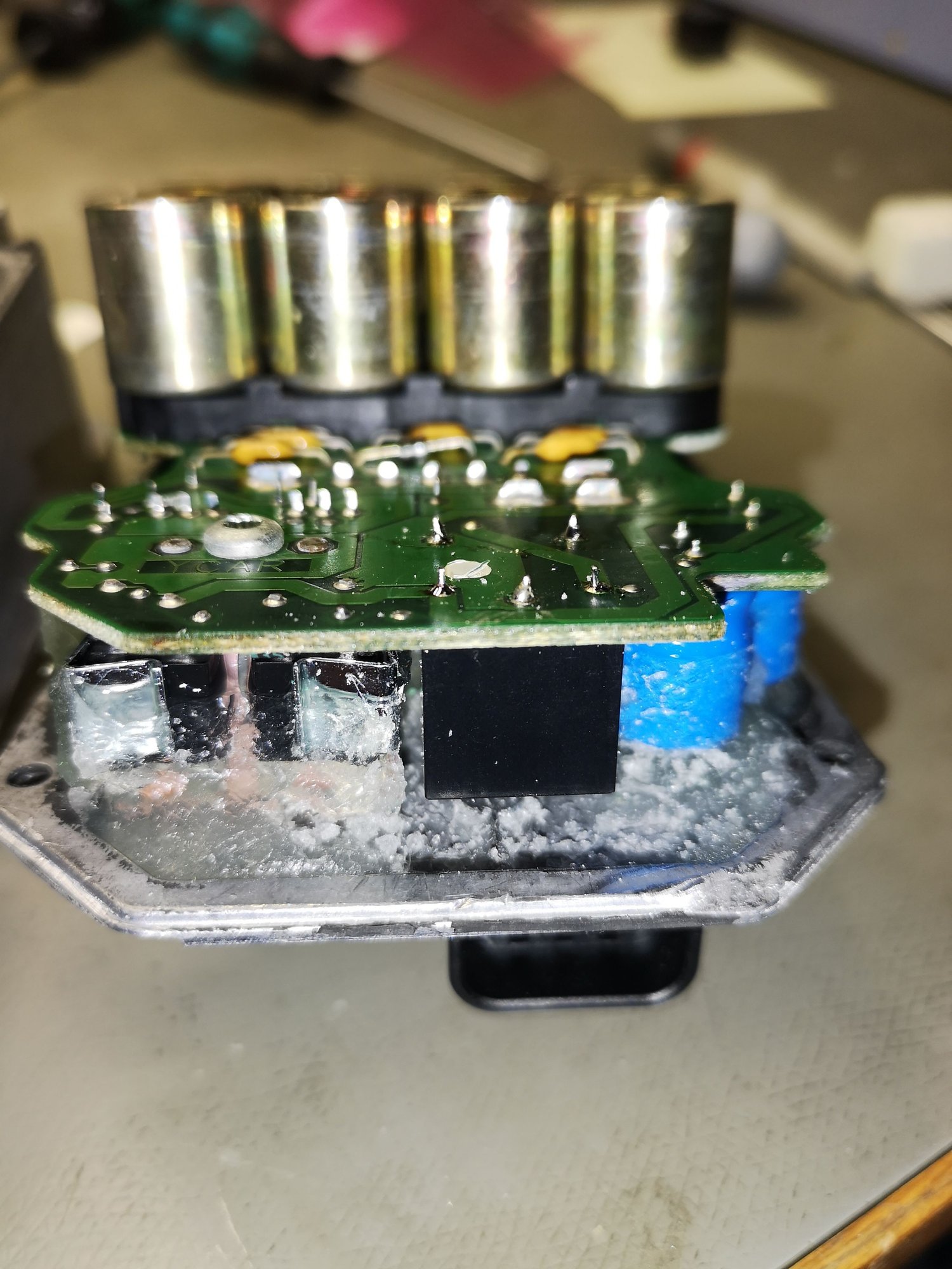

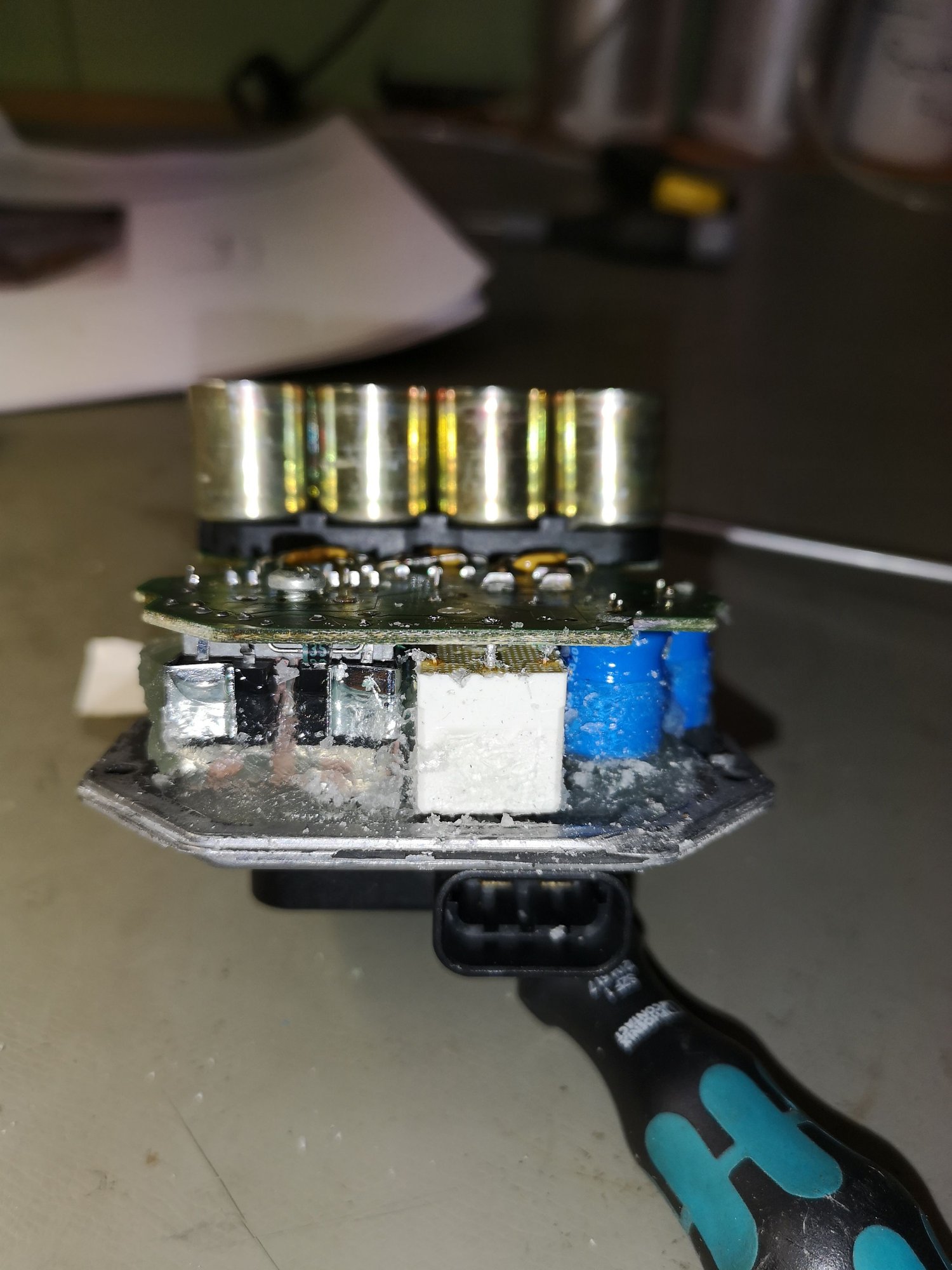

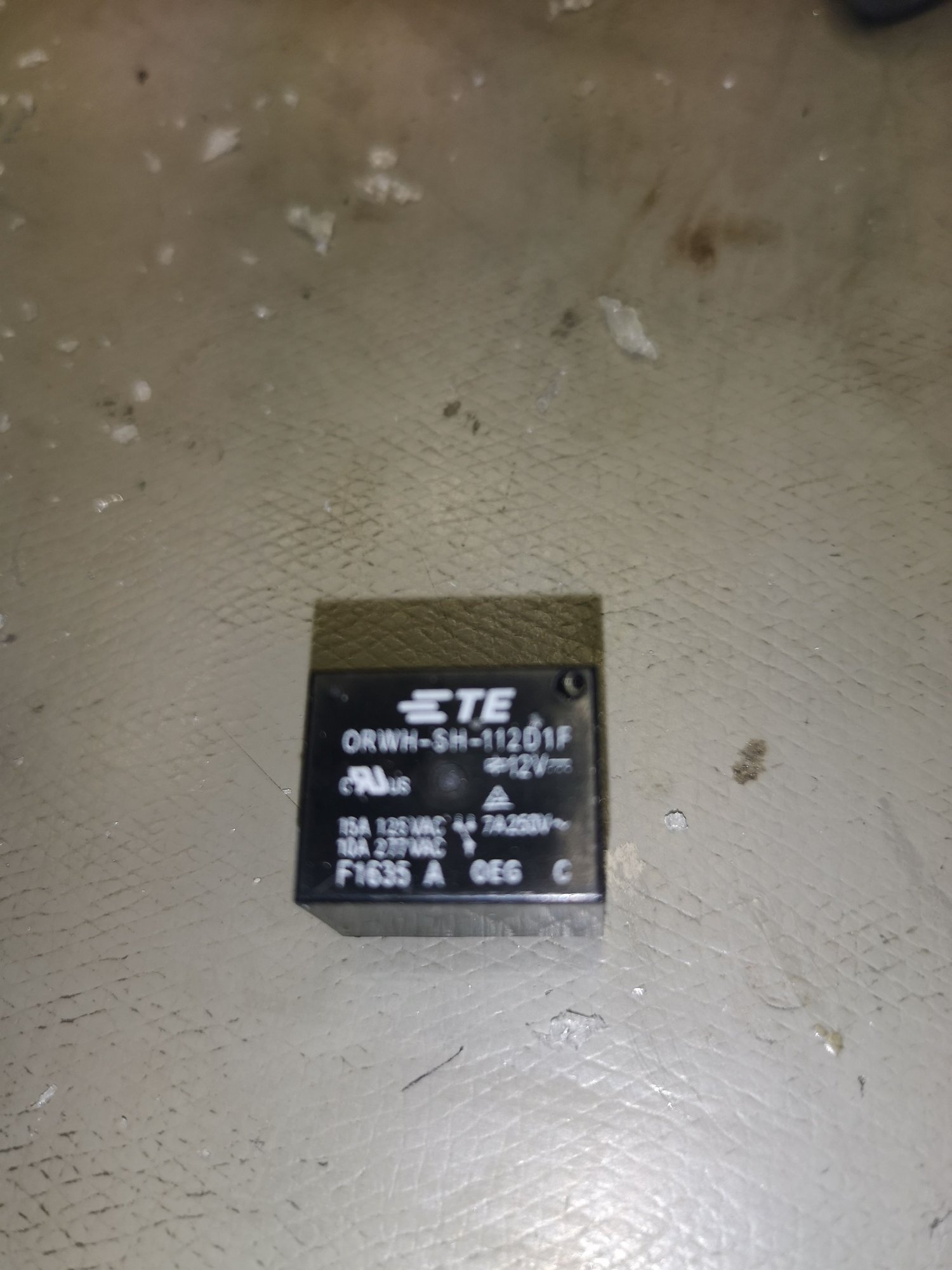

A friend of me had C1214 code that I fixed for him .
- I first removed the electronic part of the EBCTM from engine bay .
-Then I splitted this parts carefully using a knife/small hammer/screwdrivers
-I removed the white relay
-Insert (soldered) a new relay (black)
-Before I put this card containg the new relay I used new sealant all the way around (moisture will kill this electronic)
-After putting the electronis part of ebctm back in engine bay , the C1214 code was gone .
- I bought the relay (3 pack) of ebay
Nice work!
It's worth noting that many of the people who opt to replace the relay don't try *only* redoing the solder first. I opted to re-solder only, and figured if the code returned the next step would be relay replacement. And as noted, no issues now for ~6 weeks (knock on wood).
Don't get me wrong, "while you're in there" relay replacement isn't a bad idea because of the hassle to potentially need to take out the EBCM again later. Just seems like it's rarely needed.
