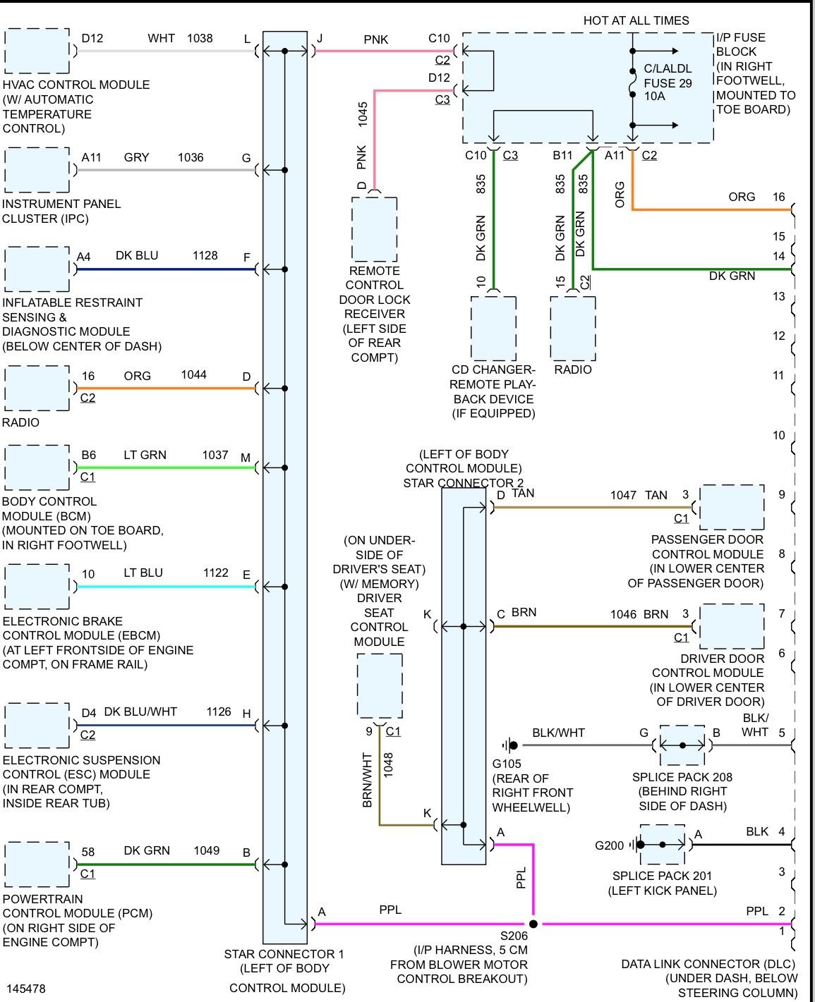

Classic serial data bus issues…forget about the dealership diagnosing this because they’re CLUELESS !!…this is not a hard diagnosis!!…all of the cars modules communicate with each through a single wire that allows all these modules to talk to one another…if that single wire is shorted to power or ground you’ll see all those DIC messages, fuel gauge goes to E, water temp maxes out, power windows don’t work and car will either not start or start and stall…what we have found here through the years is the driver door module connection which is inside a rubber boot which is seen when you open the door…shake the rubber boot to improve that connection and see what happens and if that doesn’t work report back and we will try something else…if you have a scan tool and try to connect it all you’ll see is “can’t communicate” with the car…if this diagnosis is over your head take the car to an auto electric shop and tell them you have this issue…do you have a copy of the repair order ??…curious to see what they found.

Serial Data Bus wiring.
