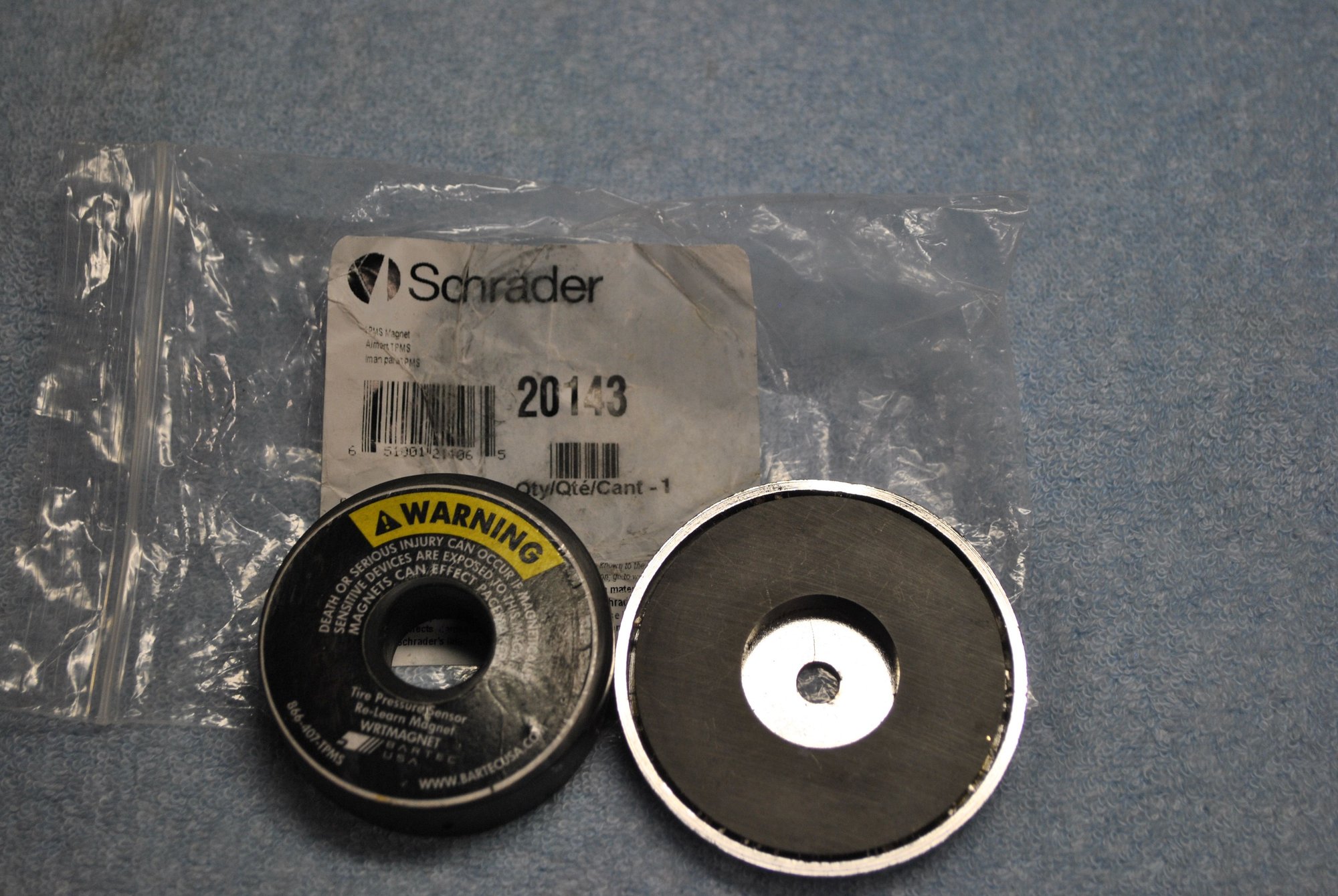

Old Aug 15, 2024 | 08:29 AM
leadfoot4's Avatar
leadfoot4
Active Streak: 90 Days
Joined: May 2001
Posts: 87,302
Likes: 1,583
From: Western NY
I've used both of these, with success.
To Tpms
