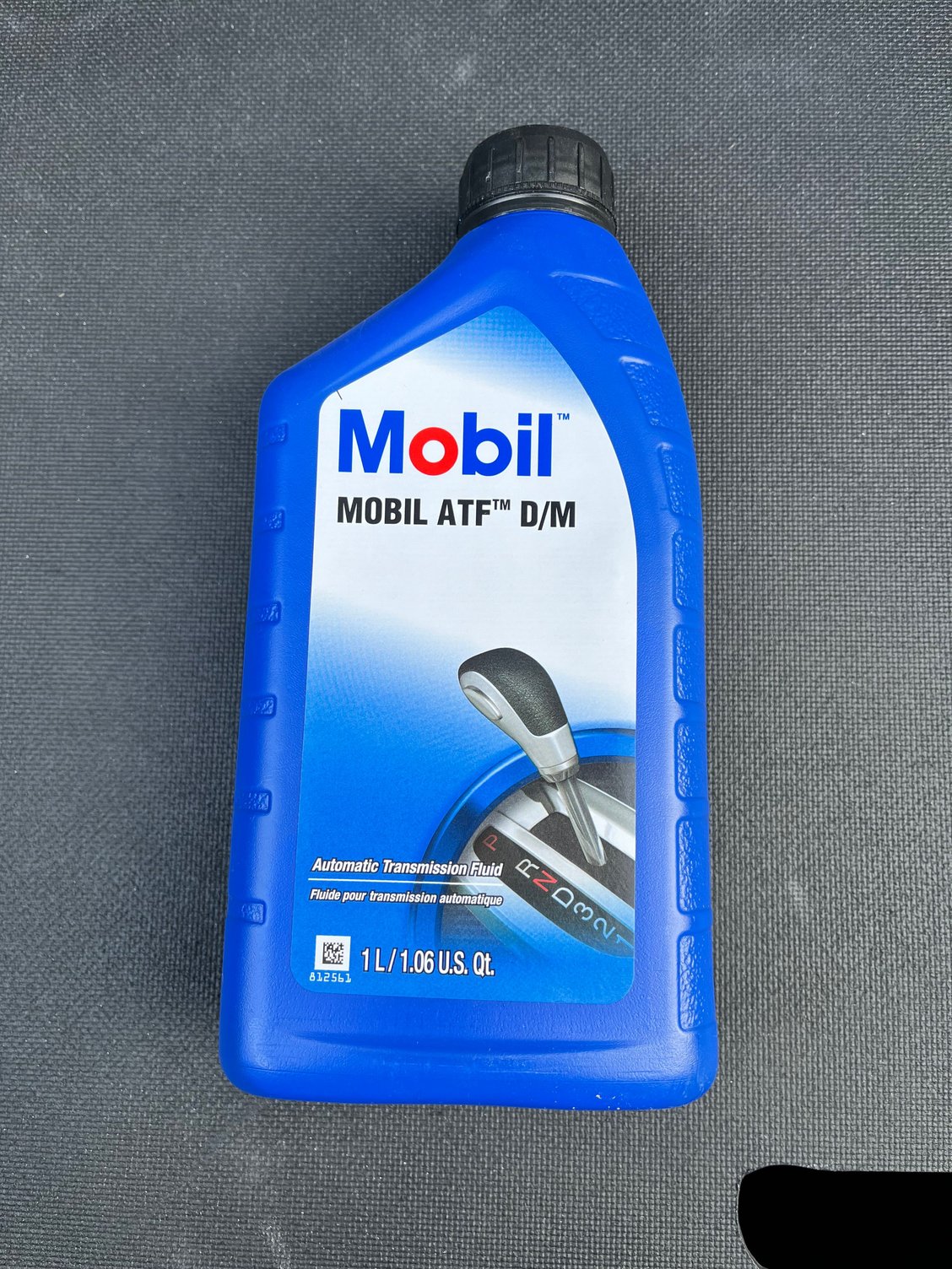

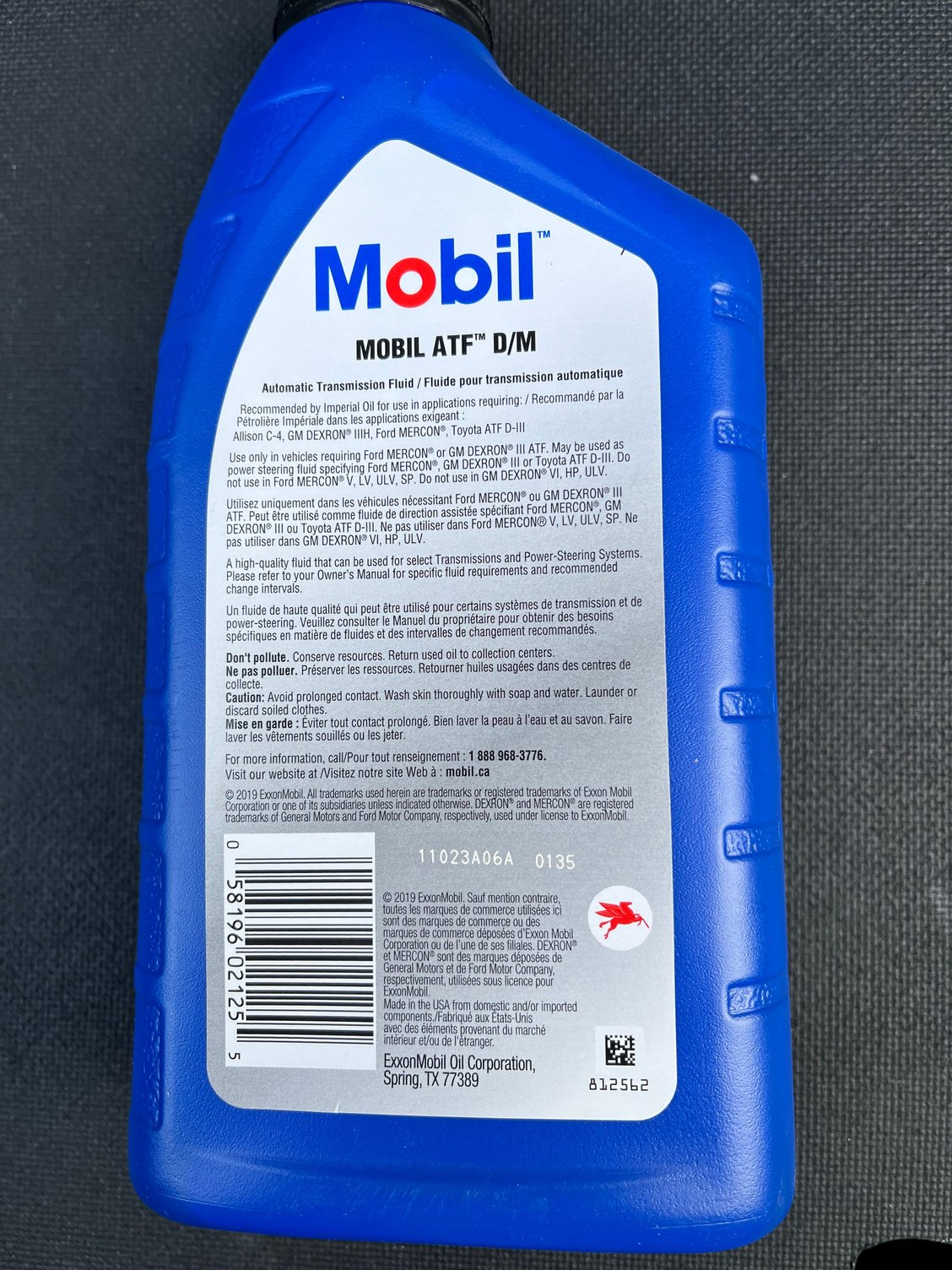

Old Aug 14, 2024 | 04:11 PM
captain vette's Avatar
captain vette
Joined: Dec 2015
Posts: 3,947
Likes: 1,407
From: Canada
You need non synthetic Dexron 3 compatible oil like this one
