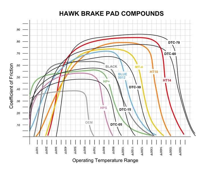

KNS plain brake rotors, dot 4 hawk HP600 fluid, and Hawk HP+ pads. It’s all you need, you can daily drive, do auto cross, or HPDE with this setup. Hawk HP+ pads make some noise and dust, but any compound that you want for an HPDE will all make noise and dust. You can probably daily drive on carbotech XP8, I haven’t though. Hawk pads just fit my budget better. Rockauto has raybestos track pads, I haven’t tried those either.

I used the Hawk HP+ pads for low speed autocross and they worked well; good initial bite and easy to modulate. However, for HPDE they would overheat and fade in high speed braking zones. I switched to the Hawk DTC-30 pad for HPDE with good results. I was running 200TW street tires and no aero. Both pads are noisy and produce a lot of dust.

Hawk HP+ work for me, I’m a newb driver at HPDE, I can only go like once a year. I’ve never used 200TW tires, I heard there great. Best I’ve used is summer only 360TW tires. I can tell that a 200TW tires work better when I watch other cars fly by me. If you’re going to max out the brakes, I guess going with a better hawk pad would be better, for HPDE. I’ll keep that in mind for myself. Daily driving the hawkHP+ is scary and nice at the same time. If I brake hard with someone behind me, those pads stop the car so fast, I’ll get rear ended. They saved me once already when someone decided to make a u-turn right in front of me on a two lane country road. Initial bite and stopping power is great with HP+ pads. The noise and dust just suck.
