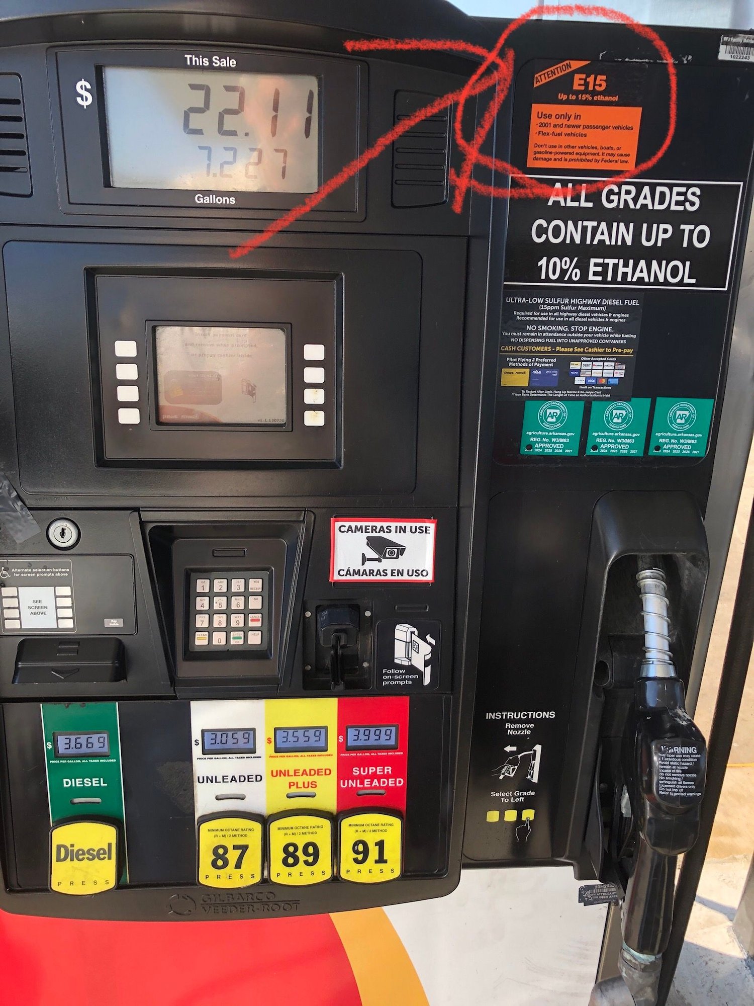

Check that NZ shows octane ratings that use the same methodology. US numbers shown on the gas pumps are (R+M)/2 but I think NZ shows only the Research numbers, which are higher.
You don't want unexpected results due to a difference in octane calculation.
Speaking of annoying gas pump markings:
E10 is standard where I'm from in the US but ran across this on a recent road trip. Pump has the standard E10 sticker but ALSO has an E15 sticker and all grades are actually E15. I didn't even notice until I looked at my receipt and it said E15. Then I looked at the pump closely and noticed the additional E15 sticker.
