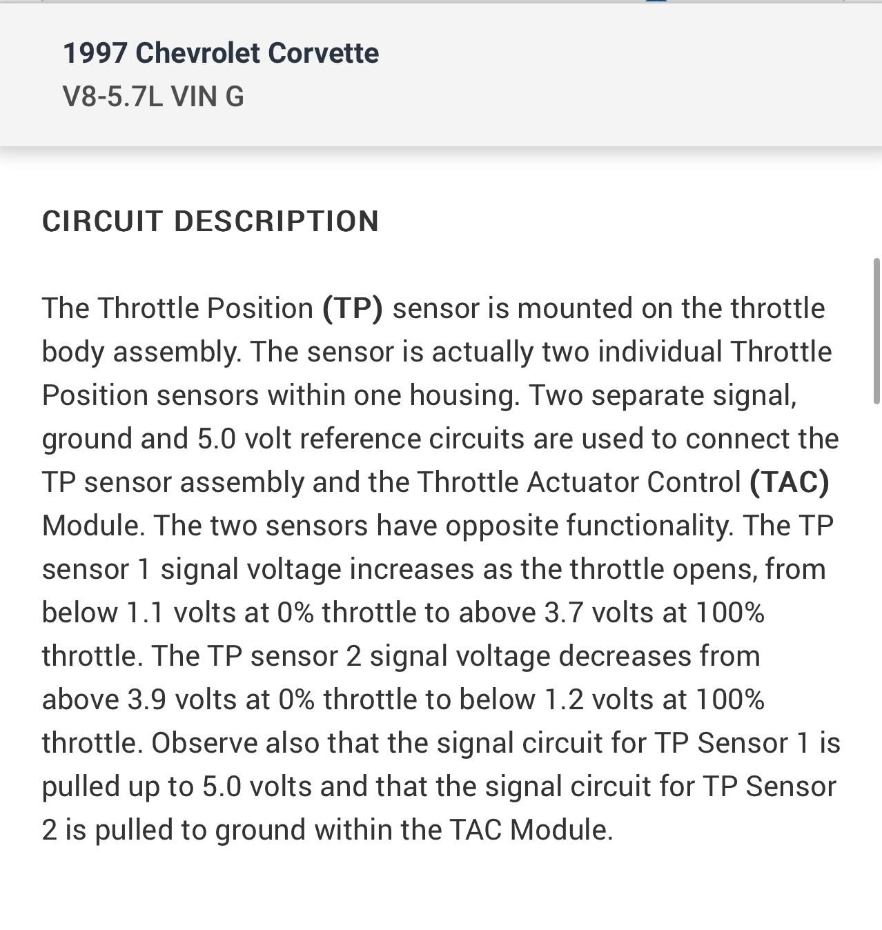

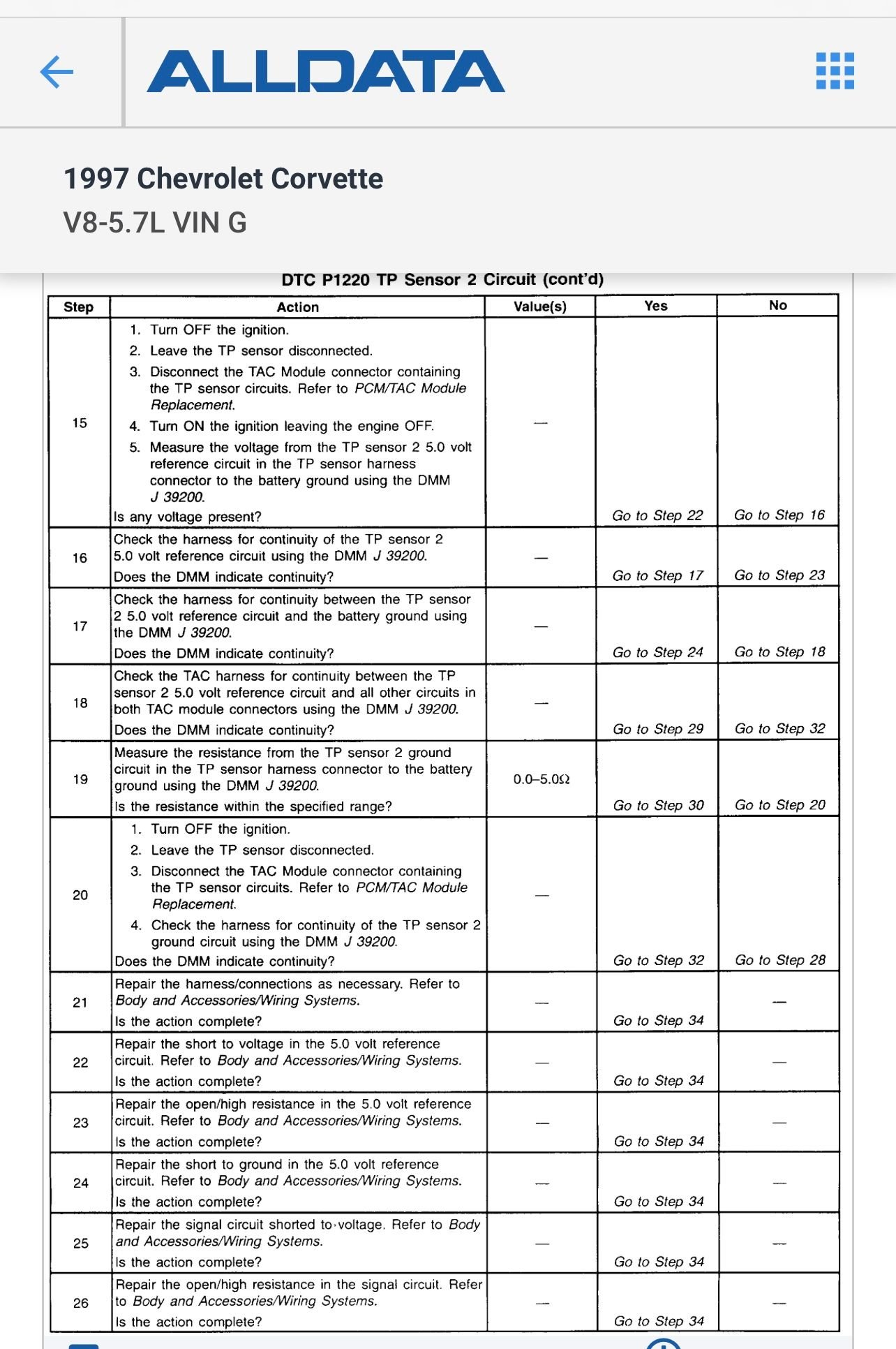

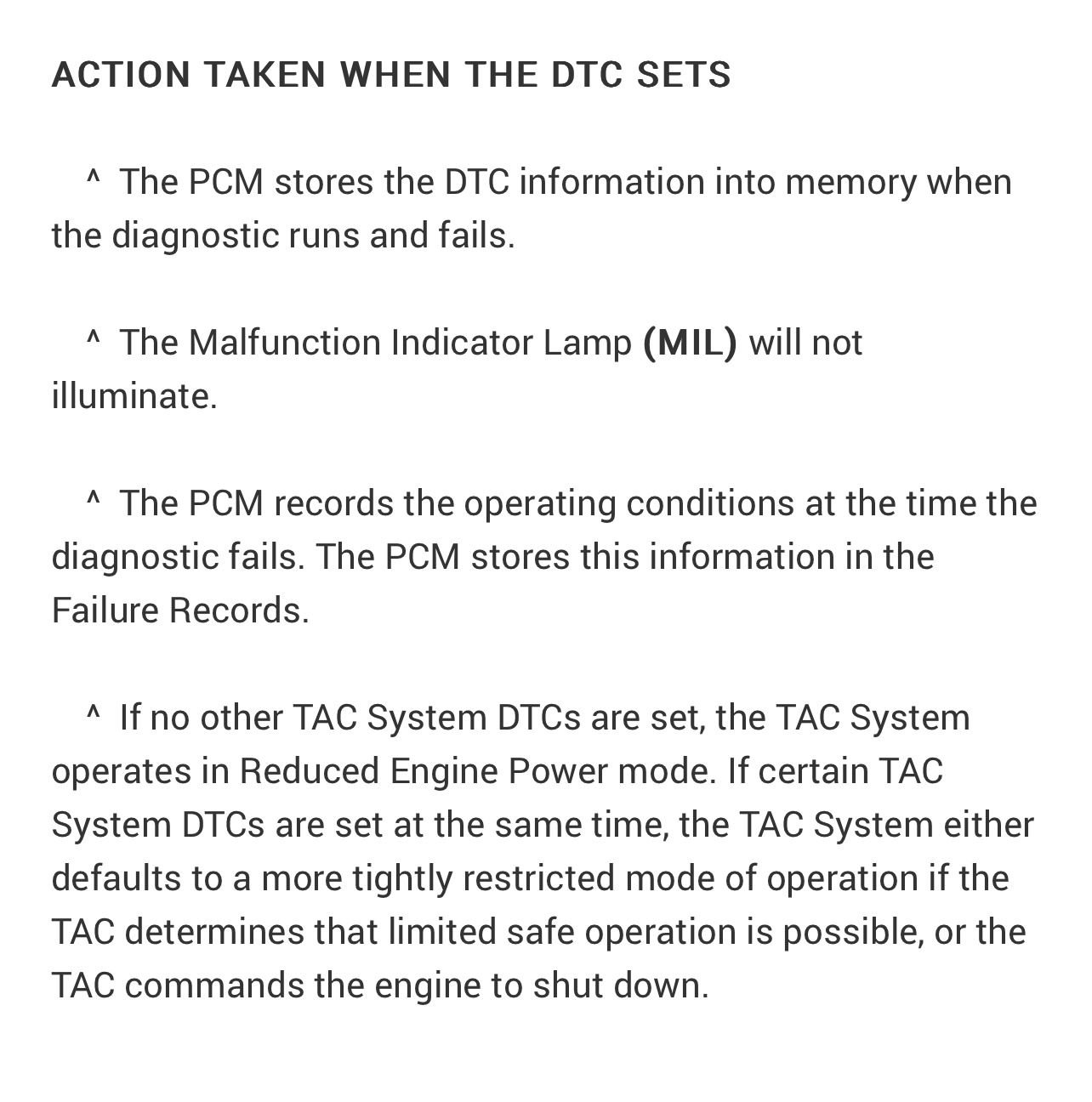

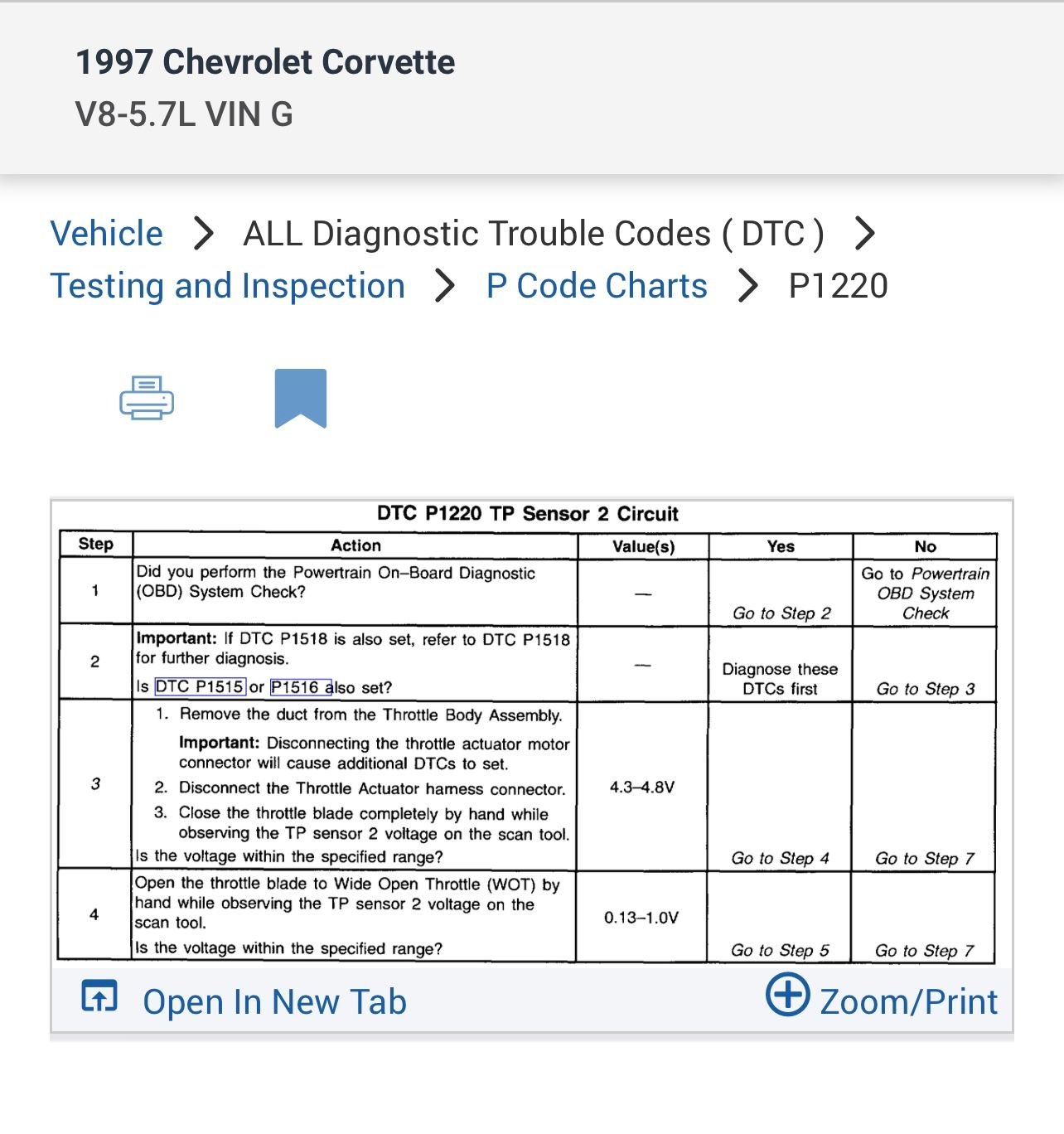

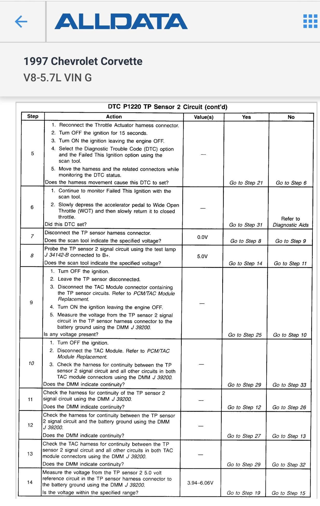

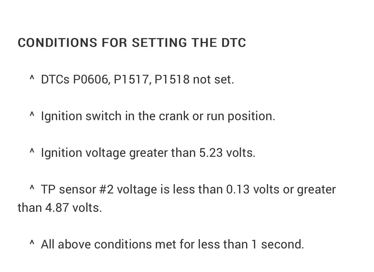

I would chase the P1220…do you have a scan tool that can look at the TPS sensor data PID voltages or do you have a DVOM and know how to use it…if this is over your head seek out a diagnostic shop or an auto electric shop…what sets this DTC is attached below…a lab scope is the best diagnostic piece of equipment in that it can see these small voltage changes that a DVOM might miss since its refresh rate is slow…a scan tool is a little better…you can make sure the wiring connector pins aren’t spread apart.

If you have a scan tool you can use that to look at your TPS voltage or you can use a DVOM…TPS sensors are simple potentiometers…you can look at the code setting criteria and the diagnostic “tree” below !!…if you have a scope you can use that too and would be your BEST choice …I don’t know what kind of help you need since it’s not going to be a blown fuse ??
