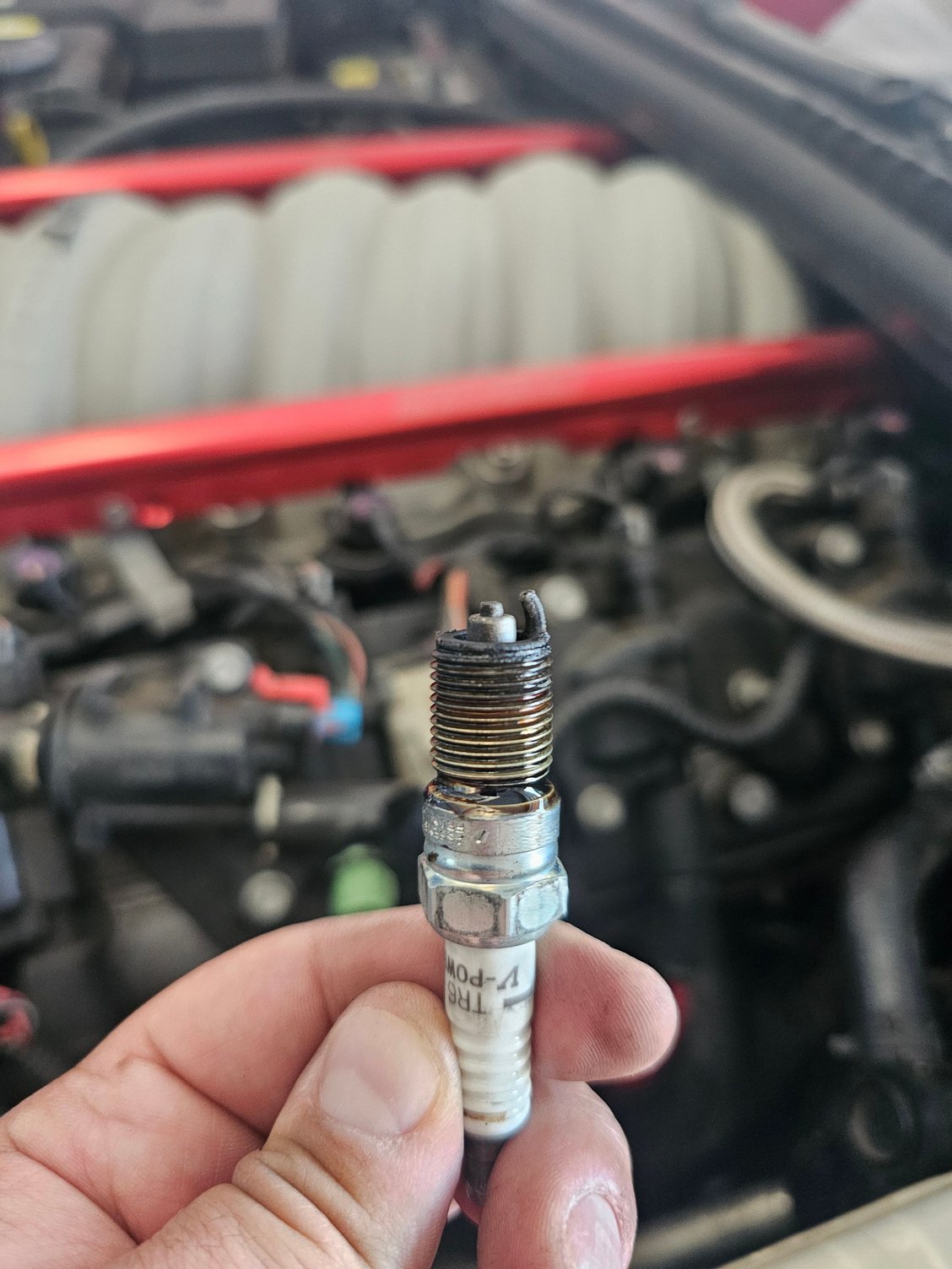

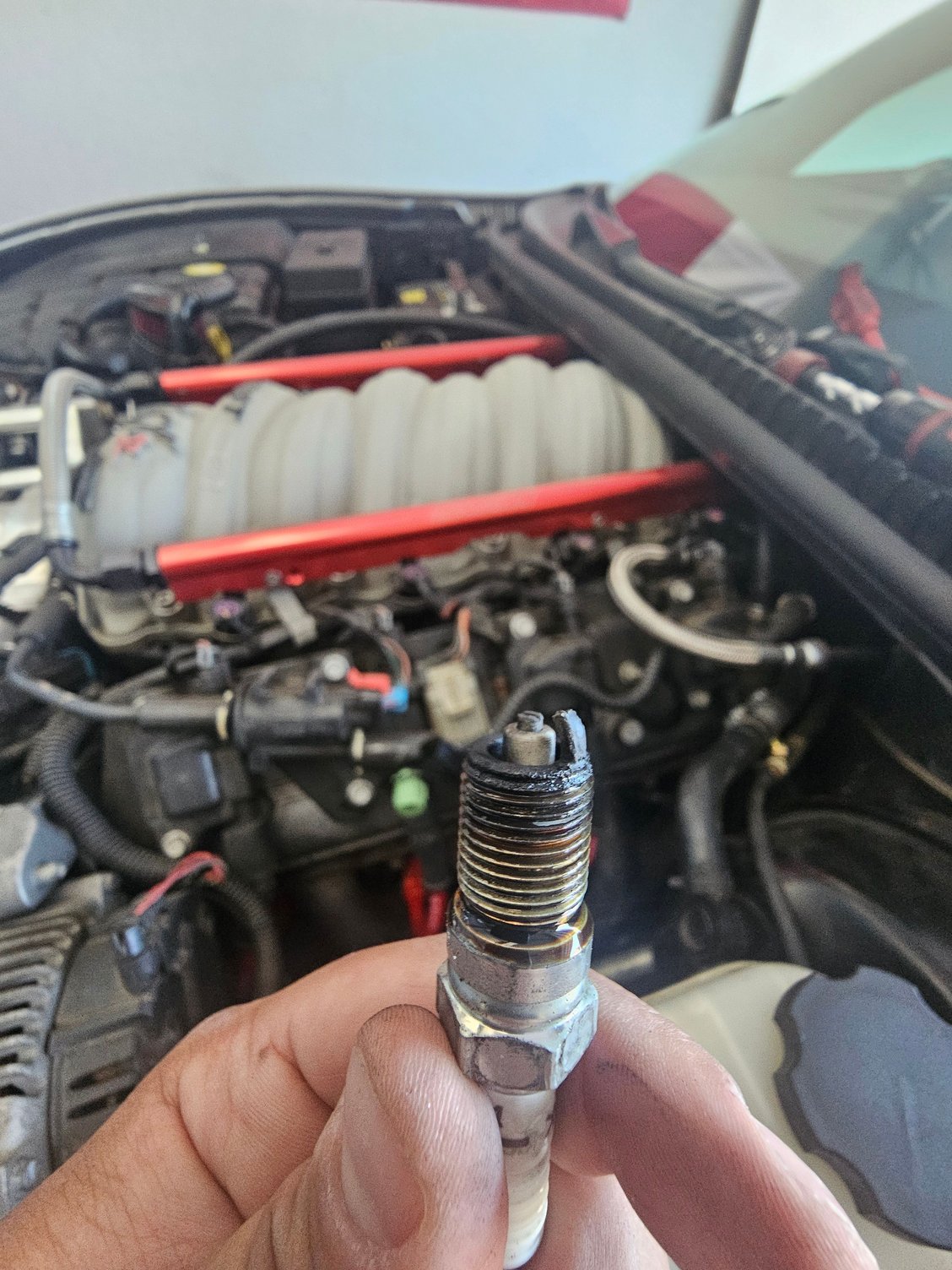

I have an 02 zo6 ls3 bottom end ls6 top end, recently noticed some misfiring. I decided to change the plugs and 3 of the 8 plus all on one side, the anode looks broken off. Has anyone ever seen this before

That electrode looks melted to me. Not sure that wouldn't be worse than physical contact...
Makes you wonder where the missing pieces went though, doesn't it?
Lay those plugs on a flat surface and take some focused, well lit pictures if you hope that anyone looking at them can tell you anything useful.

That is plenty useful, and it's most likely from a lean condition. The real shocker comes from the borescope.

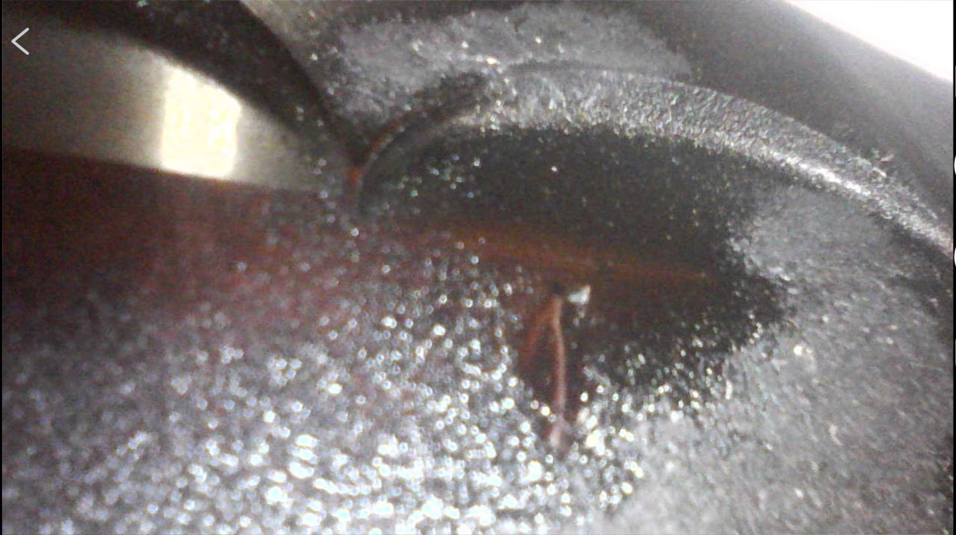

Posts: 30
Old Sep 10, 2024 | 07:14 PM
Nickp99's Avatar
Nickp99
Joined: Oct 2015
Posts: 30

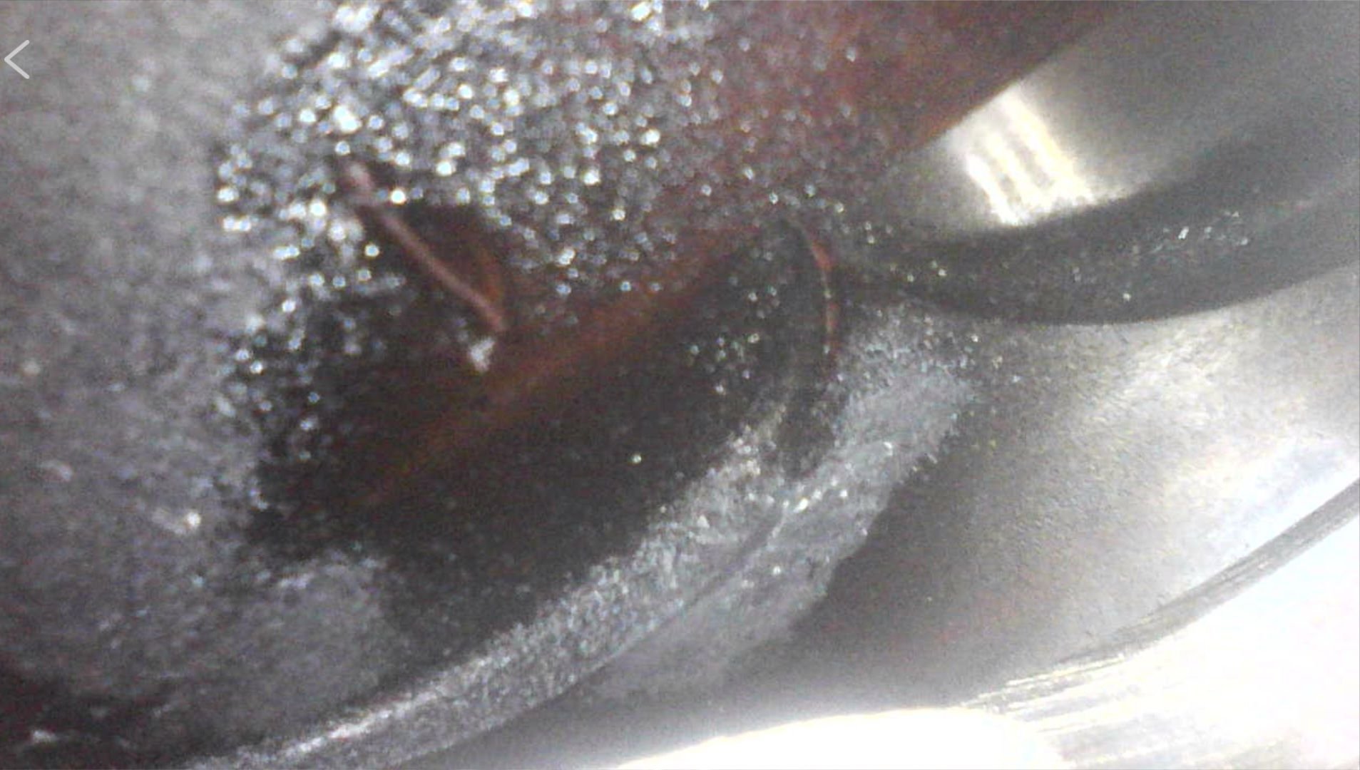

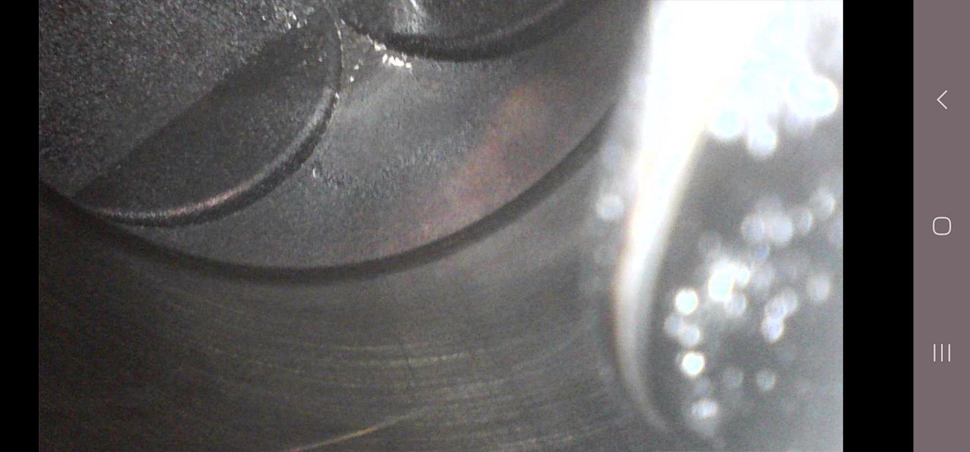

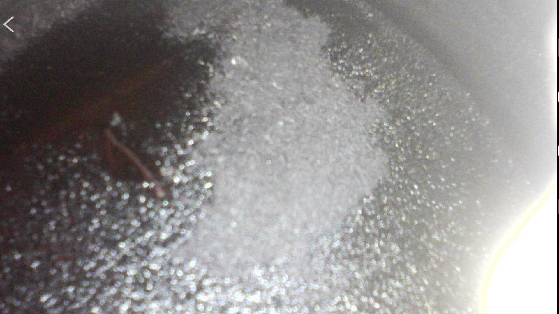

Heres a few pics i took of cylinders 3, 5, 7. I didnt have alot of time ony my hands, but ill try to take better more distinct snaps when i get a chance. May take me a few days.

I’d say you have a severe lean condition in boost. Those are melted.
So if this was once tuned and fine, something is amiss and it’s not going to be the tune.
Furl pressure at WOT. Plugged injectors on those holes etc.
Put a wideband on it, give it a toot and see what’s up.
Lucky, Ron - can you teach me a little about the fueling system? What might make three of the four cylinders on the same side lean? Something about the way the system pressurizes the injectors on one side? Something specific to boosted engines?

The first picture in the OP's first post clearly show what type of plugs he is running.
