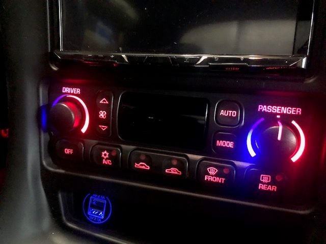

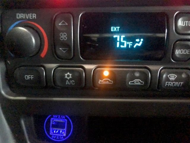

Update, after getting the HVAC working perfectly, decided to take a dead control unit and send it to Travis at Vettetronics for LCD repair and new red bulbs, great results !!
