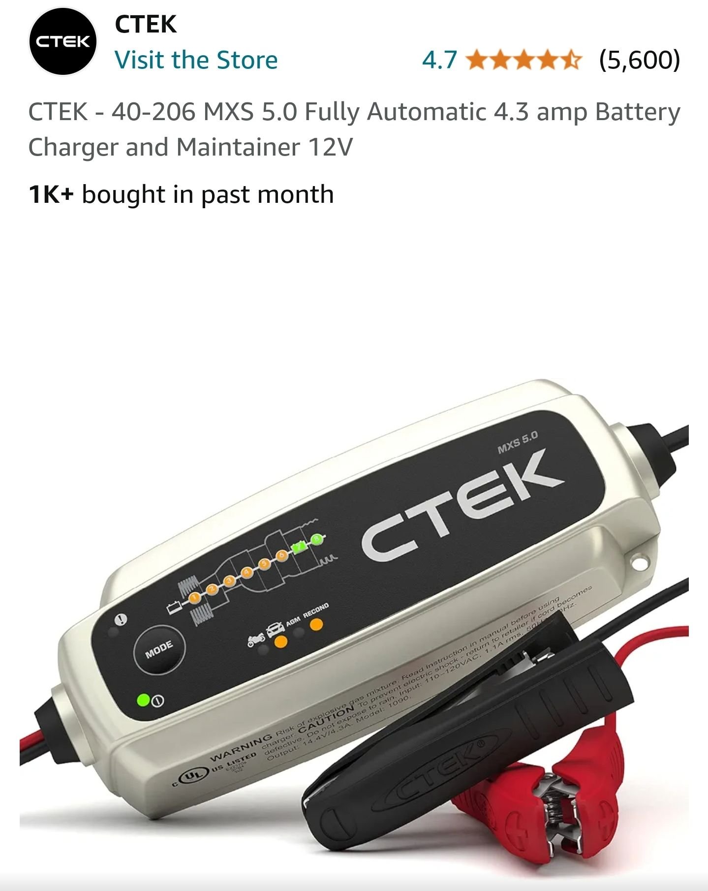

I have 3 of these I've used for years, they're the best imo, and go on sale once in a while for $79
Old Sep 22, 2024 | 12:20 PM
oktx's Avatar
oktx
Joined: Jul 2020
Posts: 550
Likes: 132
From: Texas

I favor the CTek chargers - https://smartercharger.com/collectio...-chargers/?i=1

Originally Posted by vortecman
My boss gave me one that came with his 2024 that plugs into the cig. lighter, will that be good for mine? ( 2002 )
Yes, it's a rebranded CTek. You can buy other connectors if you prefer to connect directly to the battery.
