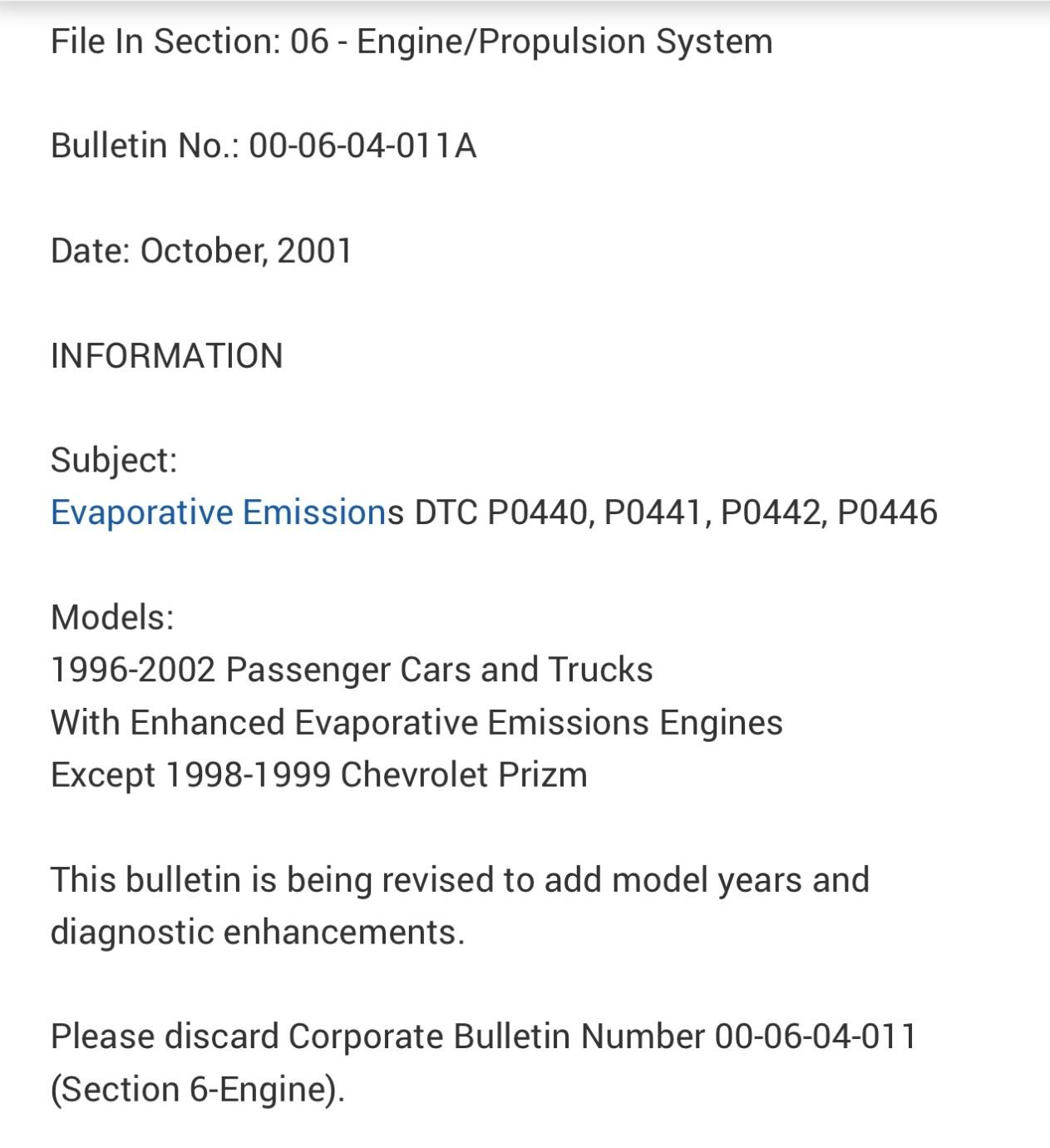

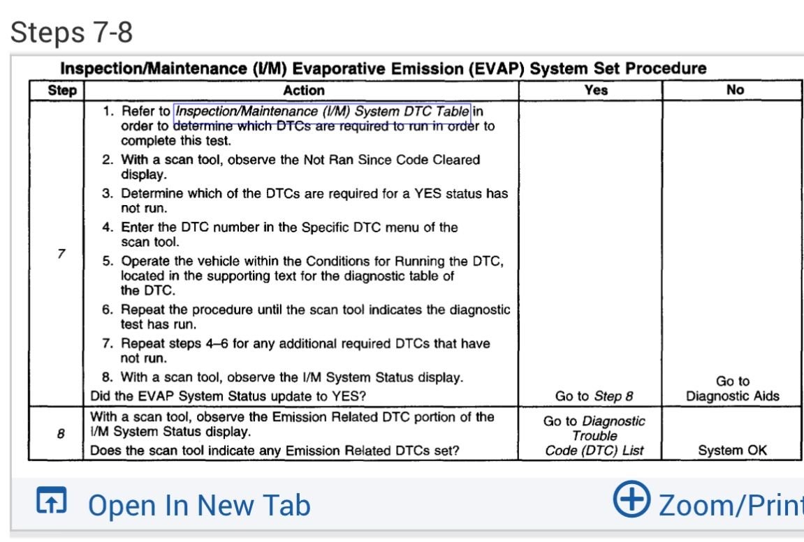

Old Sep 27, 2024 | 07:13 AM
C5 Diag's Avatar
C5 Diag
Moderator, Tech Contributor
Posts: 15,628
Likes: 4,072
From: Cape Coral, Florida
Here are the steps needed to run the test taken from Service Info and must be driven EXACTLY as spelled out !!…start at step 5.

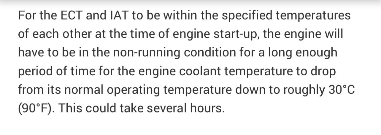

Old Sep 27, 2024 | 07:26 AM
C5 Diag's Avatar
C5 Diag
Posts: 15,628
Likes: 4,072
Step 6 refers to the fuel level…between 3 and 17 gallons and IAT and ECT within a certain temperature of each other…you can check both temp sensors with the key on after the car sits overnight.
