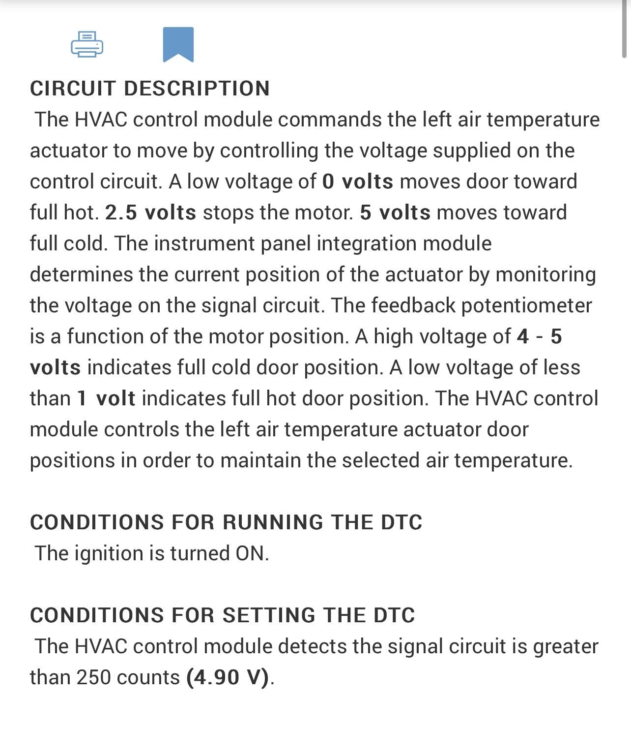

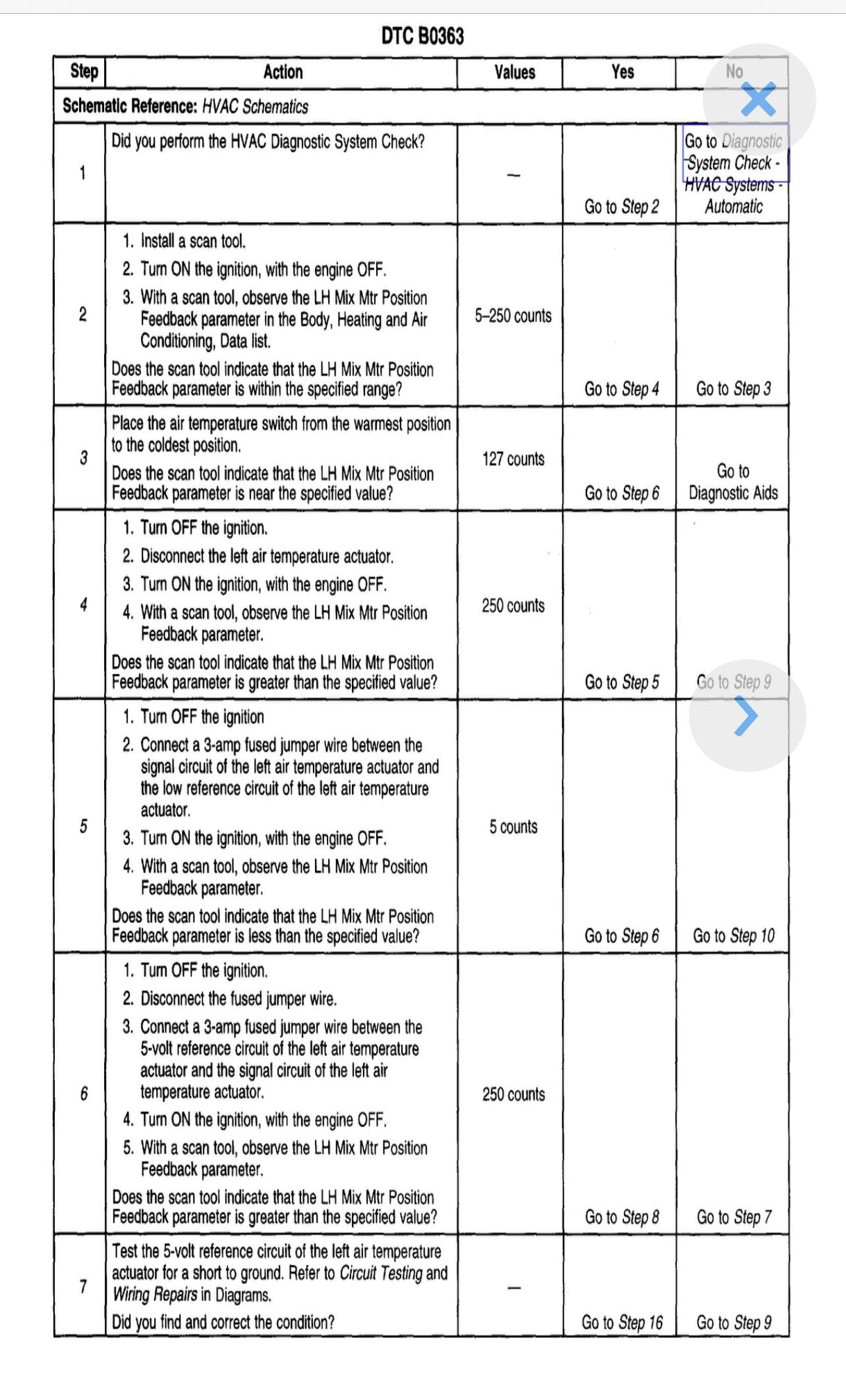

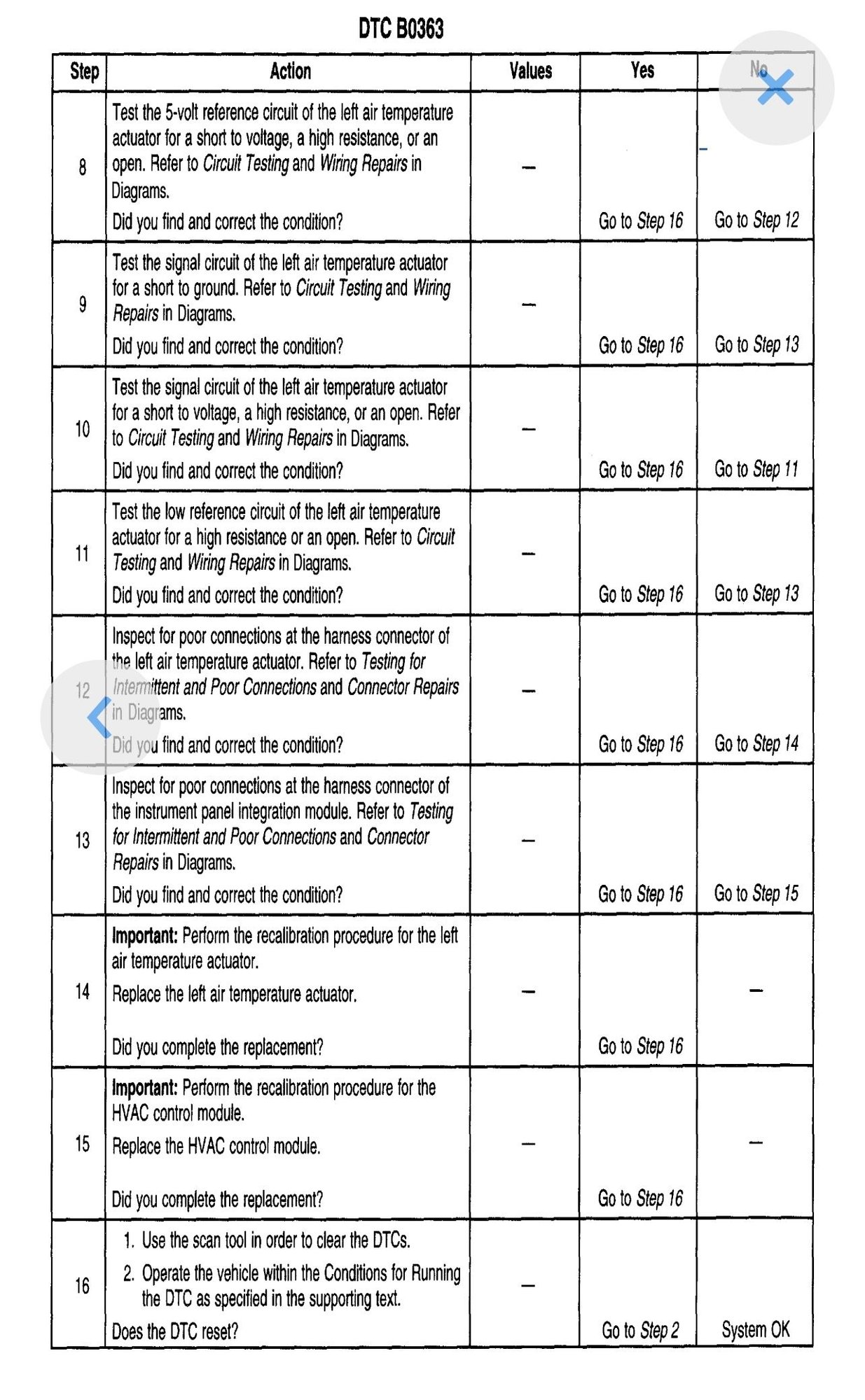

If the only current code is the 0363 so here is the factory flow chart to diagnose it…you will need a factory level scan tool or equivalent…it would be next to impossible to diagnose this for you over the computer…I would seek out professional help.
