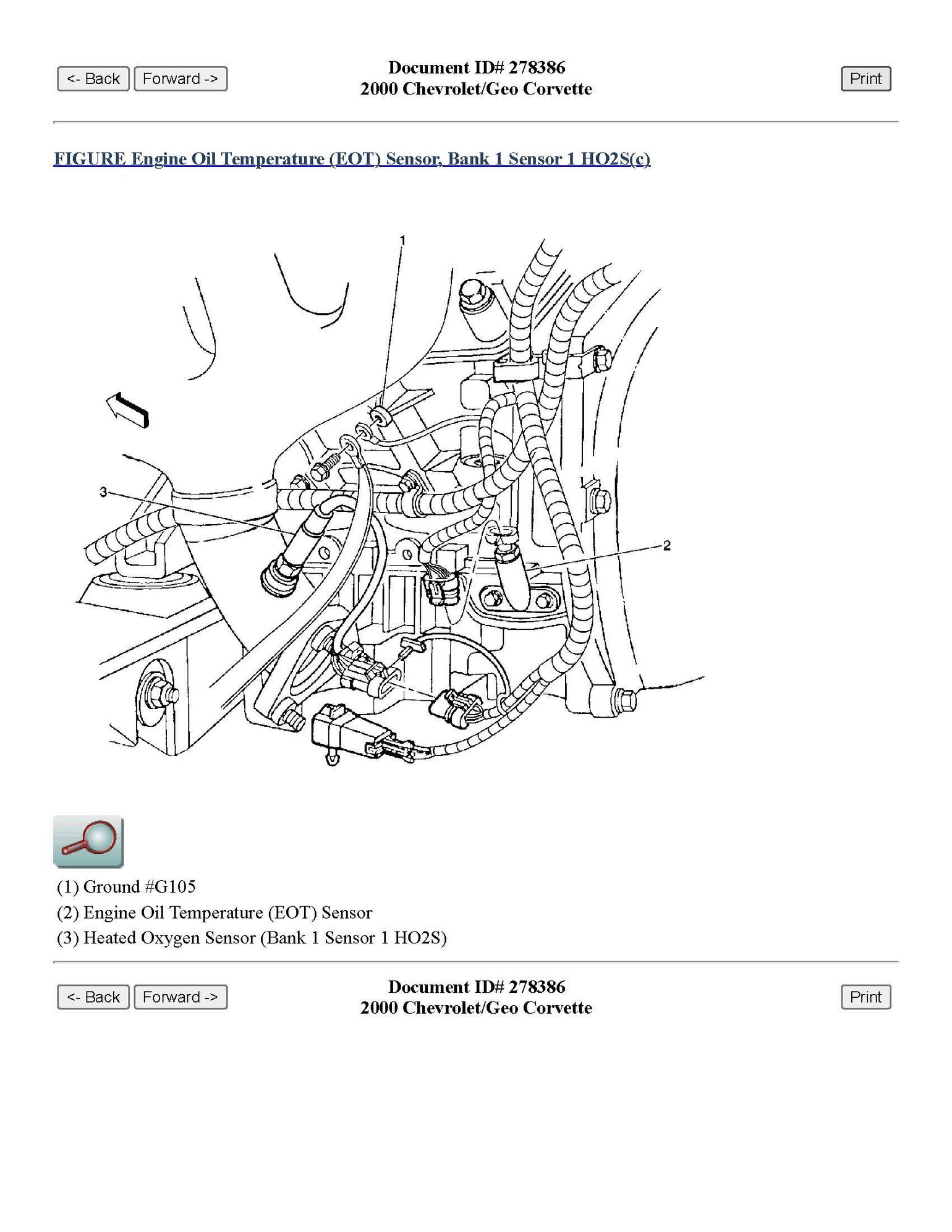

It’s the ground that’s supposed to go down by the motor mount on drivers side. I didn’t post any codes because unfortunately I don’t have any
Old Oct 2, 2024 | 06:32 PM
lucky131969's Avatar
lucky131969
Posts: 19,362
Likes: 1,128
From: Dyer, IN
Seriously, G105? That provides a ground for the fuel pump relay, oil level, 02 sensors.....
