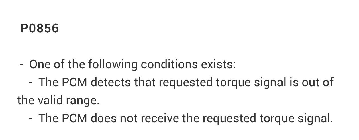

What year is the car ??…P0856 doesn’t look familiar and no “P” or Powertrain DTC’s start with a P2XXX…power train codes are all P1XXC or P0XXX that I’m familiar with…you will need a scan tool at minimum to diagnose this.
Is a 2004, I searched for the code P0856 on google and there are several threads here at corvetteforum about other users having this code.

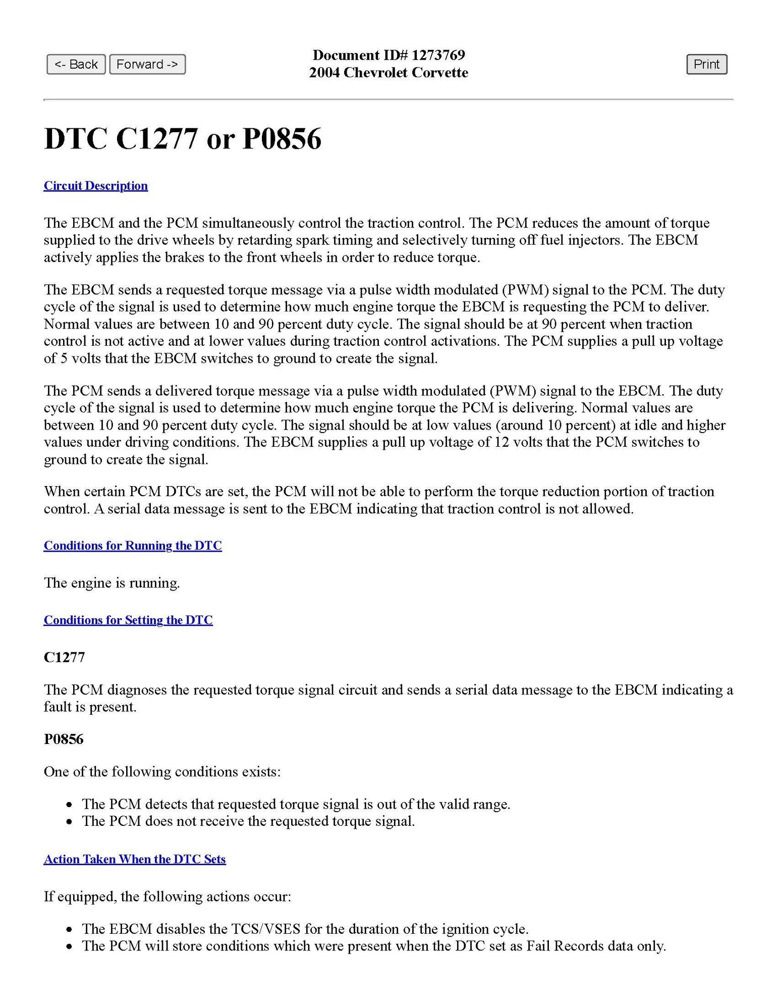

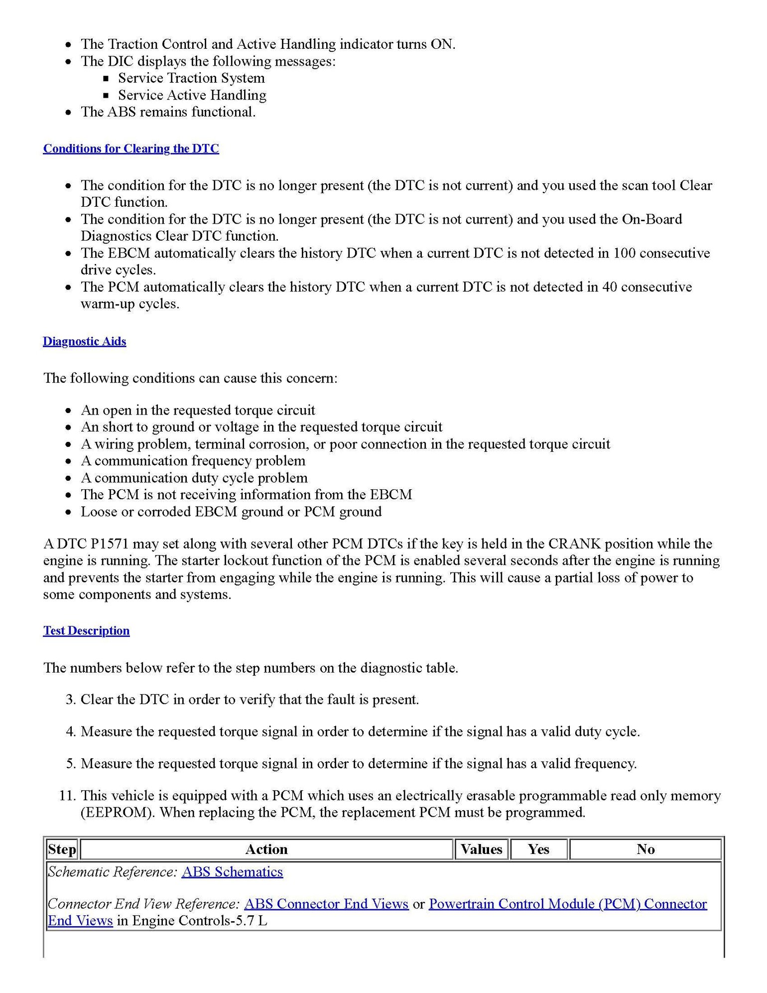

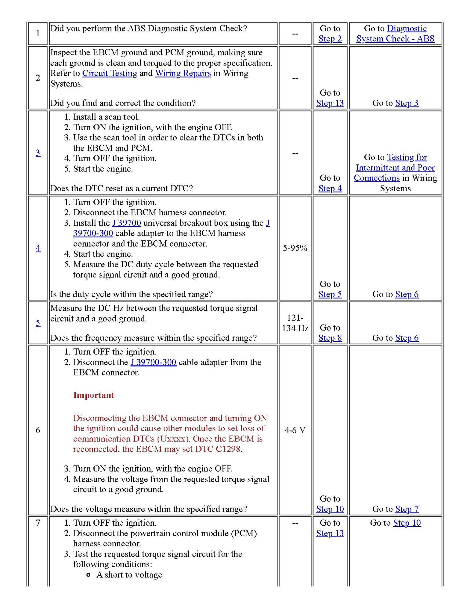

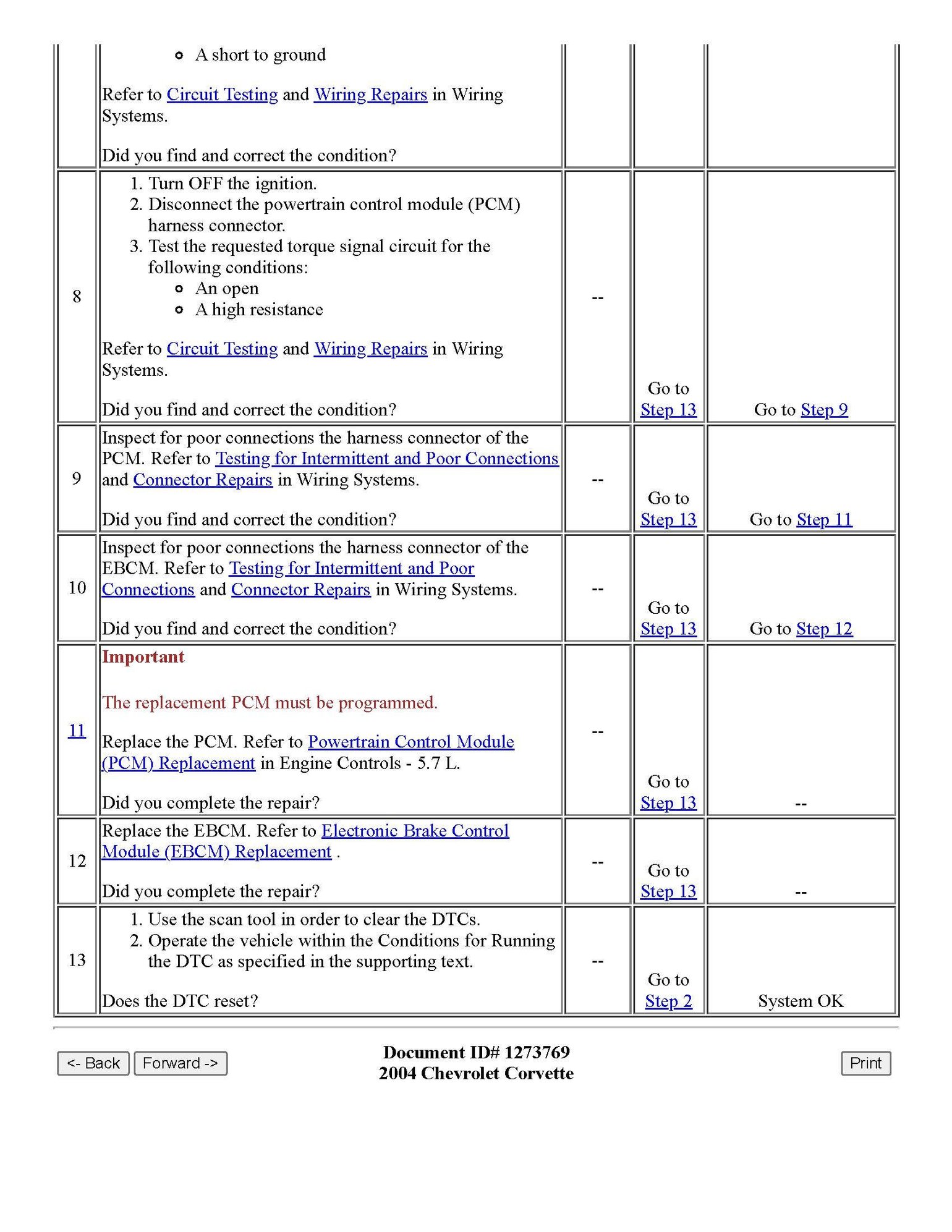

Ok, for an 04 this is the DTC…do you have a factory level or equivalent aftermarket scan tool ??…I’d first erase the code and see if it comes back…if you don’t have scan tool a DVOM with a frequency function will be needed…checking for 5 volts from that circuit which comes from the PCM going to the EBCM can be checked too…when I had my C5 it would throw a similar code (P1644) occasionally but it was generally a nuisance code…under certain conditions that code would cut off some injectors.

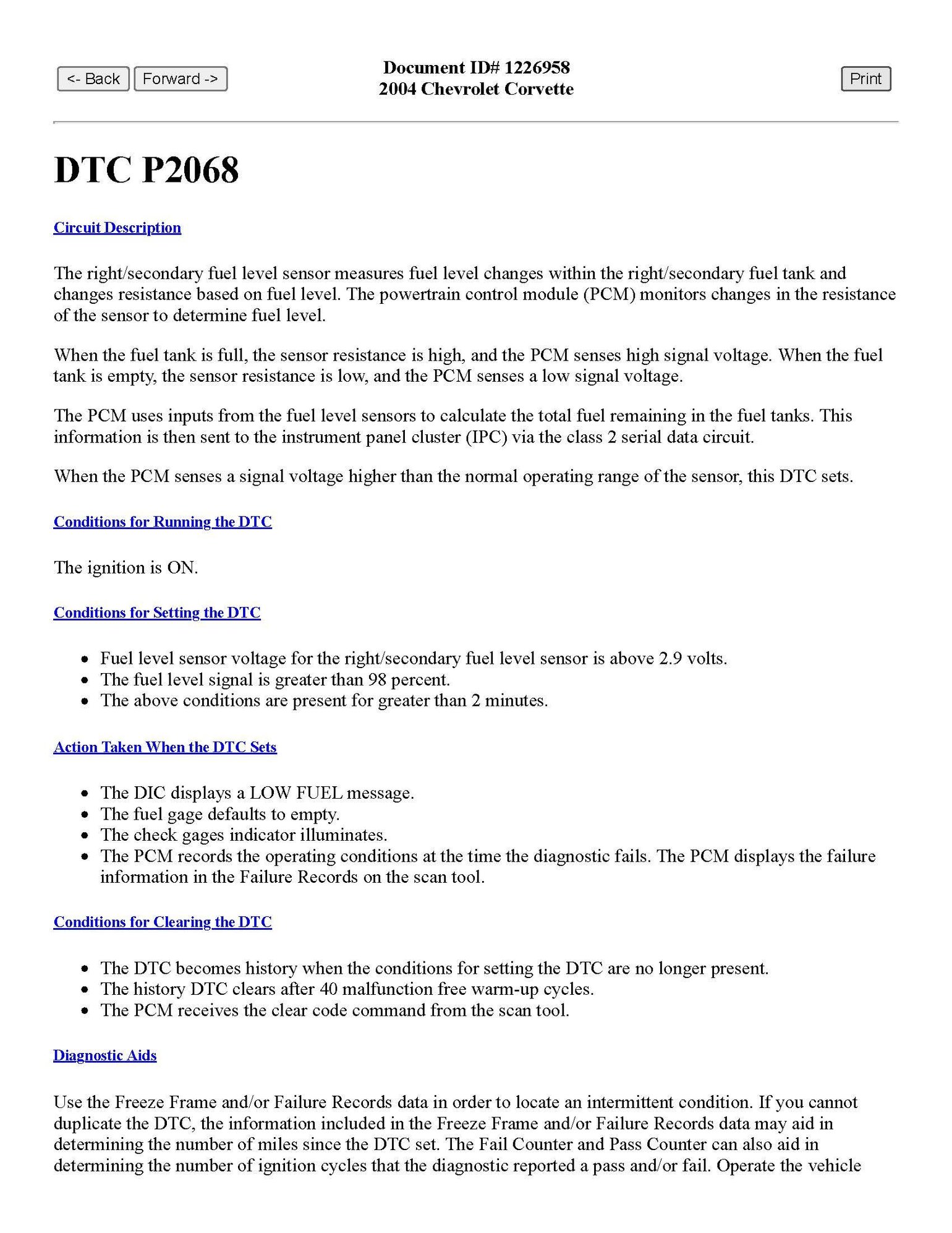

Old Oct 3, 2024 | 12:00 AM
lucky131969's Avatar
lucky131969
Posts: 19,470
Likes: 1,170
From: Dyer, IN
Thank you for your answer, I have no experience checking this kind of fails on cars but I do have a multimeter that test for frequency and duty cycle, I'll try to check this first.
Tom

Thank you lucky131969, on those check routines mention a lot of tools that I don't have, i'll try on the connectors with the multimeter.
Tom

Hello again guys, I want to test for Hz, duty cycle and voltage at the EBCM connector, but I can't find a way to remove it, I raised the gray handle and pulled and wiggled the connector but it does not come loose, any recommendations?
Thanks!
