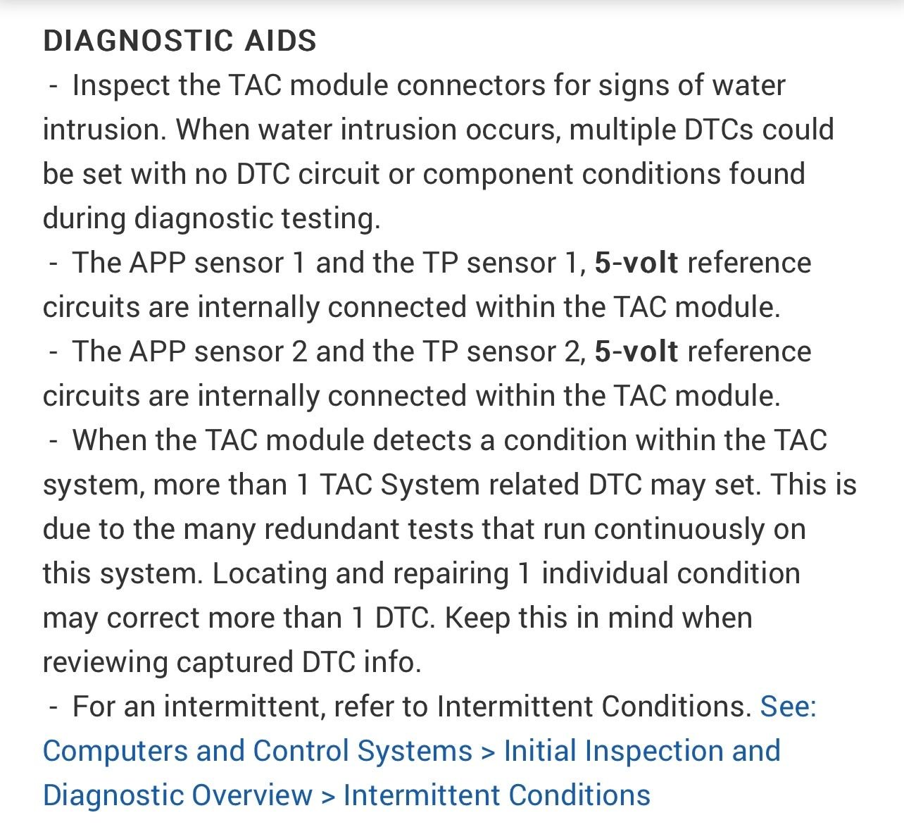

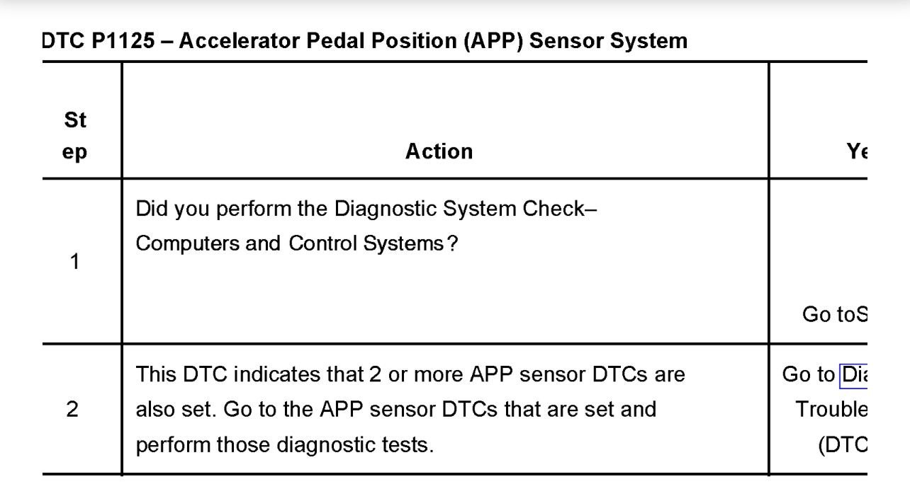

Hey everyone, I’ve got an 01 and it’s pulled this code P1125 for accelerator pedal position system. Puts the car in limp mode. I have gotten this code 2x before now and both times I replaced the gas pedal and it was good for a few months and went bad again. Any idea if it could be an underlying issue? Just trying to figure it out before I buy another gas pedal and it stops working.
