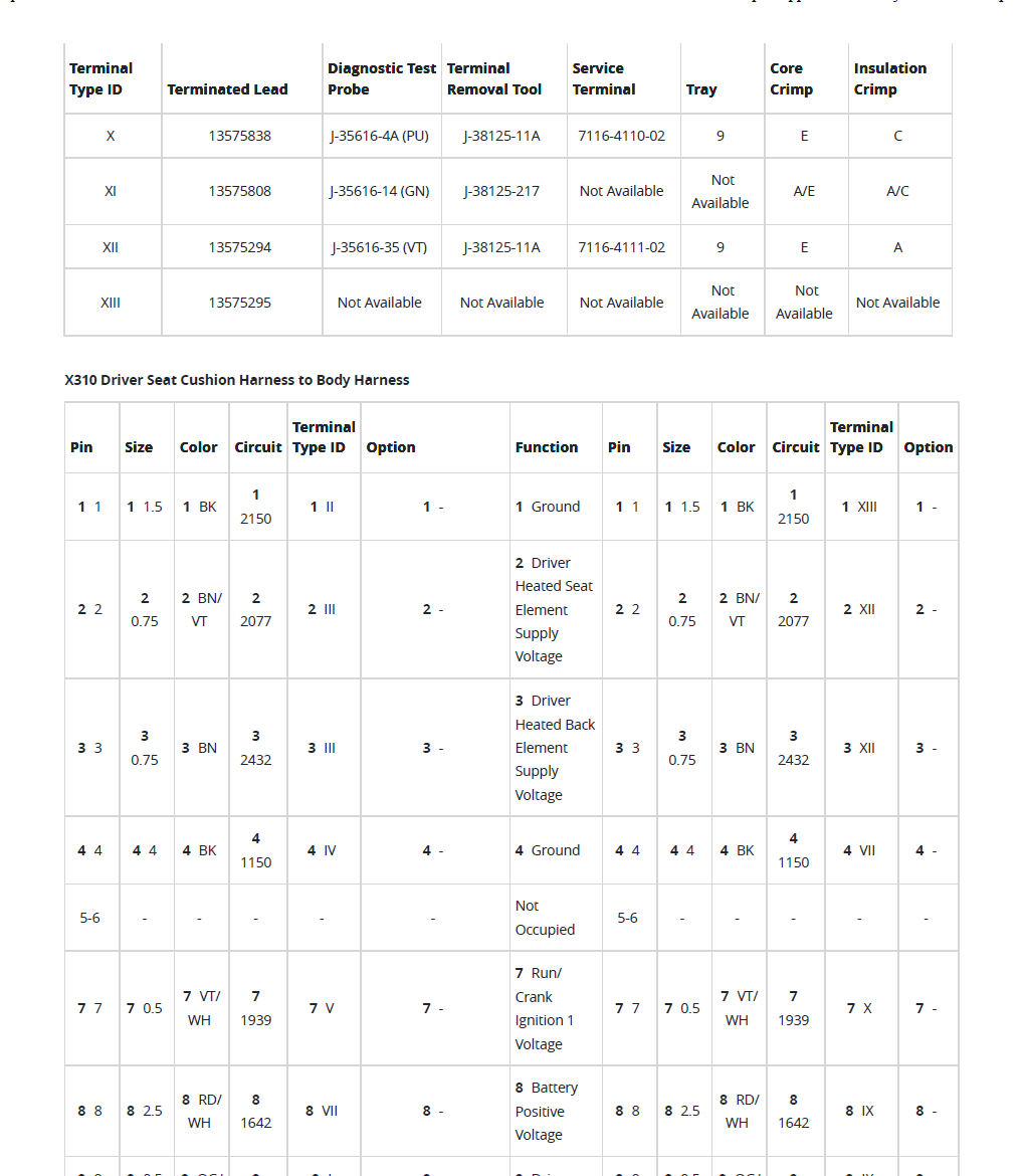

Having read a number of conversion threads, I am posting because I did not yet see the full answer as to how to enable both Ventilation (a great option in the summer!) and Heat.
I do not have to worry about a telescopic wheel so that is one headache skipped.
Wiring for basic power and ground is no worry.
What are the pinouts for Heat & Vent?
Do they require a canbus controller?
If so, what's the trick for that?
Or can I not wire them up directly to a switch?
Can they retain the 3 setting stages or would they be all or nothing?

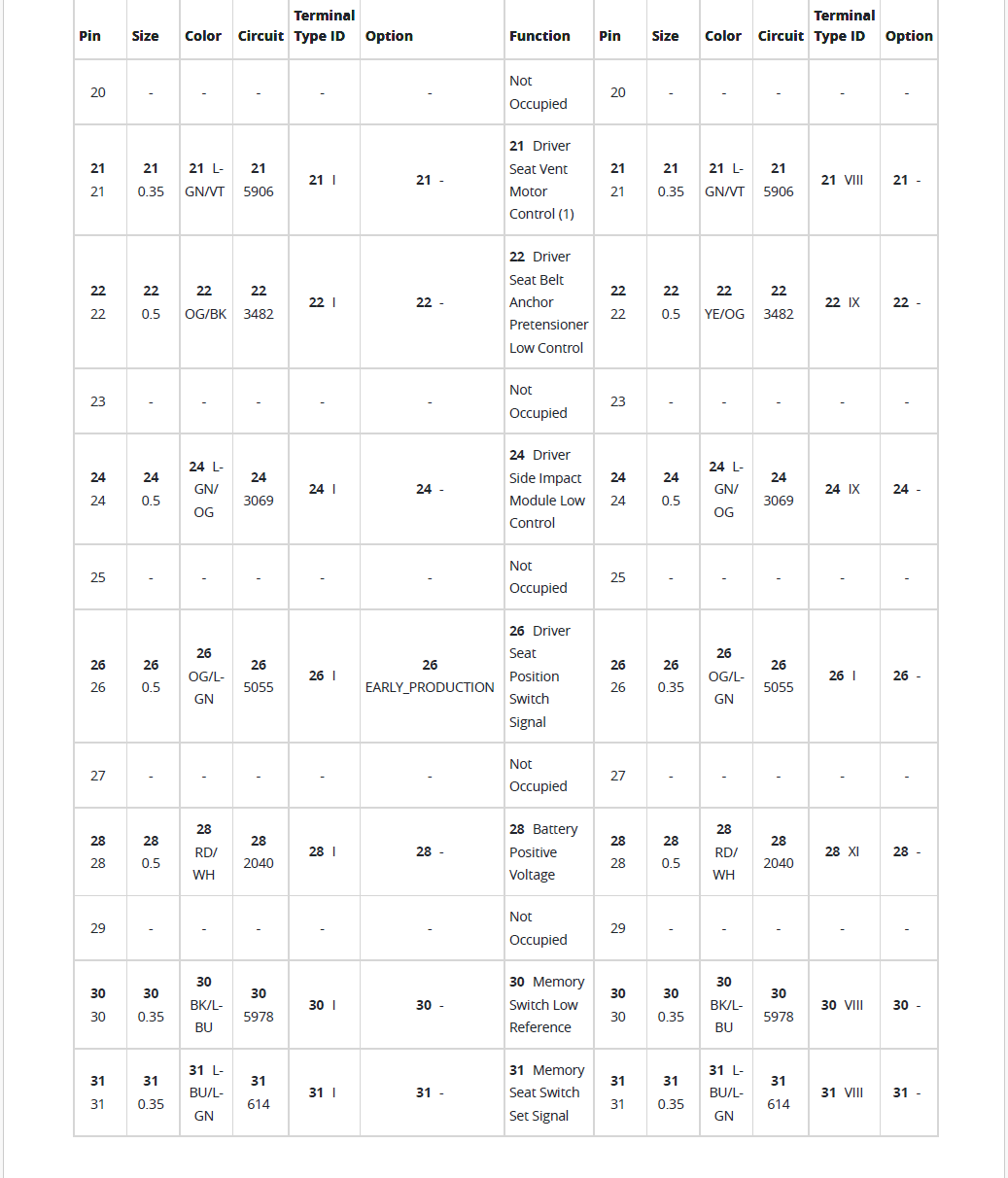

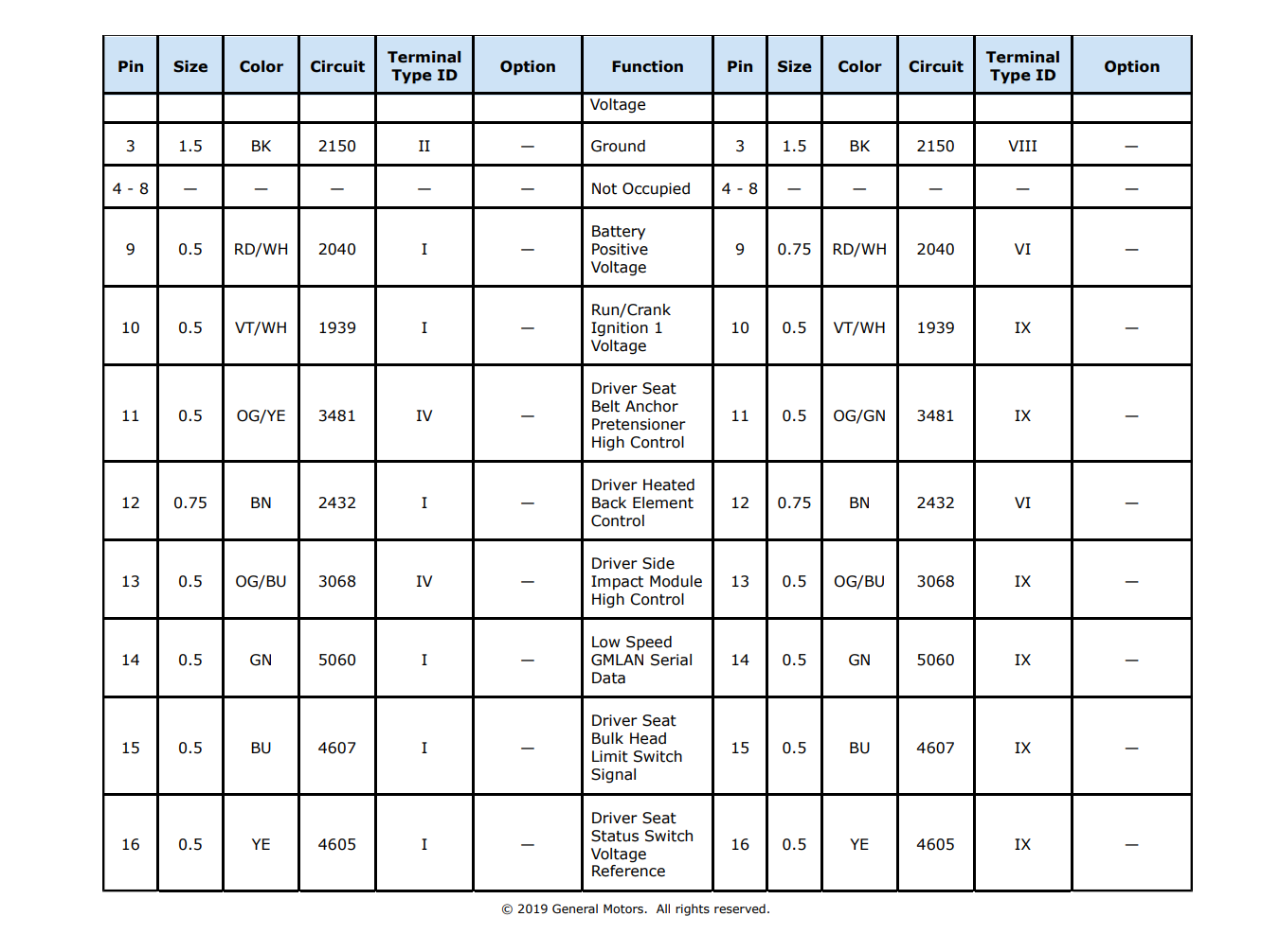

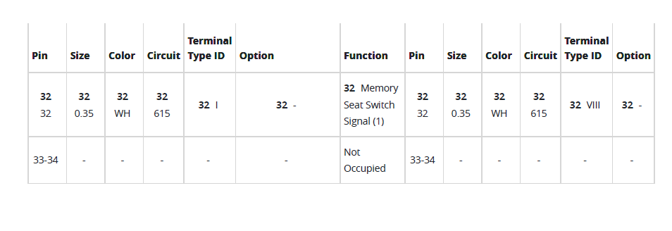

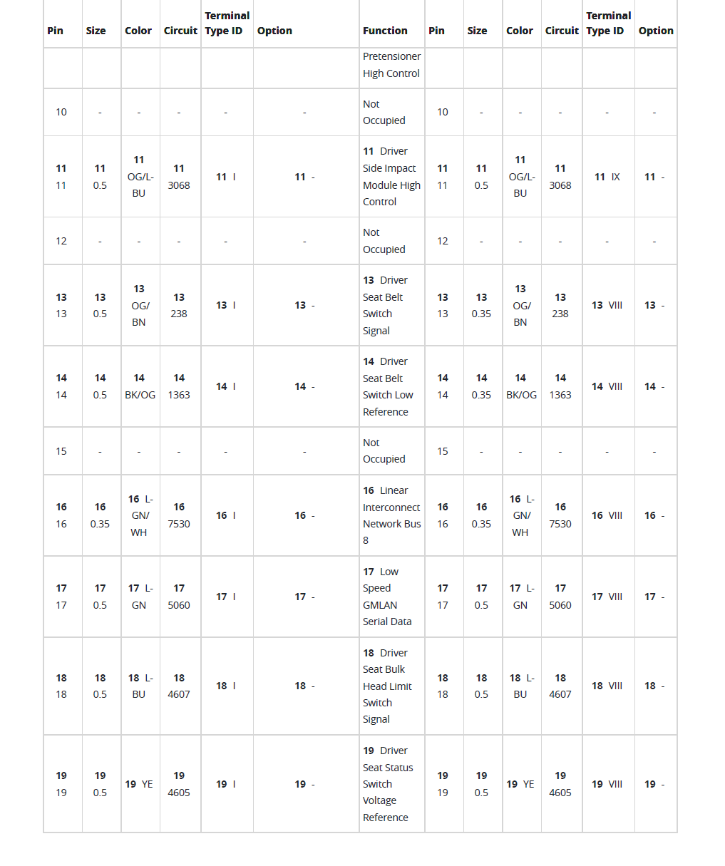

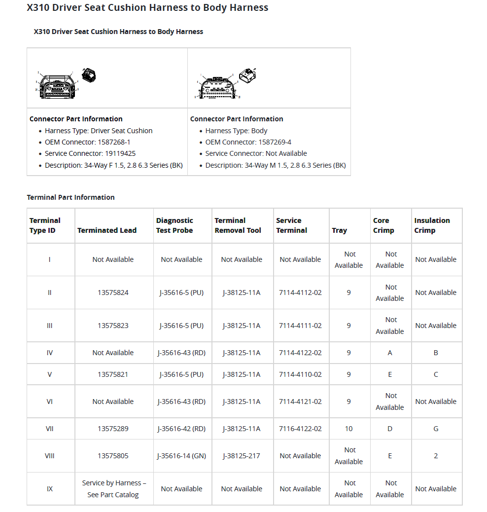

Here is 2018-2019 Pinout
2014-2017 Seat Pinout

Much appreciated. We can put this to good use!

One thing to note with those diagrams:
The displayed connector is only for 2018s and 2019s.
Older C7 seats have a different connector.

These are the older set. 15-16.

Bottom half of the post is for 14-17 seats
