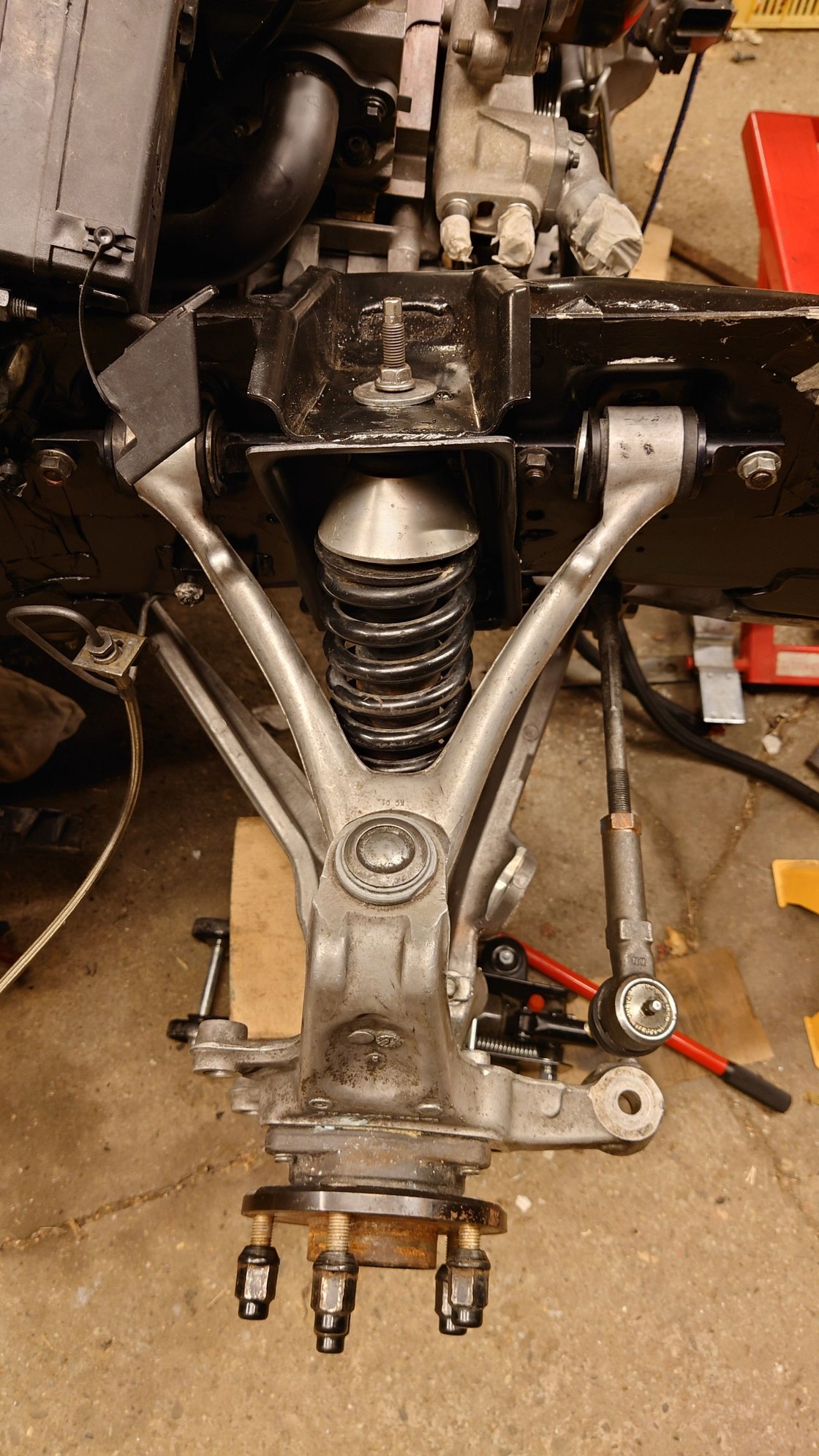

I am re-installing the front suspension after repairing the engine and painting the frame in the engine bay area. I know that when I disassembled the car there were washers on the top four bolts, but because my cell phone broke and I lost all the photos I took while disassembling the car, now I can't see how many washers there were on each bolt. Can someone please advise me how many washers(see attach pls.) should be there?
thanks

That is an alignment shim which will vary from car to car. Bolt it together, torque to the recommended value, and then perform an alignment.
