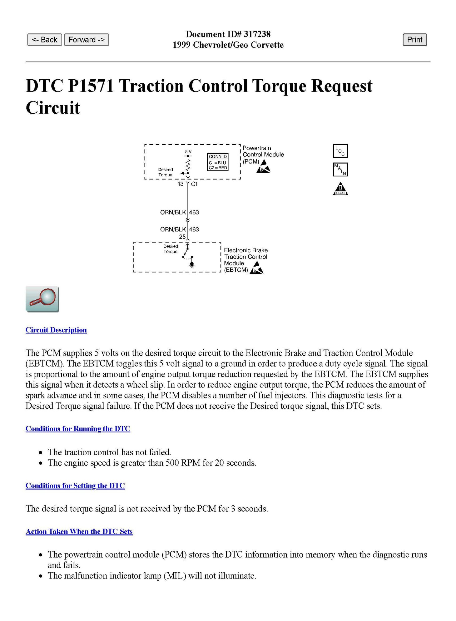

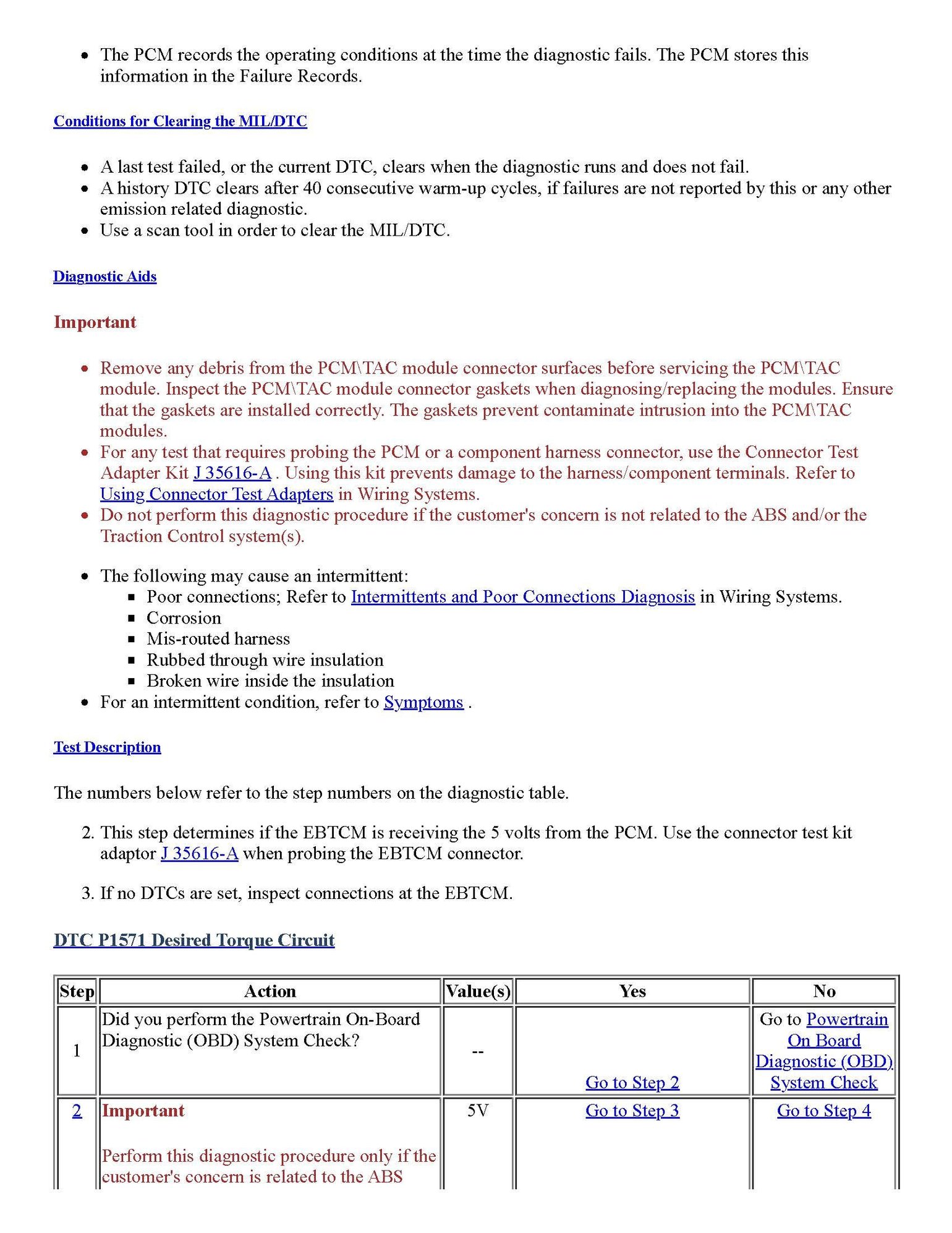

Sorry I should have clarified, the 1416 is there the whole time. The 1571 went away and came back. I will check the ground when I get off work. When you say check the ground on 25 you do mean to put the DMM in ohms and to test the wire like I was testing for voltage? I believe I did that yesterday and was getting 0 ohms.

That doesn't make sense. If you get a check engine light after driving for a short time.....pull over and park with the engine running..... and you check codes on the DIC which shows a P1416....and you clear the code, it is gone until the next ignition cycle.
Exactly. Before you were checking for voltage at position 25 with the ignition on. Now you will be checking ground at position 25 with the ignition off.
If you really have 0 ohms at position 25, you have found your problem.

That would be a direct short to ground, which means the wire for that circuit has found a path to ground somewhere between the EBTCM connector and the PCM.

I just tested 25 in ohms and it was jumping everywhere. I saw it go as high as 89 and down to zero. It showed continuity. So that means it's definitely short to ground? I'll try to follow the wire as much as I can until the wheels are off.

To be clear, you have the EBTCM connector disconnected from the EBTCM, and ignition is off. When you probe position 25 (connector is held stationary), referenced to a KNOWN good ground, the measured resistance fluctates between 0 and 89 ohms? If that is the case, I really question the meter, leads, and/or ground choice.

You really have to know your test setup is solid. I suggest doing that first.

Ok I got a new multimeter and am getting 5 v at 25 with car on and 3.61 ohms with it off.

Ok, well good....that was a wild goose chase.
...and when pulling codes from the DIC, you do not have any other codes related to ABS/TCS/BCM?

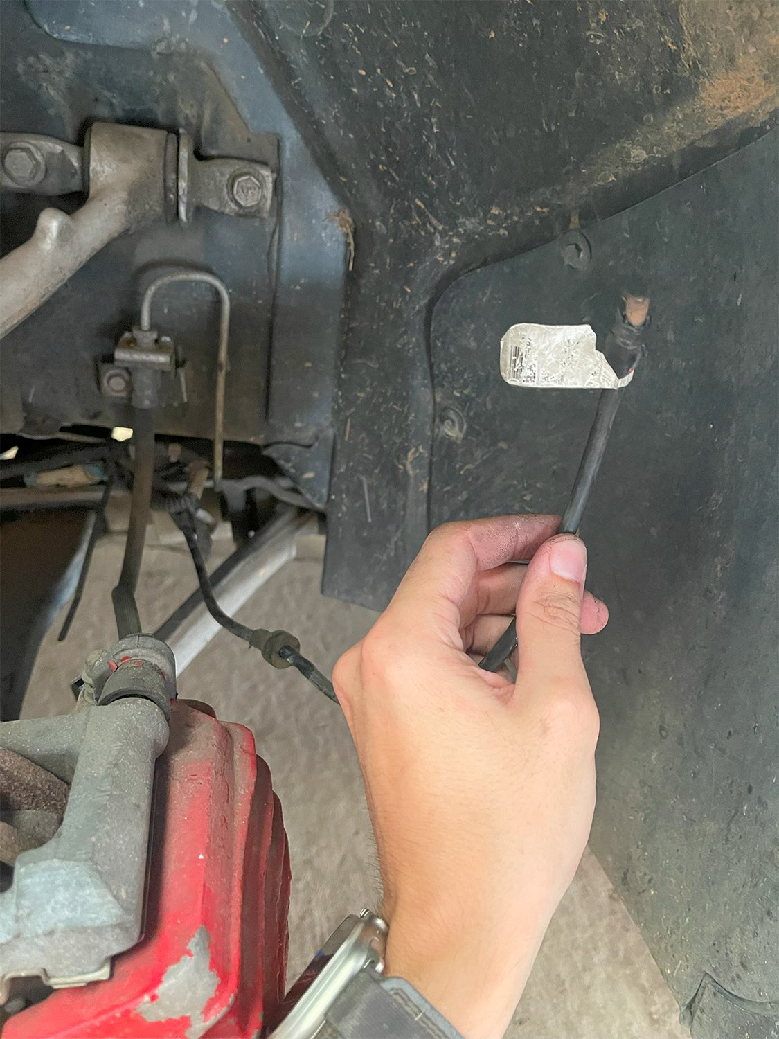

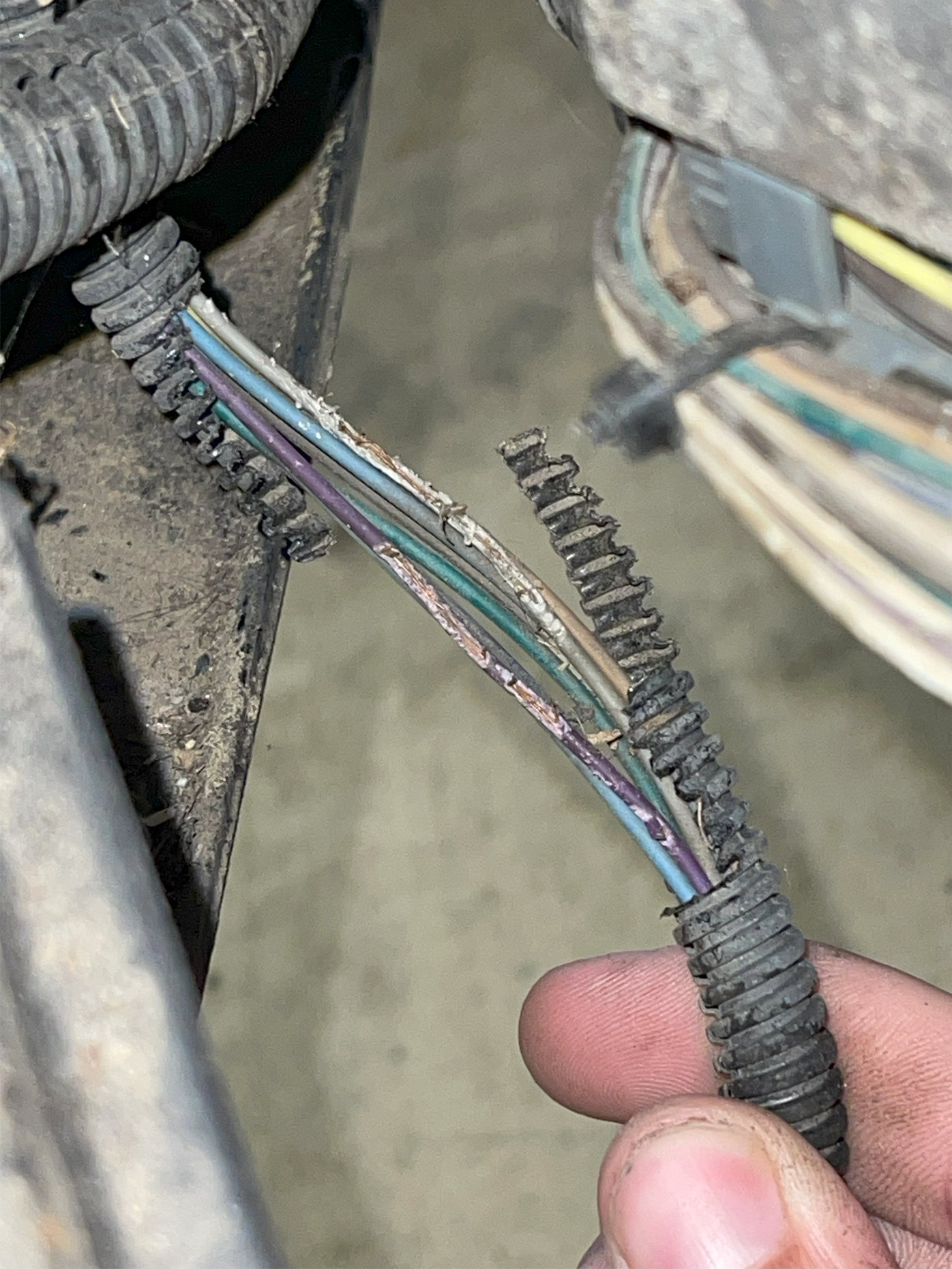

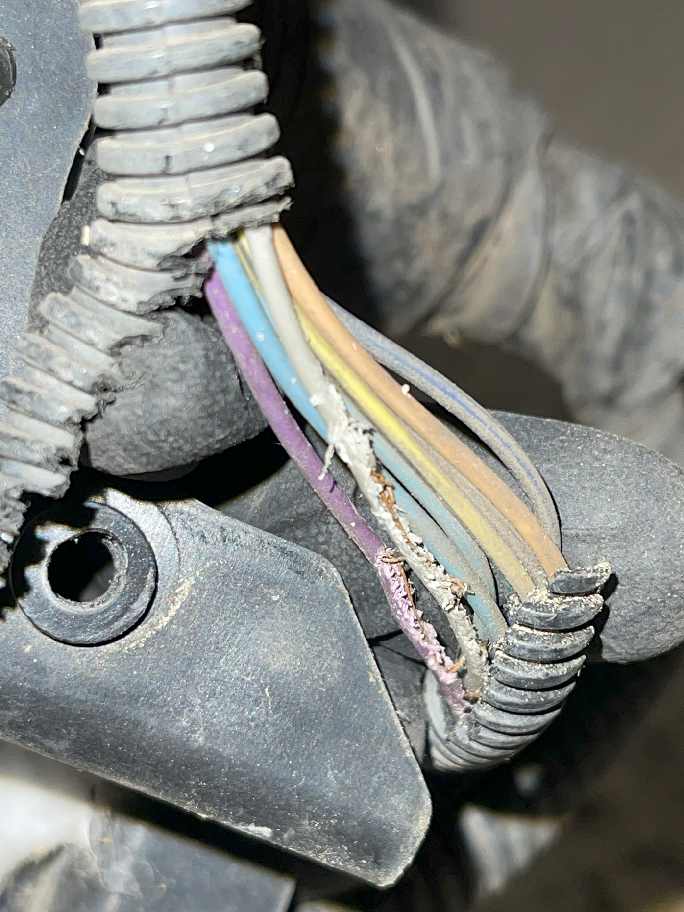

Think I found the whole story. Got the wheel off and took the pcm out. These were chewed going into the plugs on the bracket holding the pcm in place (which I now have to buy a new one for since 25 year old plastic is so brittle).
I started the car before the wheels came off because I put the ebcm and everything all back in and the only code I was getting this morning for the 10-pcm was the 1571.
