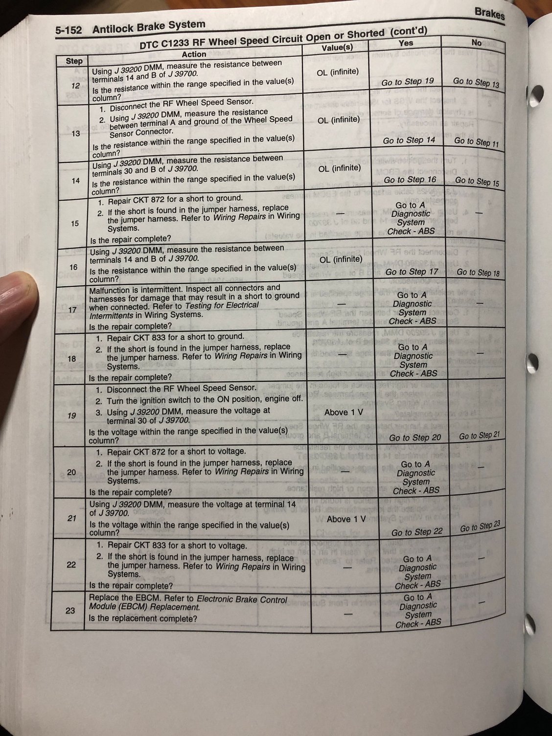

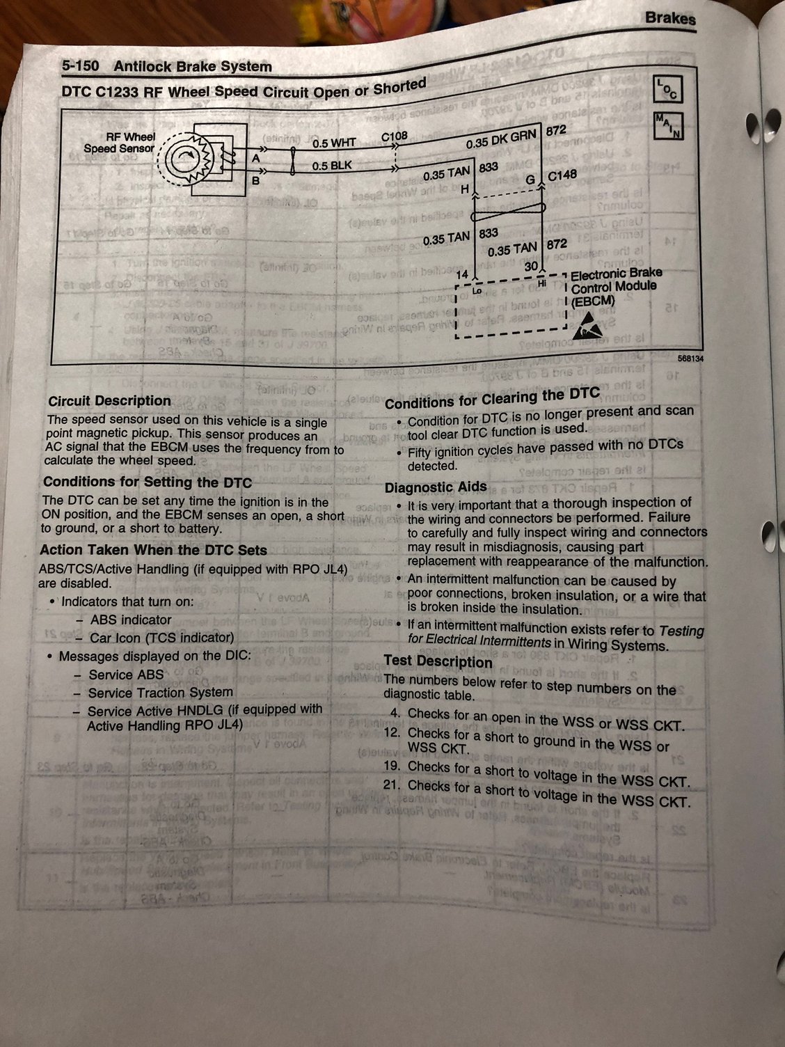

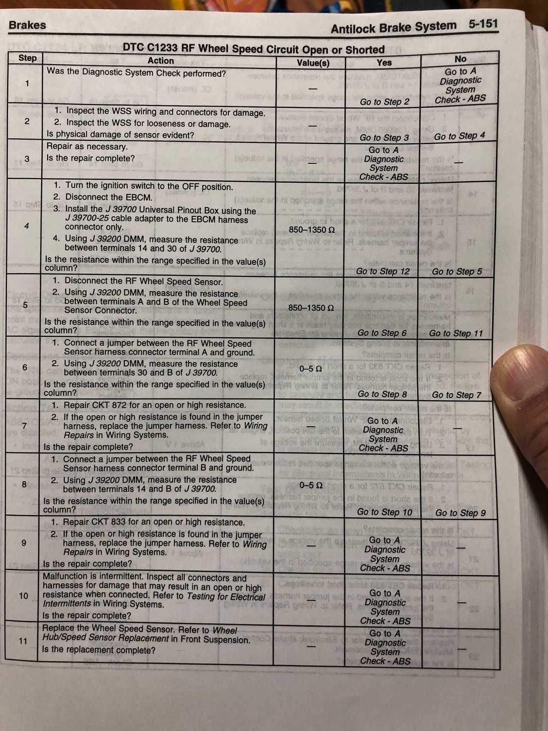

These pages are from a 2000 service manual. Your procedures may be different.
1
