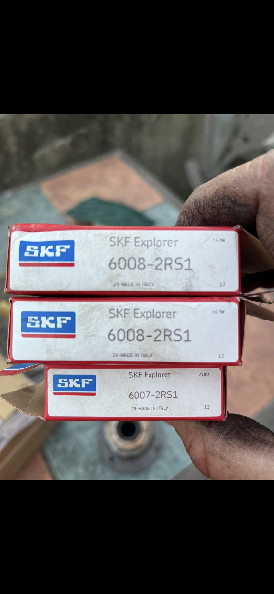

Something I forgot to add, mark everything before you take it apart because they are balanced. Picture shows bearings for a 2000 Manual transmission torque tube, snap ring style, with 10mm bolts for couplers. If you have a bolt style then you would need 1 6010-2rs1 and 1 6008-2rs1 instead. The snap ring style is the later style. The bolt one is the earlier style. Yes they did split them mid year at some point.

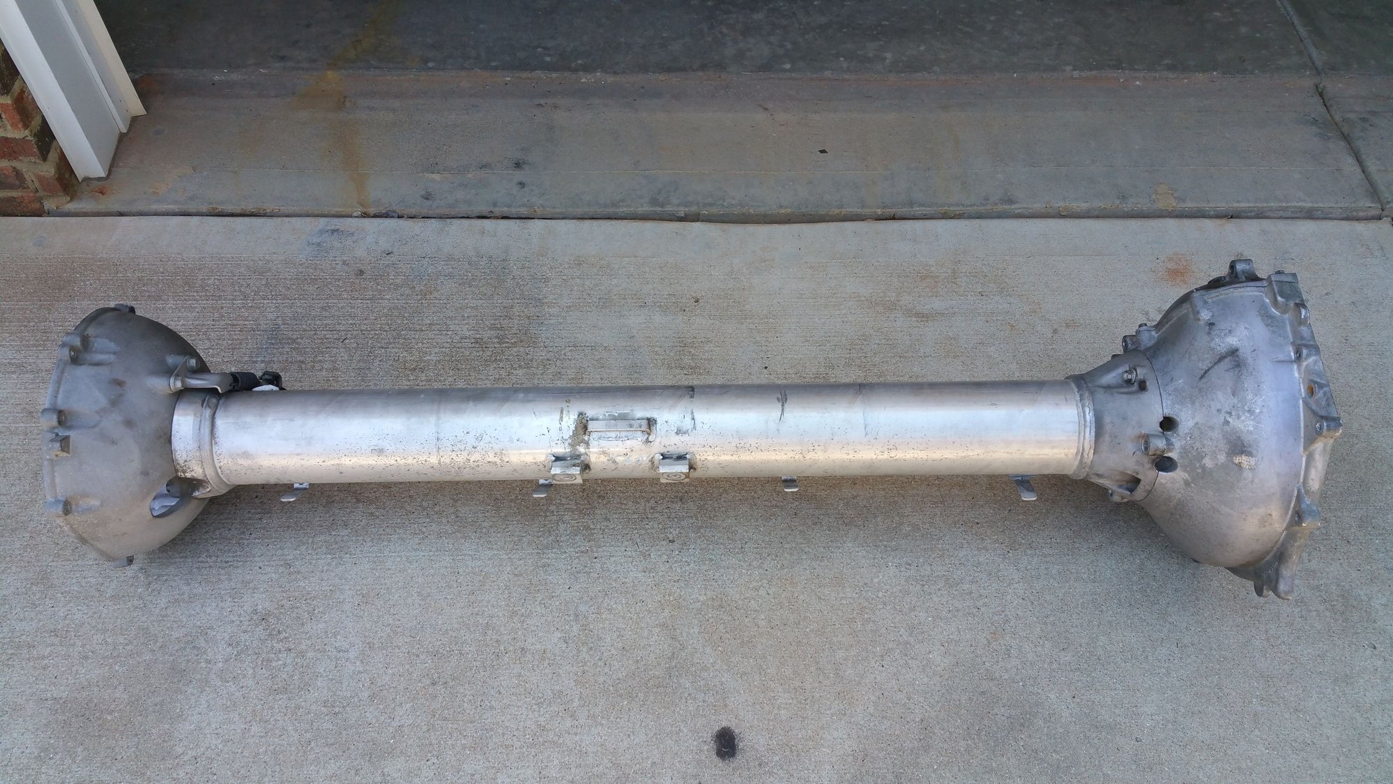

I forgot to add to my reply. If your bellhousing the connects to your trans is welded on to the torque tube then you have the snap ring style. This does not guarantee having 12mm bolts though. If your rear bellhousing bolts to the torque tube you have the bolt style.
This pic is bolt style.
This pic is snap ring style.

CFight,
For those two pics - The picture that shows the complete torque tube, the end that connects to the transmission is on the left. The picture that shows only one end, that is the end that connects to the transmission. Those pics are ones I found on google and put up here as a reference. The torque tube for all styles is going to unbolt from your clutch end.
