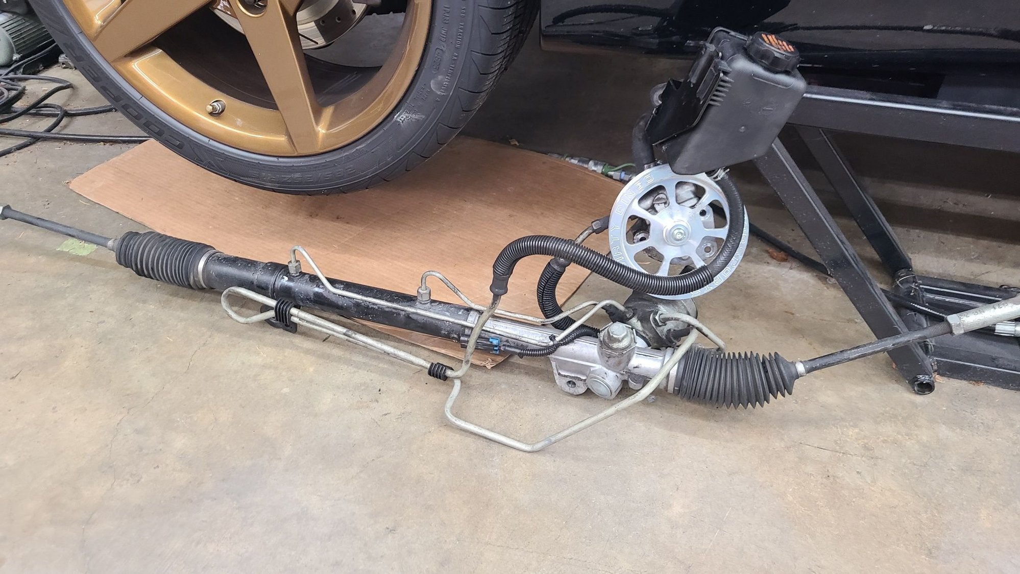

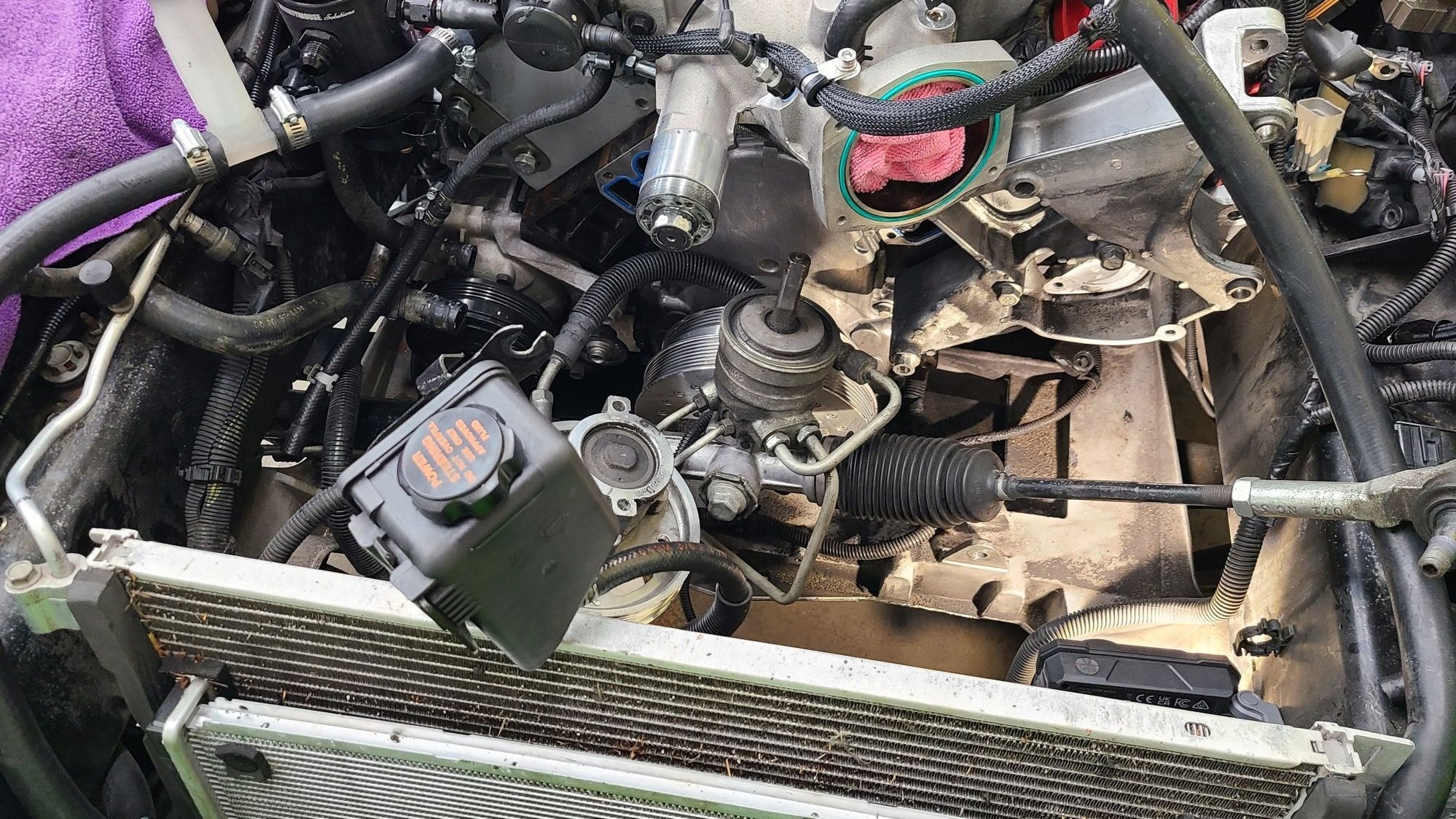

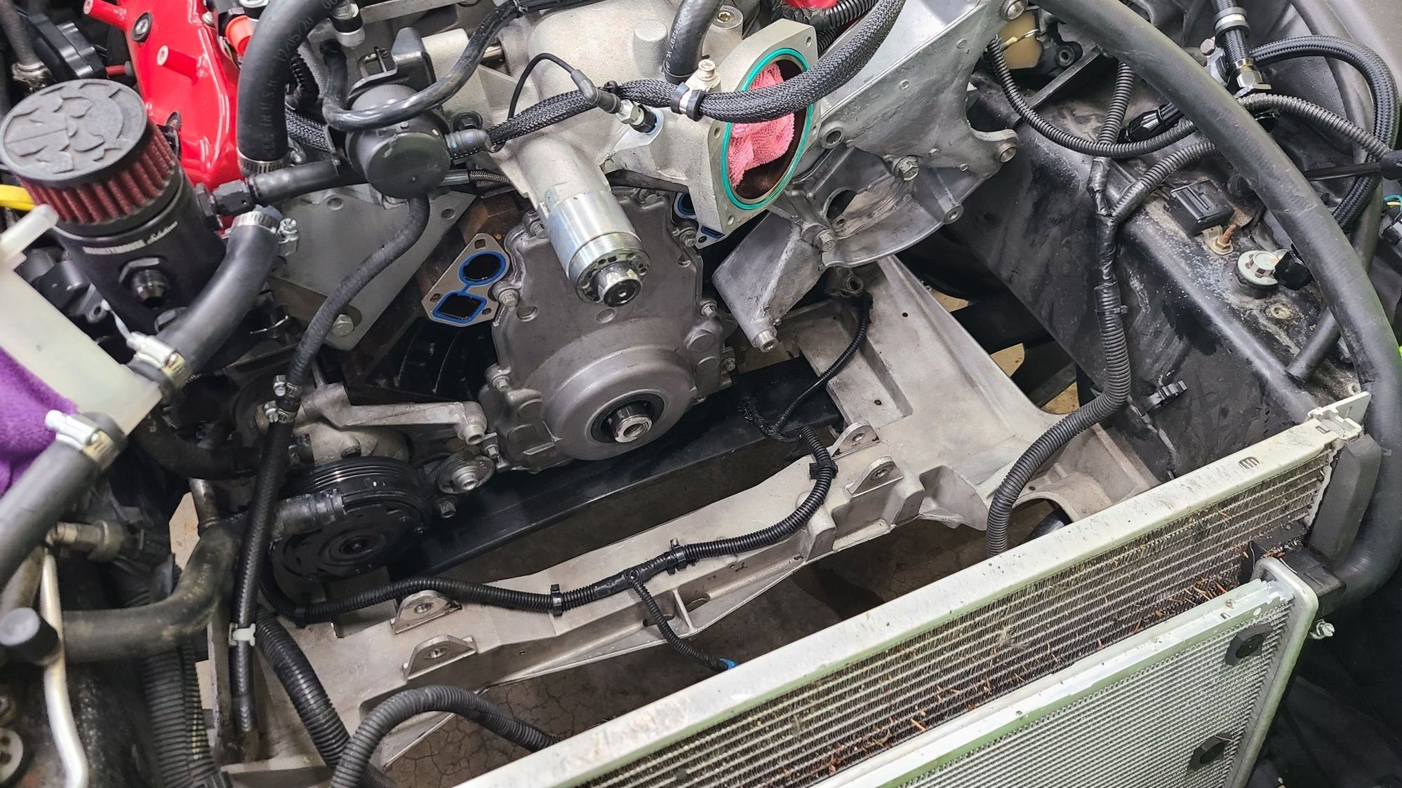

Since you have an early car like I do, it is ridiculously easy to get the whole entire rack and pump assembly out in one piece since there is no EBCM in the way.
If you are gonna have the water pump out anyways I would consider yanking the radiator out as well which is literally just 4 more 10mm bolts giving you wide open room to work.
I personally would not mess with jacking the motor up or dropping the cradle in this instance (I've done both for various reasons in the past).

I've done it both ways. Removing the lines and removing the rack, pump, lines, and reservoir in one complete unit. When I removed the whole unit the radiator was out though.
Taking the lines off and removing the rack itself is super easy, it's just messy.
