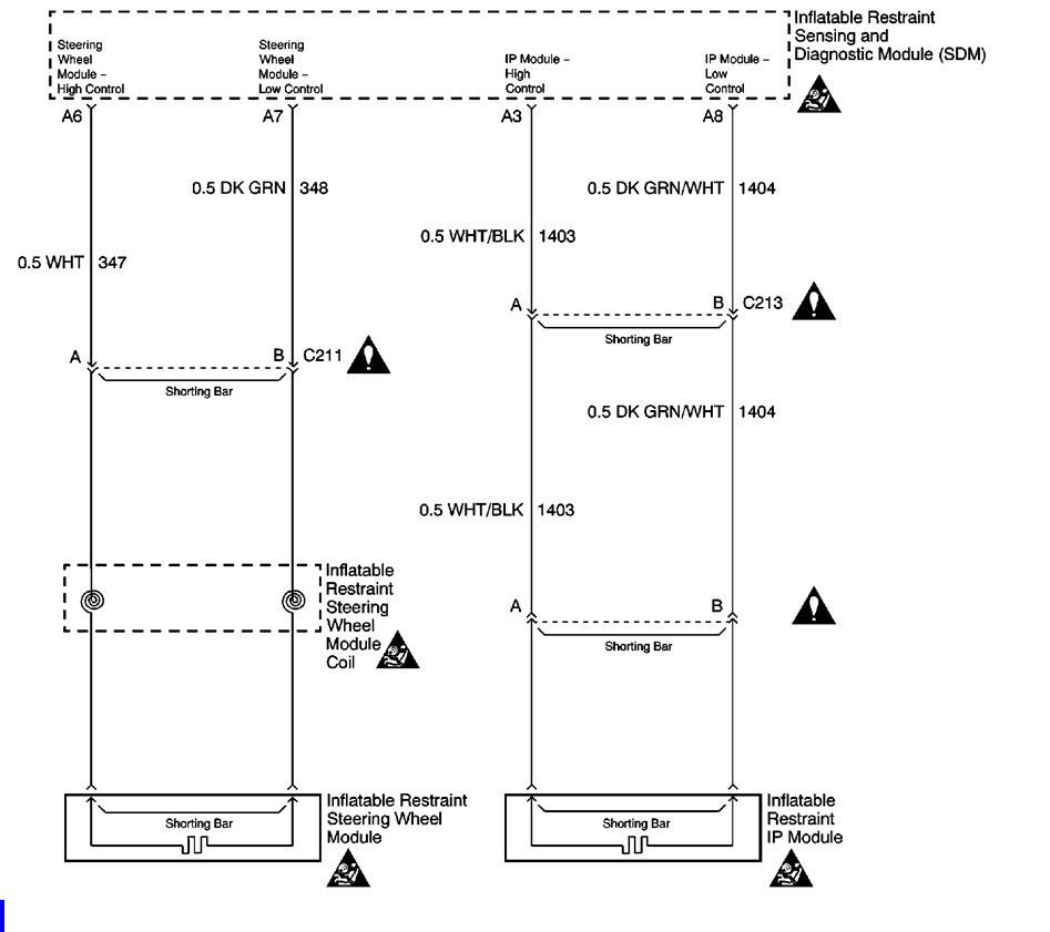

Purchased a 2002 C5 Coupe this summer and have had a blast driving and working on it. Looking forward to learning more about the car and how to do upgrades and address codes. I’ve completed several projects on the car and if I can help others I’m glad to do so. Some of the projects completed this summer included belt replacements, head liner repair, head light gear assembly replacement, air filter change, oil and oil filter change, vacuum hose replacement, paint correction and ceramic coating; break fluid bleeding, visor replacements, and steering wheel position sensor replacement. After replacing the steering wheel position sensor I’m getting a B0026 error code and the air bag light is on. Any advice is welcomed!

Your steeringwheel coil wires are probably broken .If you measure the wires it could be verified before replacement
