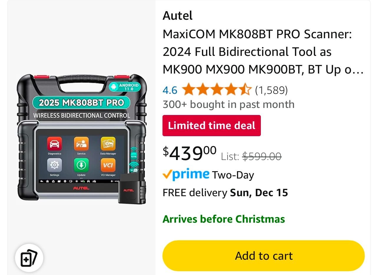

Why you wasting your money on HP Tuners ???…will you be doing any tuning ???…it is not really a tool that can read DTC’s from ALL the cars modules…to diagnose effectively you need to look at inputs and outputs from those modules and have bidirectional capability…save your money and get this cheaper Autel…BTW, I’d be looking at your ECT sensor…you can also look at TPS%…data PID should be less than 10%…if over 10% the TB may be dirty.

I will be doing tuning. I would like to get headers and an intake in the spring when its warmer to install them in the driveway. Preferably would like to tune with HP tuners but if it cannot help me with all module diagnoses then I may be adding something like the above as well. Thanks for the info. I will try to check the data you mentioned.
