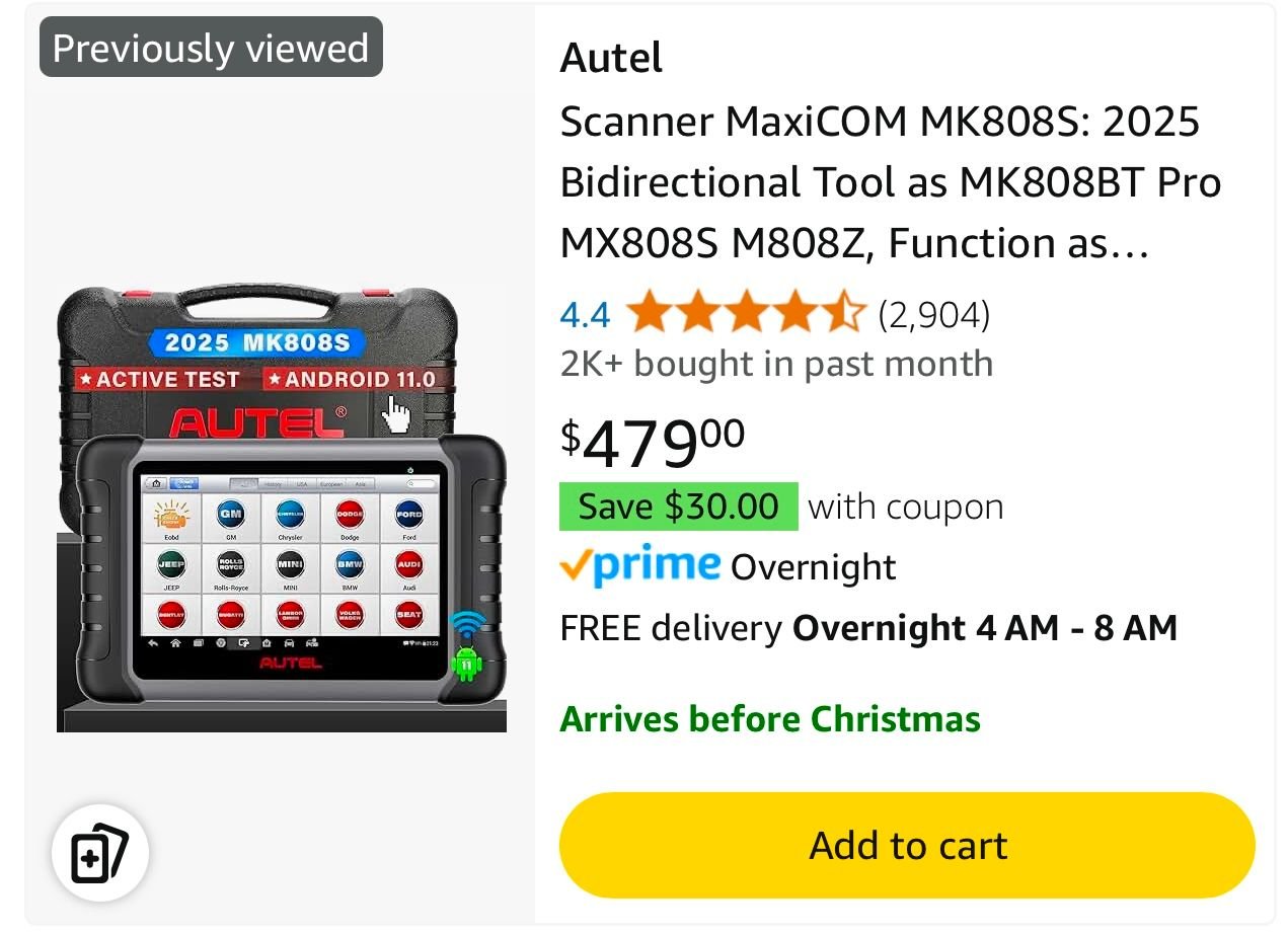

Any aftermarket scan tool like this scanner by Autel which is fully bidirectional can exercise the ABS pump and is capable with working on domestic and foreign cars….you’re not stuck with just with GM or Saab.

Any tool? I see that that has bidirectional capabilities, but it doesn't really expand much beyond that. I recently used a scan tool with bidirectional capabilities that wouldn't do a crank relearn but would do a bunch of other stuff that wasn't really helpful in my situation.

Conversely that Autel doesn't specify any ABS functions.
https://www.autel.com/mk2/3990.jhtml
After downloading the user manual that GUI on the Autel looks an awful lot like the Foxwell. . .

OP wants to be able to turn the ABS pump on and off and that is an output control…”special functions” however such as crank relearn etc vary from scan tool to scan tool.

Using the Autel as an example can you find output control or anything that would tell a guy it can cycle the ABS pump?
