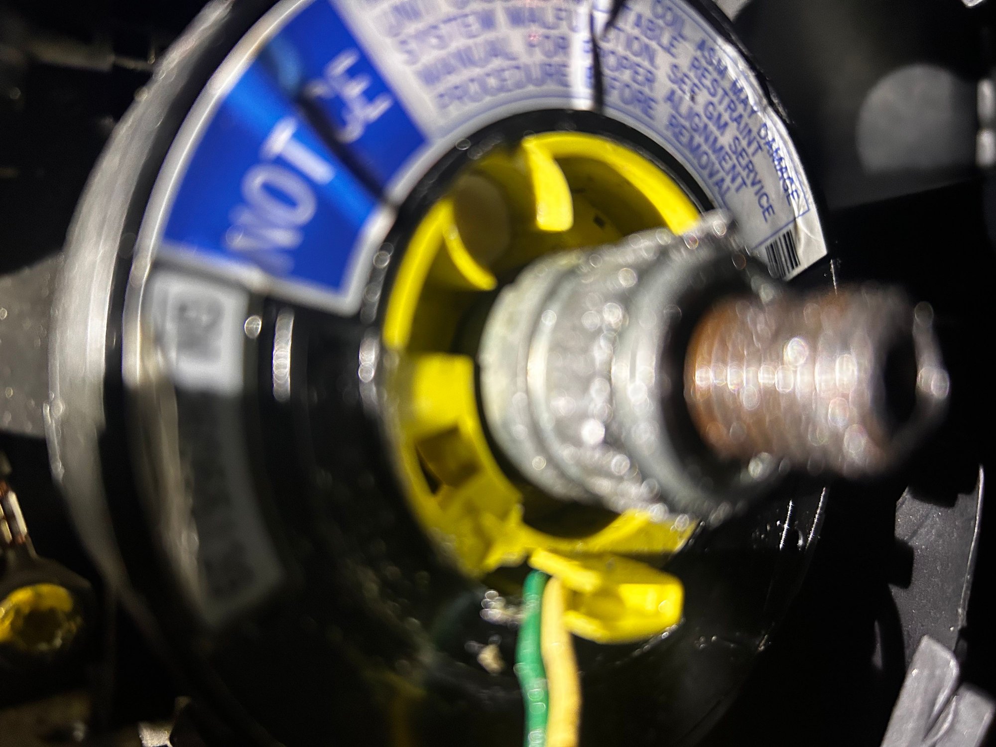

I’m having problems finally got old wheel off , what’s left of it anyway. Now there is this thing in the way the new wheel won’t slide over the shaft , should I cut that thing off?

yes, you need to remove the old splined hub from the shaft

pic is blurry...it looks like part of your old steering wheel is still stuck to the shaft
good luck getting that part off
