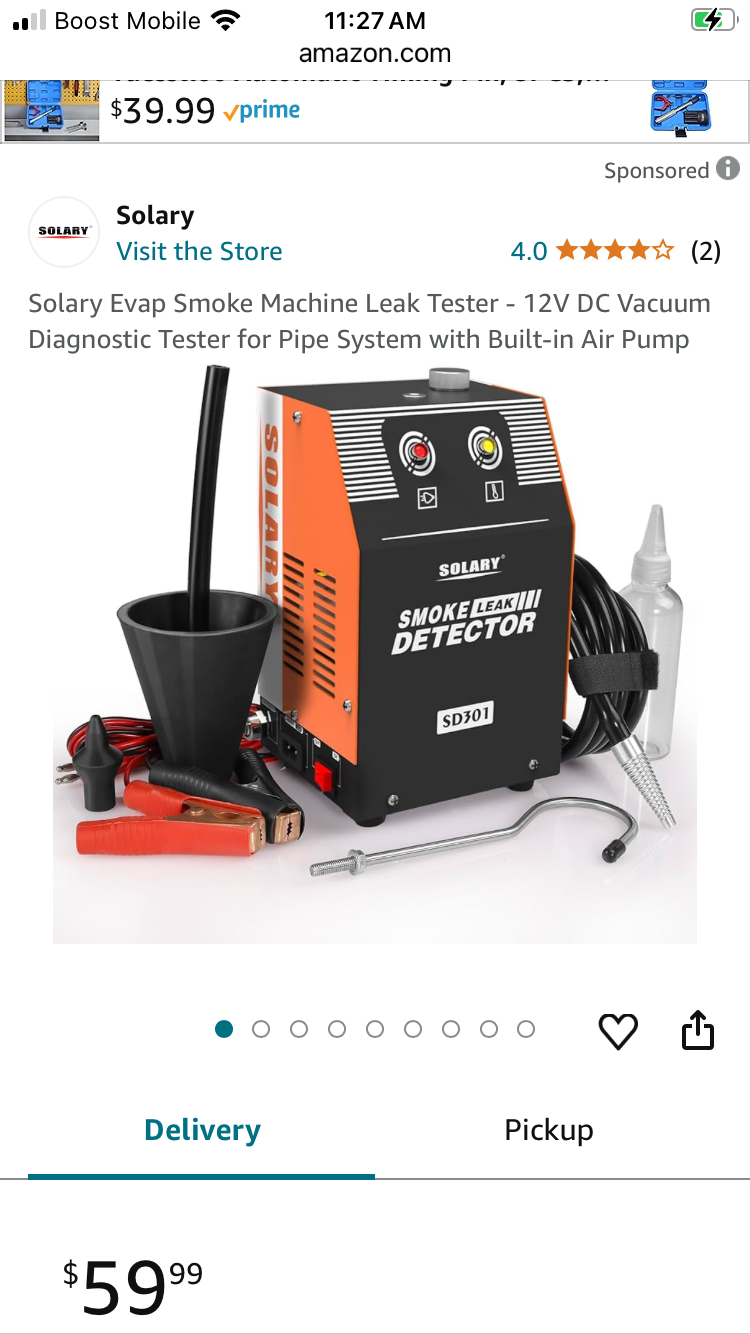

Last week was working on family member’s Nissan Cube with transmission issues, pulled pan and replaced filter, and another filter that’s more of a strainer.
It kept dripping fluid with new gasket, but it appeared to be leaking at the back of transmission because the front of car was on ramps.
Decided to try my smoke machine to help find where the leak/leaks were, put the hose that blows smoke in transmission dipstick/fill tube, found several leaks!
One big leak I carefully tightened a little more and more and the smoke stopped flowing out that area of pan, but there was another leak that couldn’t be stopped by tightening more.
The new metal/composite pan gasket on this Nissan is supposed to not need sealer, but after messing around so much pulled pan down again cleaned pan and gasket with acetone and used Permatex The right stuff rtv sealer with that gasket.
After bolting on ran smoke machine again and no more smoke leaking out, the right stuff rtv says ready to add fluid again after 90 minutes but waited over 12 hours to cure before adding transmission fluid just to be safe.
The smoke machine is a real cheap unit bought off Amazon this past spring to troubleshoot evaporative emissions code that kept going popping up check engine light.
You can use this to check for exhaust leaks, oil leaks etc, use baby oil, the smoke does stink.
https://www.amazon.com/Solary-Smoke-Machine-Tester-Built/dp/B0D9B4CZPT/ref=asc_df_B0D9B4CZPT?mcid=c13c6d5b131731ae8191224aa9aca00e&hvocijid=15779459538962121095-B0D9B4CZPT-&hvexpln=73&tag=hyprod-20&linkCode=df0&hvadid=721245378154&hvpos=&hvnetw=g&hvrand=15779459538962121095&hvpone=&hvptwo=&hvqmt=&hvdev=m&hvdvcmdl=&hvlocint=&hvlocphy=9030048&hvtargid=pla-2281435177658&psc=1 https://www.amazon.com/Solary-Smoke-Machine-Tester-Built/dp/B0D9B4CZPT/ref=asc_df_B0D9B4CZPT?mcid=c13c6d5b131731ae8191224aa9aca00e&hvocijid=15779459538962121095-B0D9B4CZPT-&hvexpln=73&tag=hyprod-20&linkCode=df0&hvadid=721245378154&hvpos=&hvnetw=g&hvrand=15779459538962121095&hvpone=&hvptwo=&hvqmt=&hvdev=m&hvdvcmdl=&hvlocint=&hvlocphy=9030048&hvtargid=pla-2281435177658&psc=1
