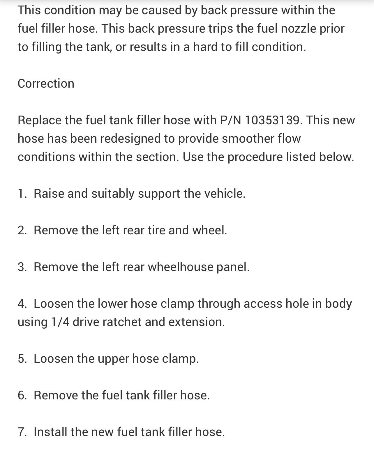

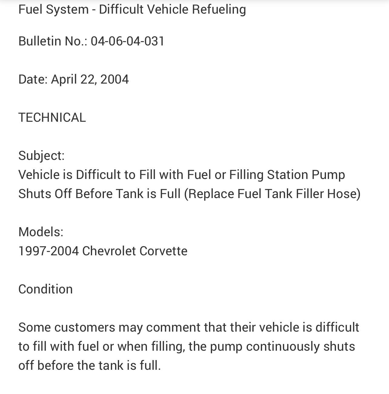

There is a TSB concerning your issue…you may need a new tank filler hose…also a stuck closed EVAP Vent Valve can cause this.

I did this TSB on my 2004 shortly after I rebuilt it. The original factory fill hose is a little to long and is slightly kinked, the new hose is shorter and has a different curve so the fuel flow is smoother.

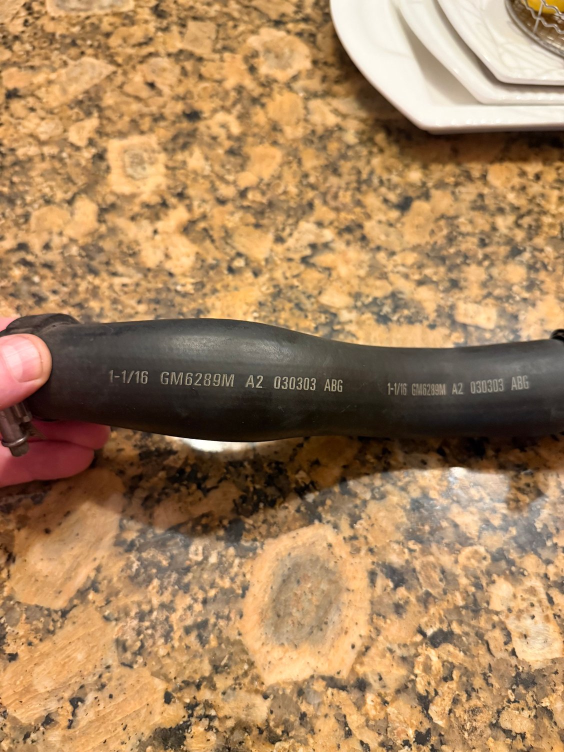

So this is the filler hose I received. The numbers do not match the part number from the service bulletin. Does this look like I got the wrong part? Is 1 1/16 the right size as well?

what did you order, and who did you order from? The hose type looks right, but I assume it's not molded. The TSB part is also 1" v/s 1-1/16. Depending on the wall thickness and tolerance of the hose, it may or may not make a difference. You definitely do not want to over-tighten the clamp making up for a poor fit. All you can do is give it a try.

I ordered it from Dino’s salvage. I emailed them last night. Let’s see what they say. I paid $150 because I couldn’t find it anywhere else then found this https://vettenuts.net/1997-04-c5-cor...w-857637246302 but it’s not 1” diameter either

They just told me that all those hoses have the number on there that I posted and that it came out of a 2004 C5 Corvette. Does that automatically mean that it was the hose for the service bulletin?

That is a general fuel hose type number. You will see that same number on many vehicle from that time. If it came out of a 2004, and yours is collapsed, I would give it a whirl.
