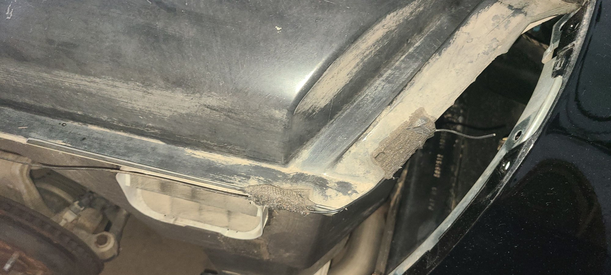

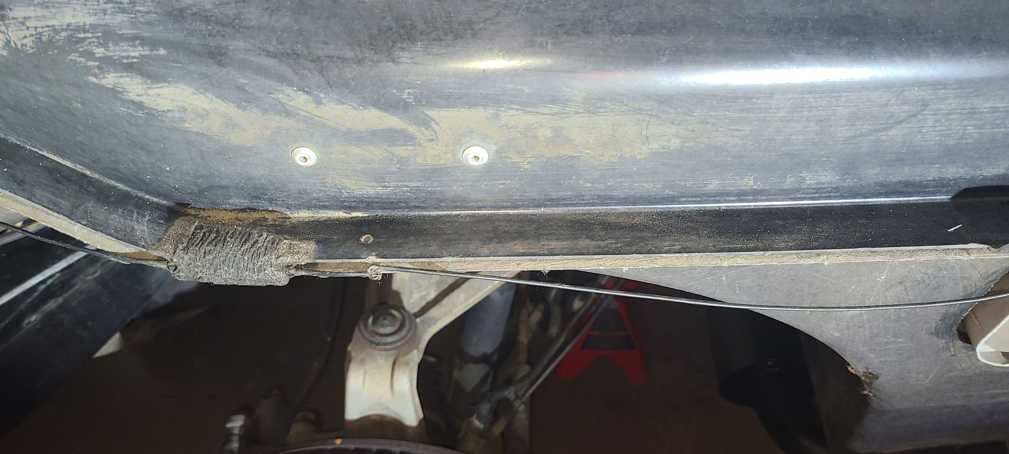

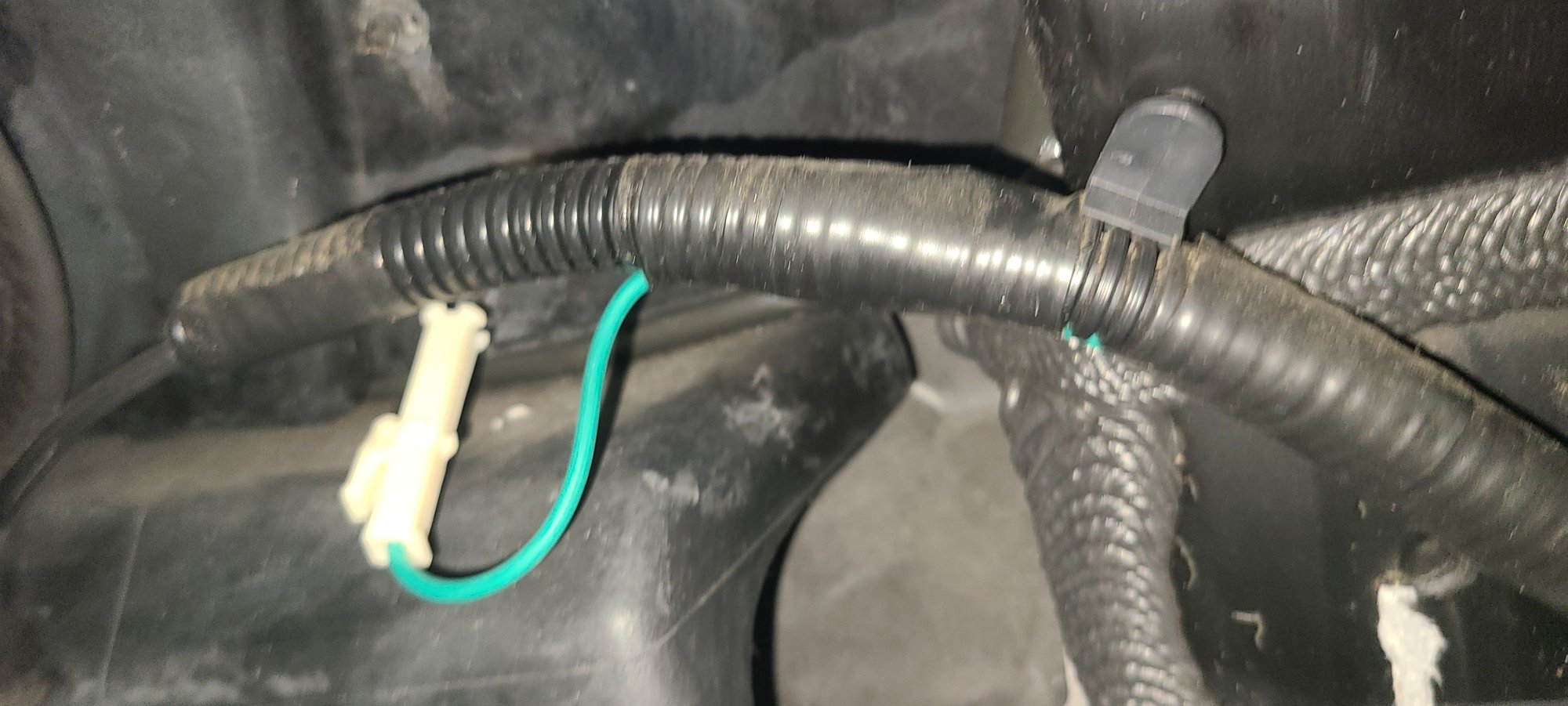

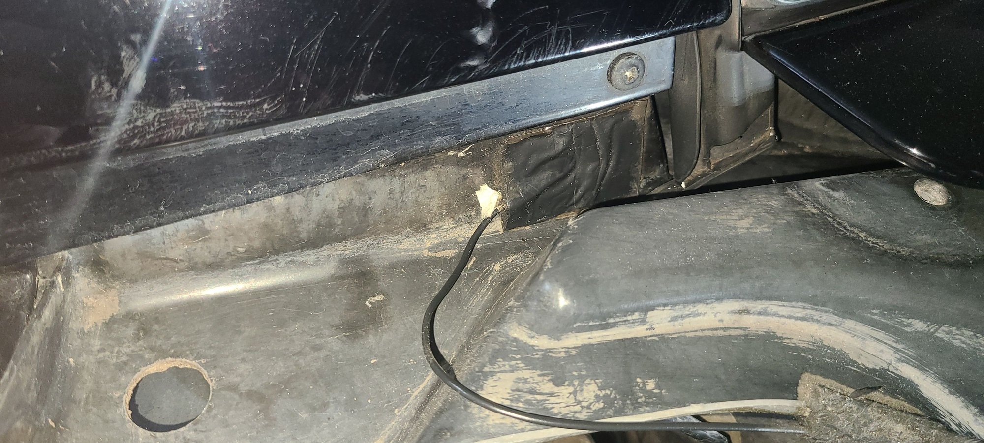

I am working on my 04 Vette and discovered a mysterious wire that I am hoping someone can ID for me. I removed the driver-side rear quarter panel and found a single black wire running along a seam to the rear tail lights. The wire comes through the pillar on the driver side and connects to a green wire.

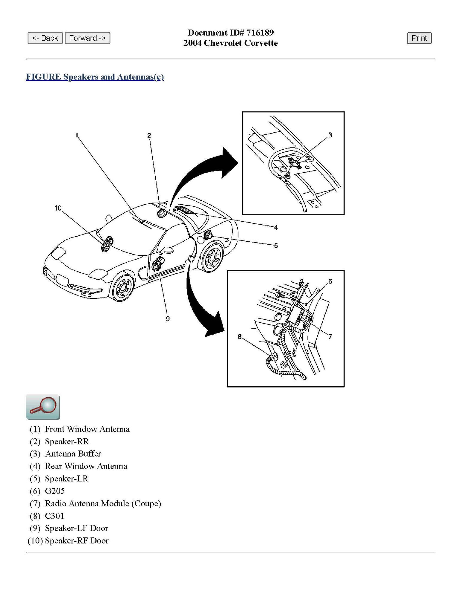

@kmartinka ....I assume you have a coupe? I think that green wire goes to the antenna module. Can you trace the green wire in the harness loom?

@kmartinka some more specifics about the Antenna Module location.

Thanks everyone for the help. I am on track with antenna module idea. The dark green is coil supply voltage for the automatic antenna, which I do not have a power attenna. I will check this later today to confirm.
