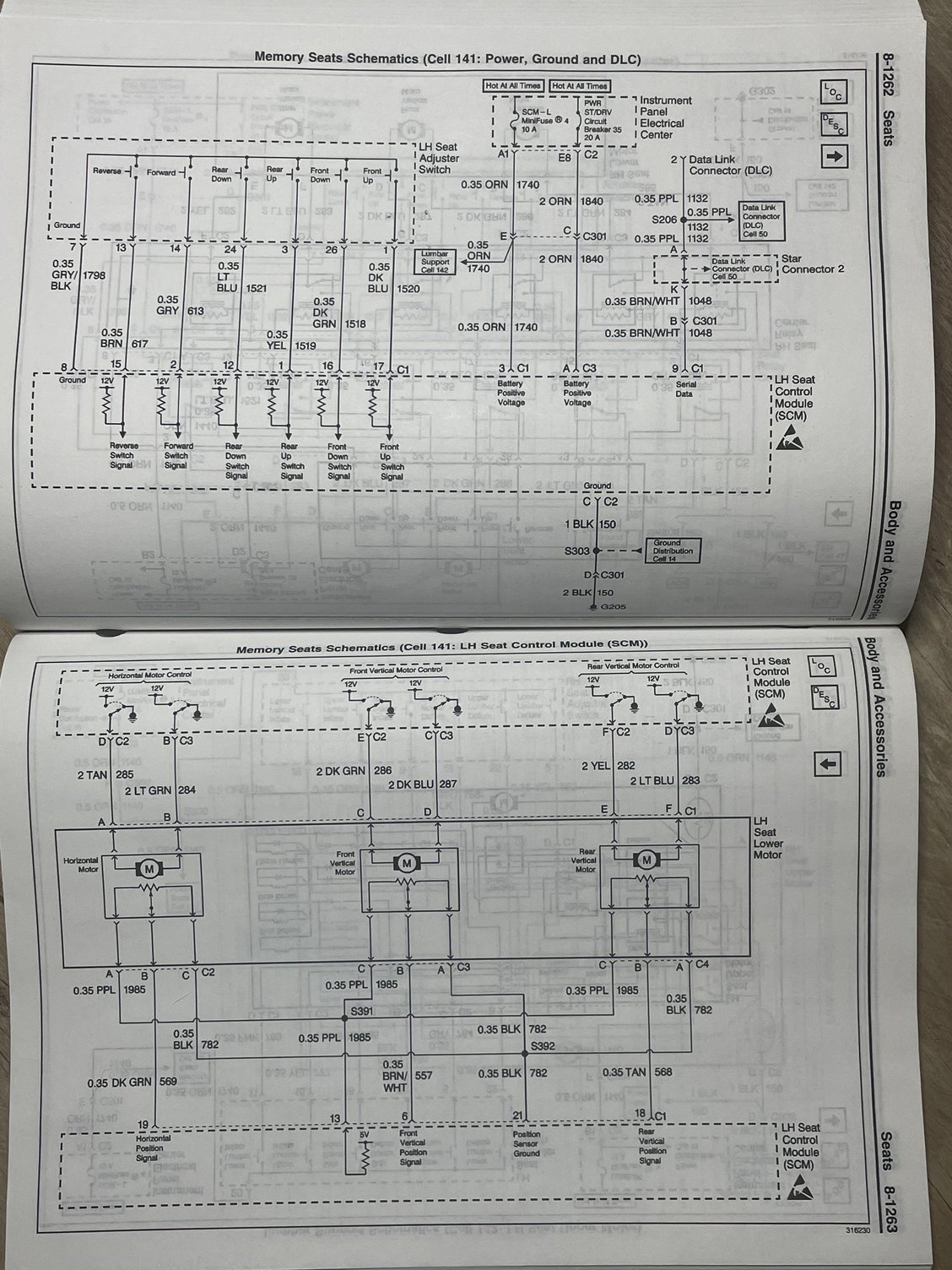

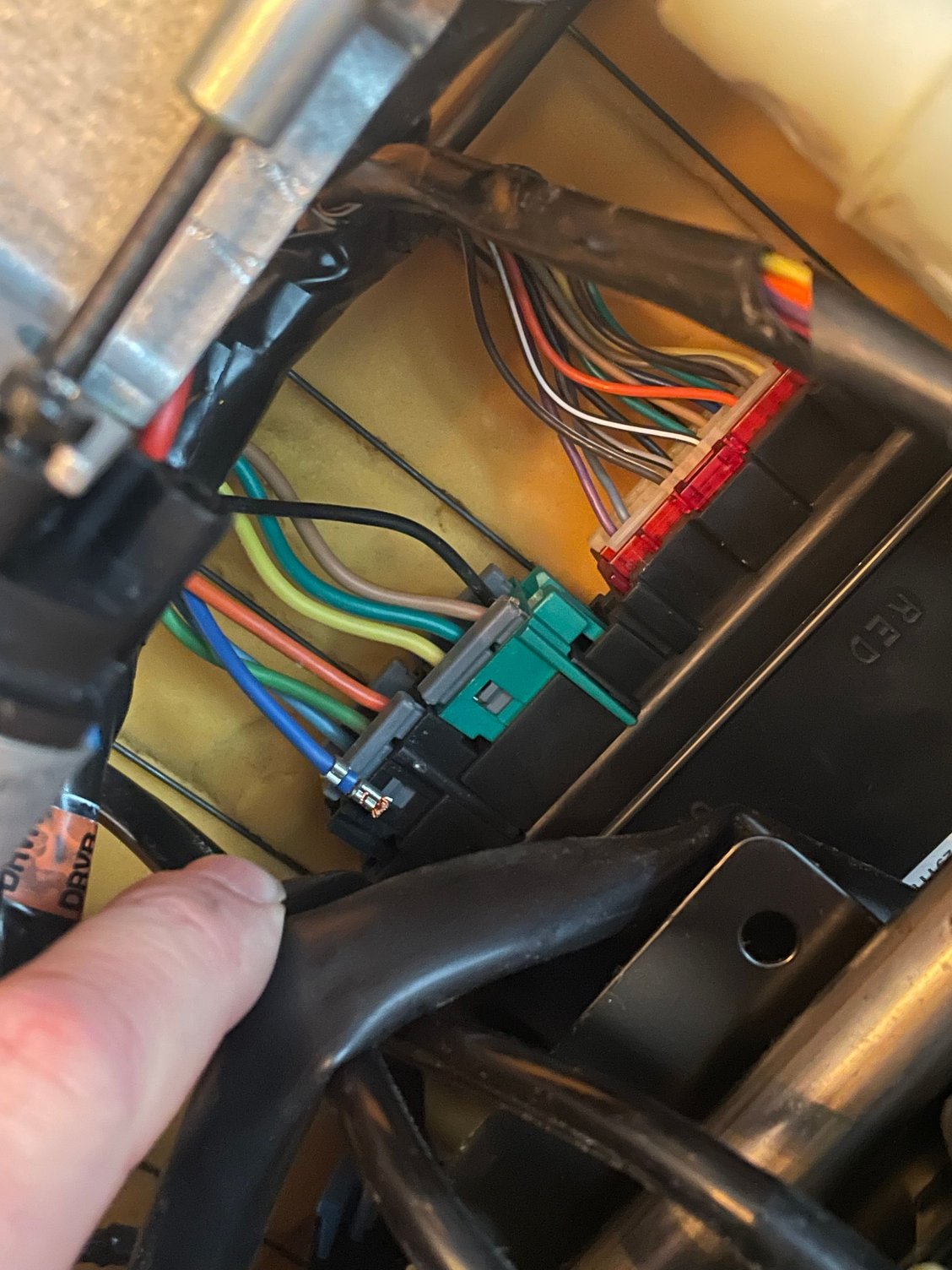

just fixed the same problem on my 98 in this case there was a broken wire, I put the relevant wiring page from the book if that helps.
In my case I crimped a new pin and the wire is 1/8" shorter now, since that's a regular 280 plug. In any event there's a good chance the motor is fine, good luck and enjoy.
