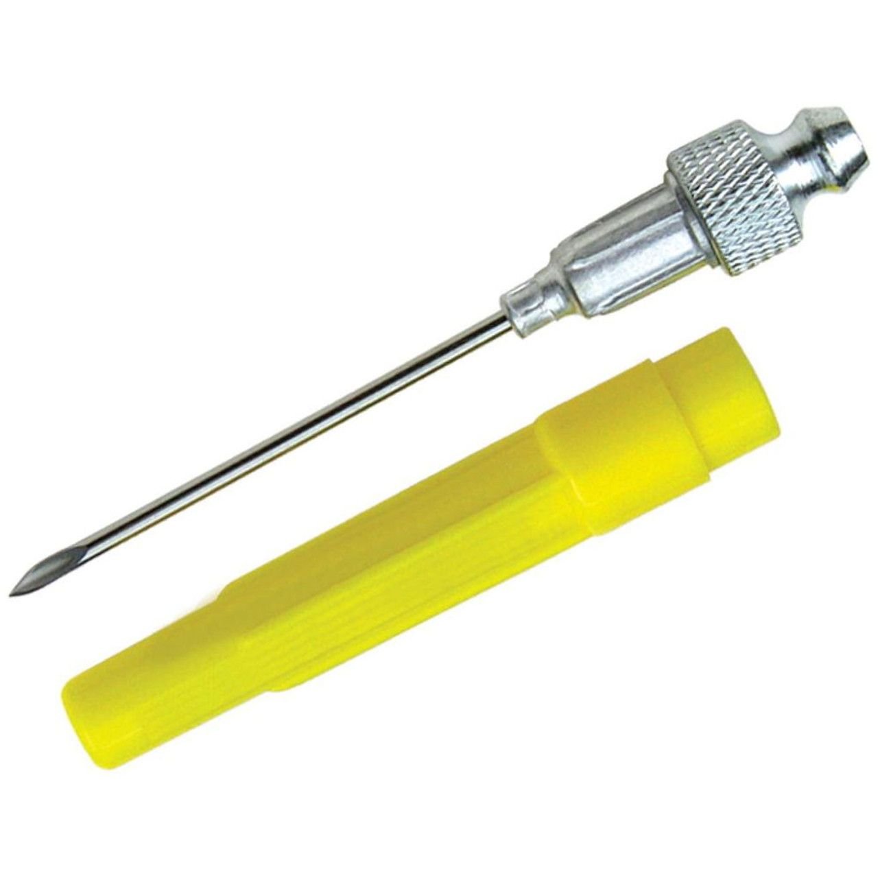

Of course my 2000 C5 has no grease fittings on any of the ball-joints, tie rods, etc. But I do have a needle adapter that connects to my grease gun.
I was thinking of injecting each boot and then letting the excess grease ooze out before I clean it and seal the needle hole with some black silicone.
Just wondering if anyone else has done this to extend the life of the original joints, etc?

Never even considered it....ever. I started working on cars when when oil change intervals were every 3,000 miles, and plenty of zirc fitting to grease. Sealed assemblies are one of the many advances of the 20th century....enjoy them.
I will admit, if we were living in a post-apocalyptic world, where replacement car parts were no longer available, I might resort to using that needle.

I'm pretty sure that the boots have a seal to the body of the joint, which keeps contaminants out. To insert the "needle", you break the integrity of that seal. However, I do remember back in the late 60s-early 70s, when Ford first introduced the "permanently lubed ball joints", and then had issues with them. The dealers were drilling a small hole in the upper caps of the joints, and installing regular zerk fittings. I remember one of my neighbors mentioning it, back in the day, in regards to his Ford Galaxie.

The truth is leave the joint perfectly sealed. It has all the lubricant it needs and just filling the boot is not going to extend it.
The silicone can and may fail ten you expose it to all things damp, dirty and evil.
Generslly when the ball joints fail the bushings on the arm need replace. Complete control arms are available at a reasonable price. Just do the whole arm. If you drive much it will drive much better. Many cars are driving on bad bushings.

I use one of those on my Jeep on the lower ball joints. The zerk is a flush one that is a PITA to reach. I can squeeze it between the seal and the knuckle. I use it after having the rig submerged or a lot of wheeling in deep snow. The rest of the fittings (all 21 of them) with zerks get a greasing as well. On a vehicle that does not get thrashed off road I would not compromise the seal.

Don’t fix what ain’t broke. The engineers designed those to be sealed. You aren’t going to outsmart them with a grease needle

When these greaseless joints first appeared the upper ball joints on the Ford LTD's were failing in the early 80's. They learned and fix it and now nearly all use sealed joints. As long as the boot is not opened these joints lose little grease and no dirt gets in. Dirt and moisture kill these things.
But be aware they do wear. Even if you grease them they wear. So many have blown boots because they were not greased properly.
The arms on the C5 are easily found new and are very affordable. They include the bushings that also wear. By the time they fail it would have been the same time and miles as most greased joints.
Inspect and replace as needed but do not over think this. I see on the web so many things get over the top because many obsess over things that really are just normal wear or conditions. I agree if it ain't broke.
