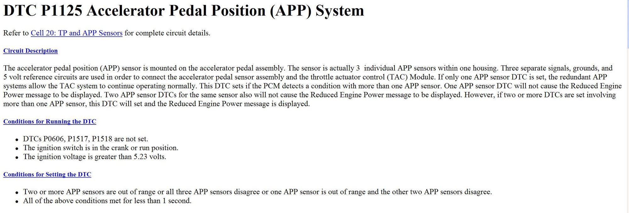

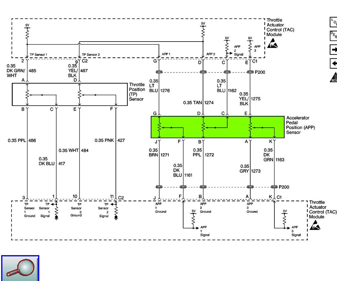

This DTC is related to the pedal sensors .
The TAC module both feed 5 volt supply and receive sensor signals from all three ..
I recommend someone with a scanner (Tech2 or similar ) to observe these voltages on the scanner with key ON , engine OFF when you press the pedal all the way to floor .
The DTC indicate two or three sensor values out of range

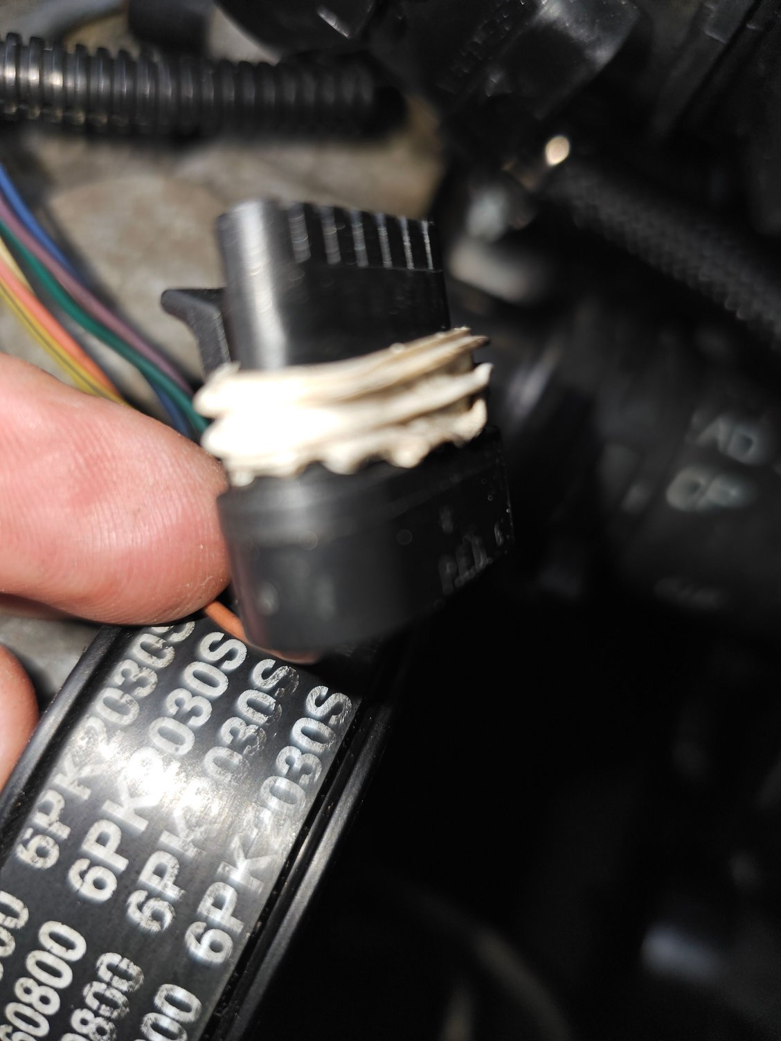

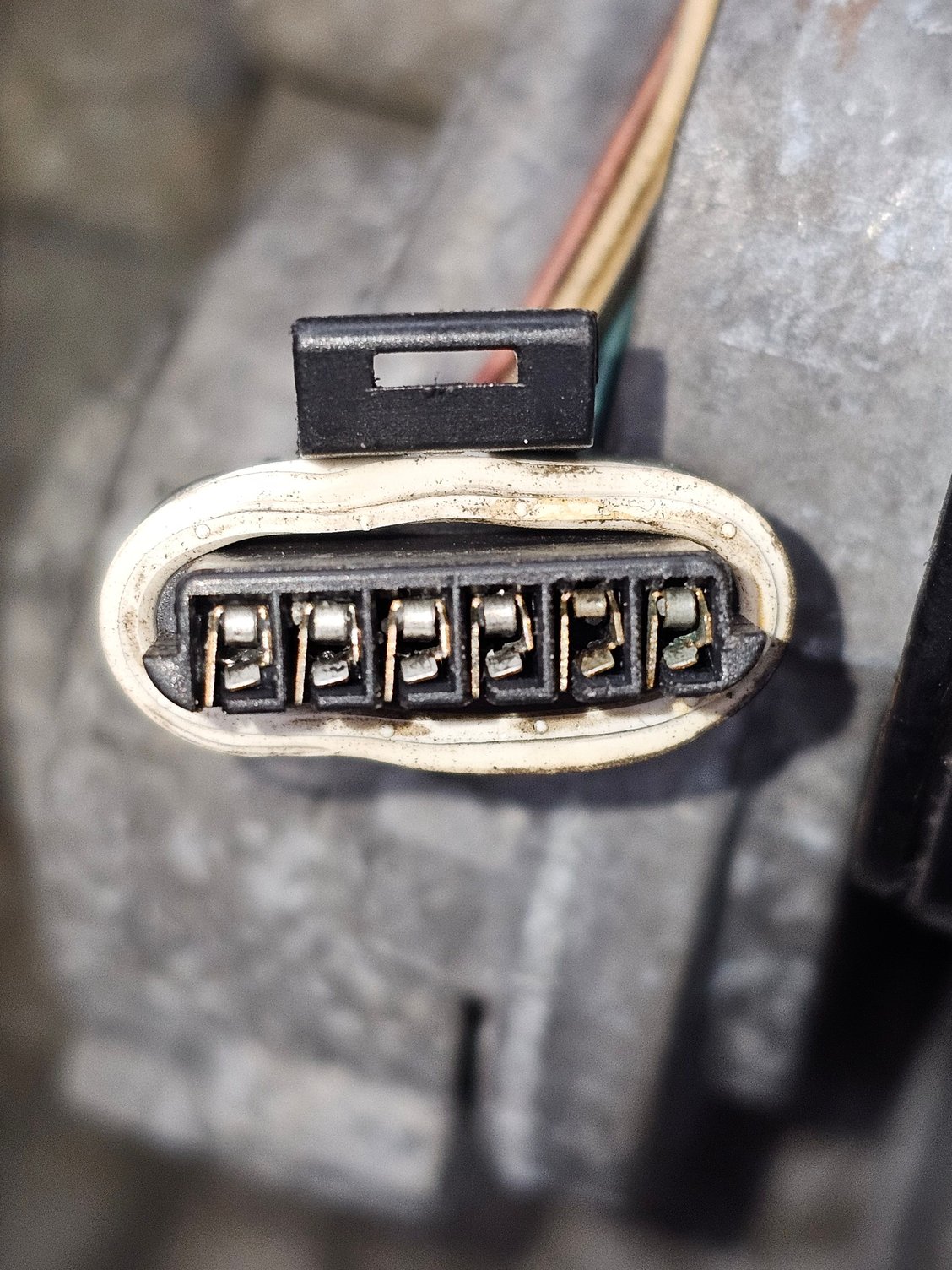

So today I had a chance to take a look. The seal on the plug was a mess. I tried shrinkwrapping the joint together.
I turned the key and got errors without even starting the car. 1120,1220,1221 1516. I looked at the plug and one of the terminals looked kind of weird and dark. In my picture I also saw something that looked like corrosion so I cleaned out all the terminals took off the seal and plugged the TPS sensor in fully. Started the car and it ran without going into limp mode.
I guess I'm going to go for a process of elimination and replace the pigtail and see where that gets me.

Well after all of this TPS sensor, pedal replacement and issues, I'm almost scared to say I got it.
I replaced the plug and took it out for a 20 mile drive and no issues at all. No errors. I hope this is it but that plug and seal must have been shot.
Always check the simple stuff first I guess.
