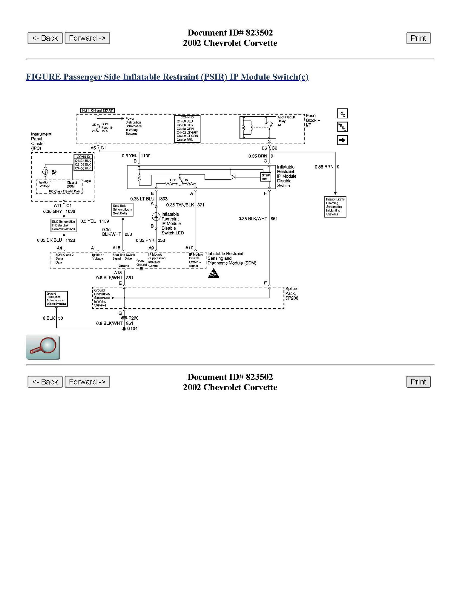

The 97-98 airbag light is controlled by the SDM which supplies a ground . A 2002 SDM controls the airbag light via the class 2 serial buss.
A 97-98 SDM is NOT connected to the the serial data buss (star connector #1 and #2) it is only connected to the DLC connector. A 2002 SDM IS connected to the serial data buss at star connector #1. Even if you connect your 98 SDM to star connector number one, the SDM is not configured to control the airbag light on the serial data bus. I think the only way to make this work, is to install a compatible SDM....which involves runing some new wiring plus a connector change. There are other differences too....not plug-n-play.

I do not see how it can work. The 98 and 2002 SDMs are very different.
