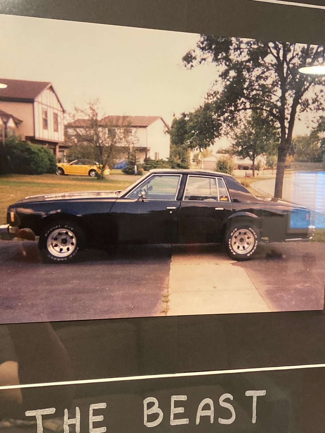

yup, did that to my old 1977impala that my Dad owned and gave it to me in 1995. It ended up with more mods when I got done with it. 350 block, bored 60 over, stroker crank, dart heads, performer RPM intake, 750holley, hooker headers, 350 trans, shift kit, and 3.73 gears out back. Pulled consistent 13.9 at a drag strip, had a mild comp cam in it with a .490 lift. My Dad is a retired auto mechanic. He did the build. He wouldn’t let me have a bigger cam in it. It was a street car, and I was 17/18 years old at that time. Probably would have done even more stupid stuff with a 12second 4 door box Chevy.
