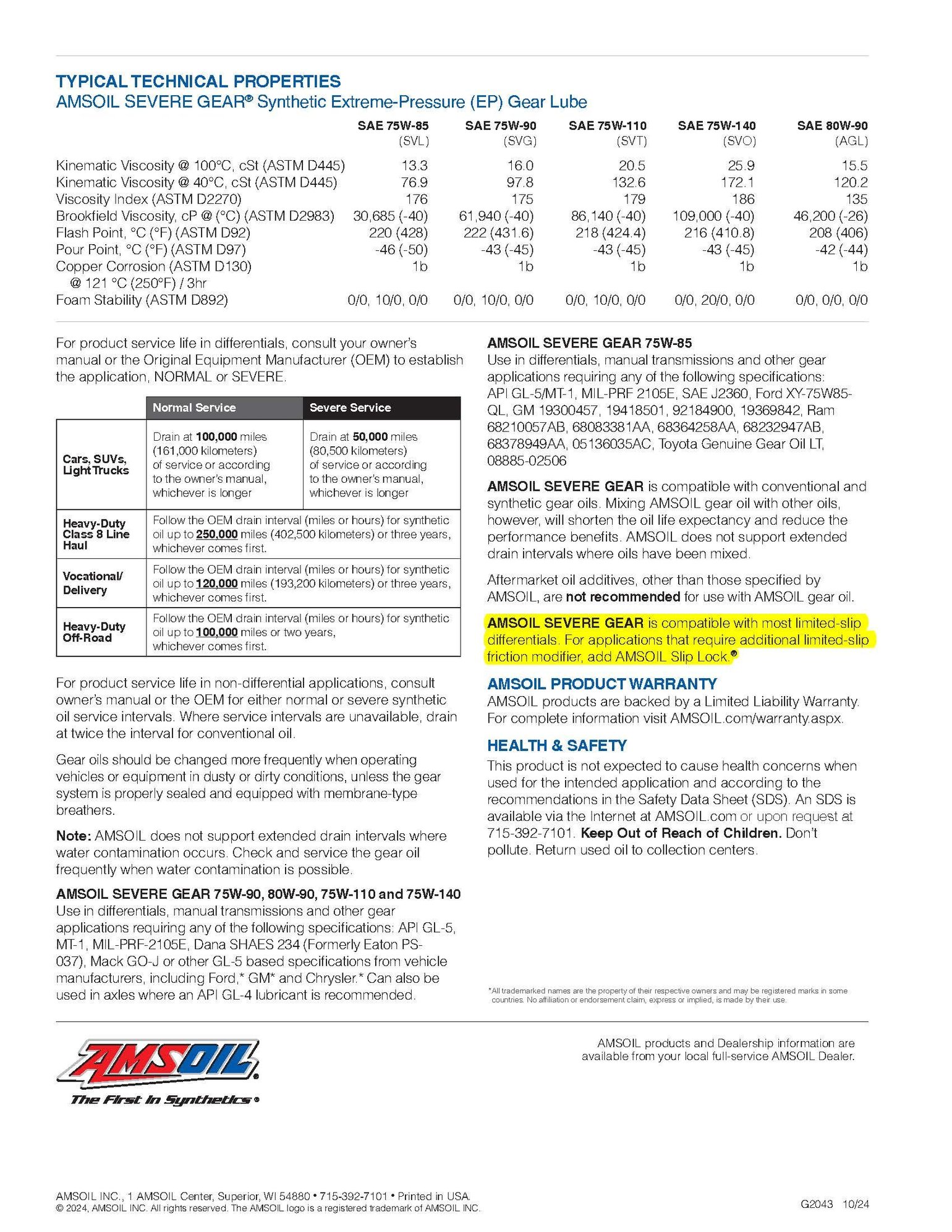

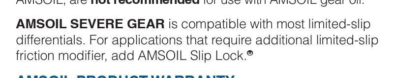

Your differential is designed to use an additional friction modifier. I take it you did not follow the directions from Amsoil.....
