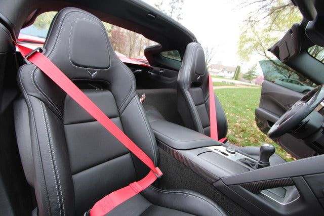

NOT normal !!...and those don't look like OEM seat belts...my 08 locks if I pull it quickly EVERY TIME.
