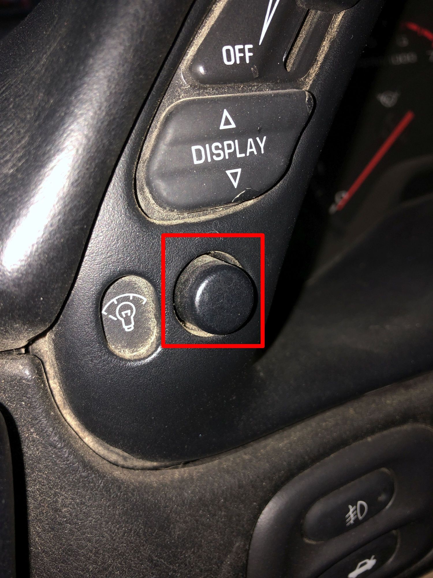

Is your interior light dimmer **** turned all the way clockwise?

To follow up on Ed's point, this is the **** you're looking for.
Found at the left side of the dash, slightly above the trunk open button
