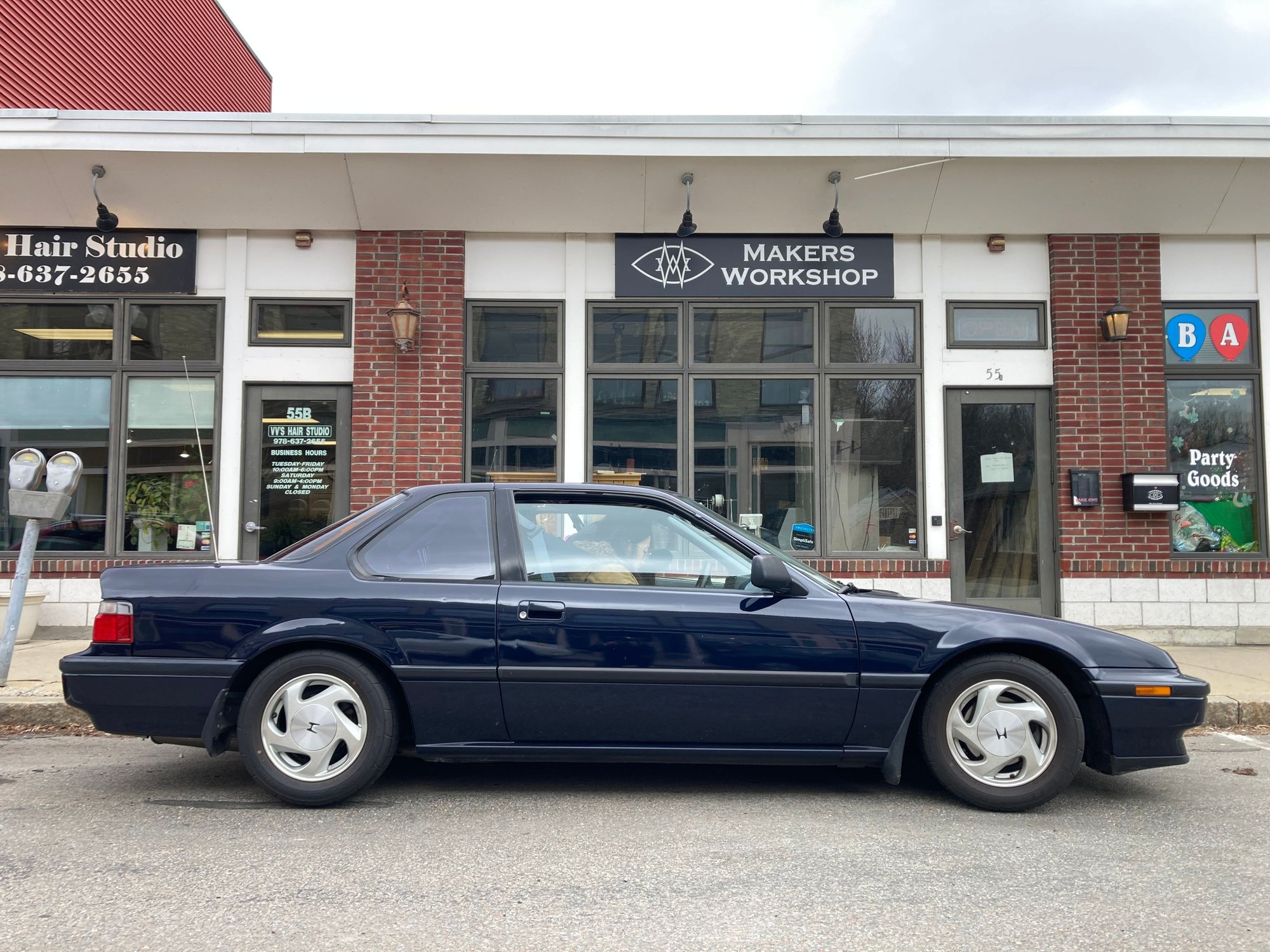

Thanks for all the great tips. I'm pretty familiar with old plastics, but a C5 Vette would be much newer than the other cars in the garage. Surprisingly, I thought aftermarket support would be huge for such an iconic car. I have a 1991 Honda Prelude, and struggle on replacement parts for it, definitely lots of improvisation and customizing. Then I have a 1997 Miata, which I'm grateful for the aftermarket. Then, a 1995 300ZX, which sort of falls into the middle. And then a 1994 Mazda Lantis (great grandfather to the Mazda 3), which has common parts with the USDM Mazda Protege. As mentioned, more familiar with Japanese cars, and looking to venture into American realm.
You bring up a good point on the 2004 versus the other three years. I had been pretty fixated on 2004 and all the focus on GM refining the shocks, which made me rule out the other years. Besides the shocks, and some other suspension bushing updates, were there other areas that saw upgrades? I've reading that the 2004 shock tweaks helped refine city road bumps.
Yes, I look at the seats and wonder how much more cost cutting could GM apply towards the department. The plastics are not the best, but is overall fit and finish good? And it's a 1.5DIN radio, that'll be a new one for me. I'm not planning on modding, more so looking to enjoy and baseline, and then go from there.

lost me at Honda Prelude

I miss my '01 Prelude. Fun car. IMO the C5 is easier to work on than a 5th gen Prelude or Z32 300zx.

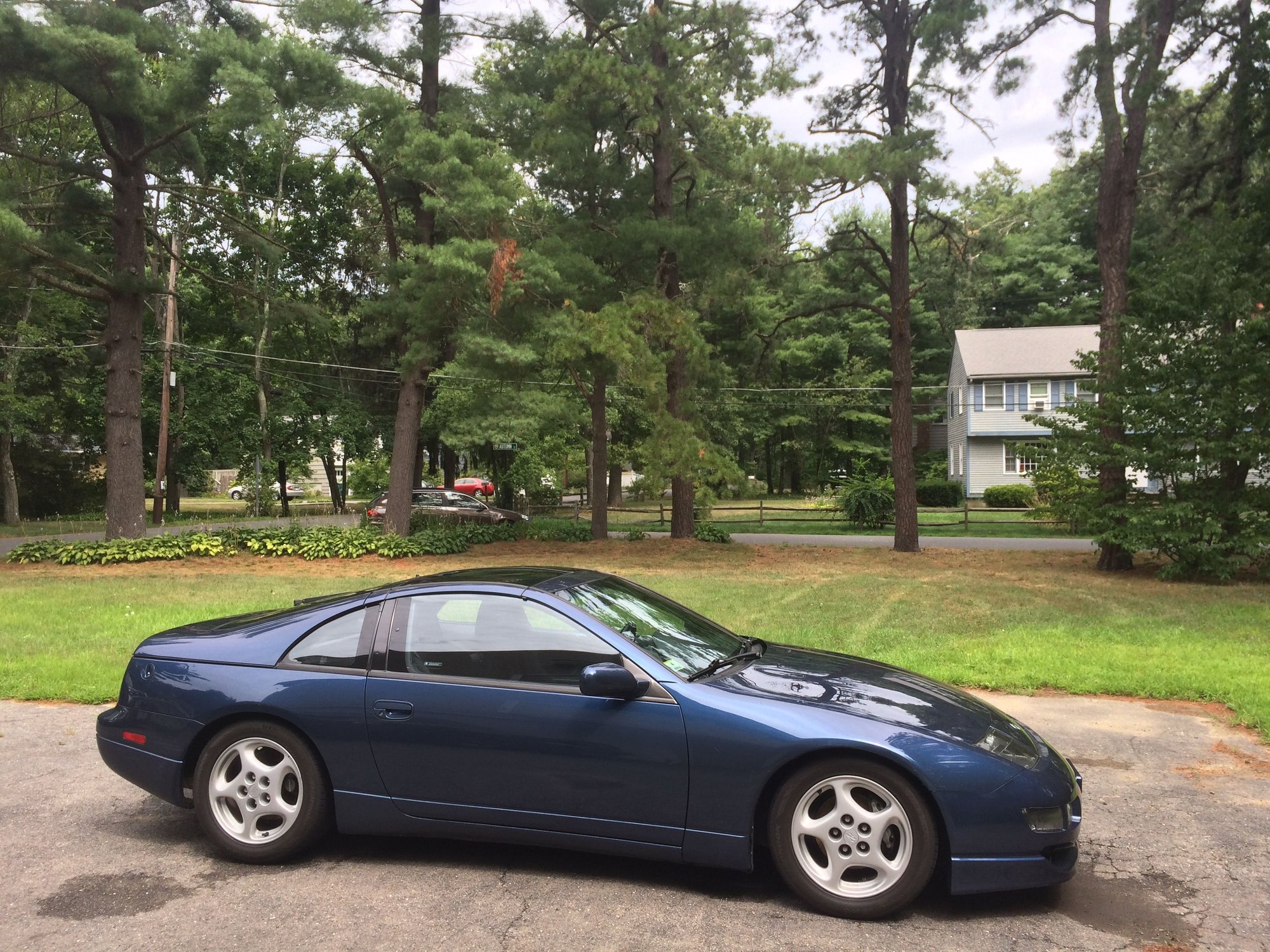

A ‘95 Fairlady, nice! Is it a TT or 2+2? The c5z is a fun car to own. I can speak to the window trim rails cracking/leaking. Not fun to fix but rewarding when it’s actually done. For how old the platform is now, it is still an amazing feeling when you take a turn at speed and it feels like your one rails

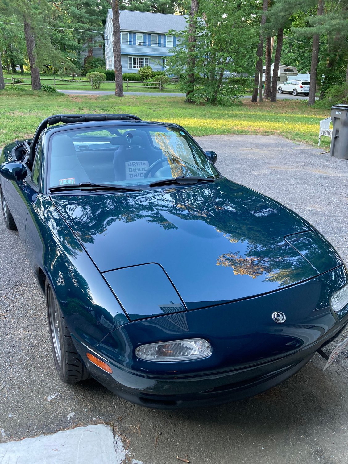

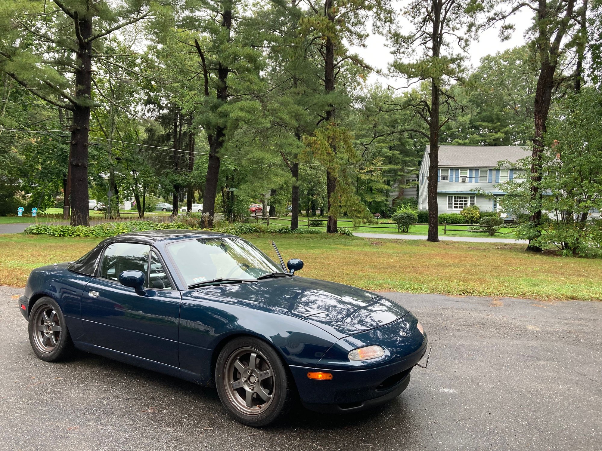

The Miata is actually Montego Blue, and I had it repainted back in 2021 after all the years of element exposure. That's also a reason why I didn't worry about the Miata going up to the limit back in the day, as the paint was already toast.
Thats not reflection on the hood, but clear coat oxidation.
That's not reflection on the hood, but clear coat oxidation.
