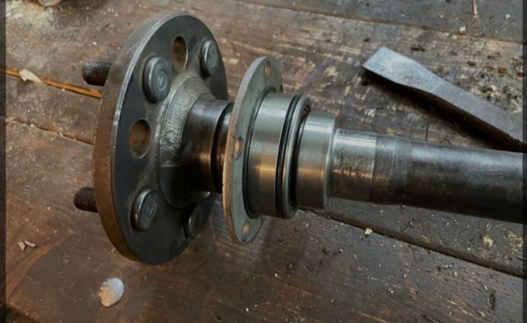

There is no "wheel bearing" in/on the rear of a Corvette... You are missidentifing the "axel" bearing! ..which is pressed onto the rear axel before being assembled into its drive location... Axel bearings ware out.. One knows it's bad because one or both axel bearings will humm when worn out. Replace BOTH sides with new Axle bearings ... About 3 hundred bucks....then no more noises!.... If they make racket and fail... gonna lock-up that axel and put you and your C5 in a real pickle.

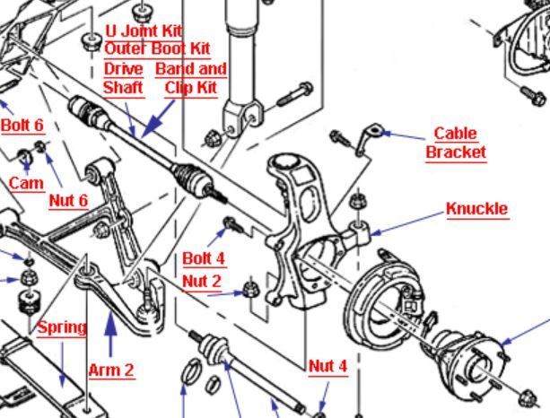

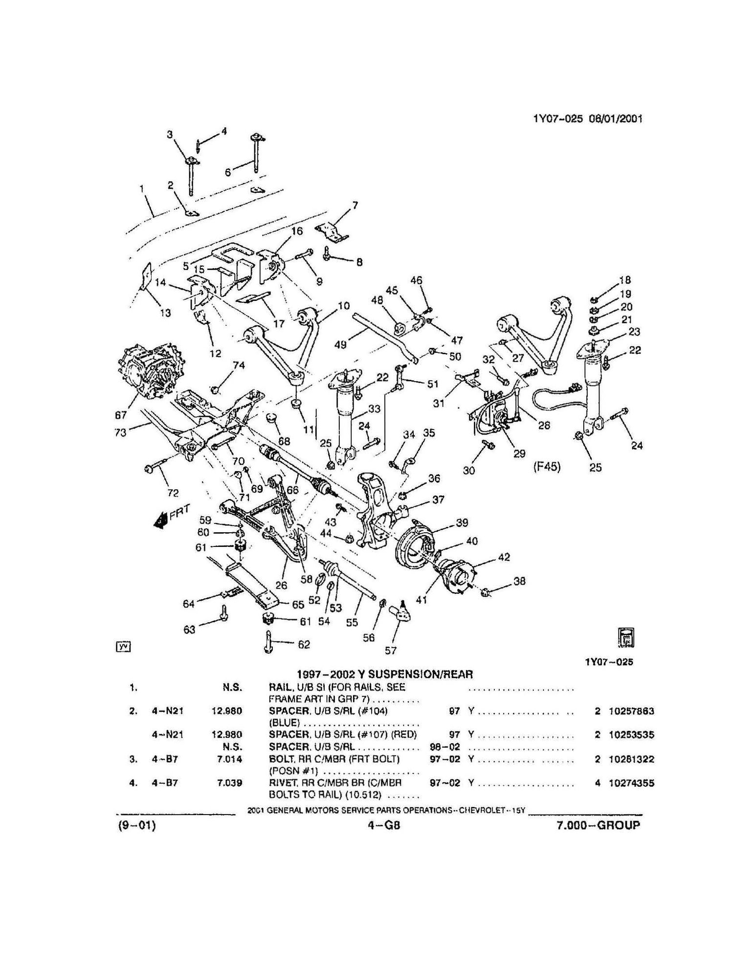

Incorrect, the wheel/axle/hub bearing whatever you want to call, it is incorporated into the hub assembly which is bolted to the rear knuckle. The outer portion of the half shaft (axle) is splined to the hub assembly and bolted to it with a 33mm axle nut.

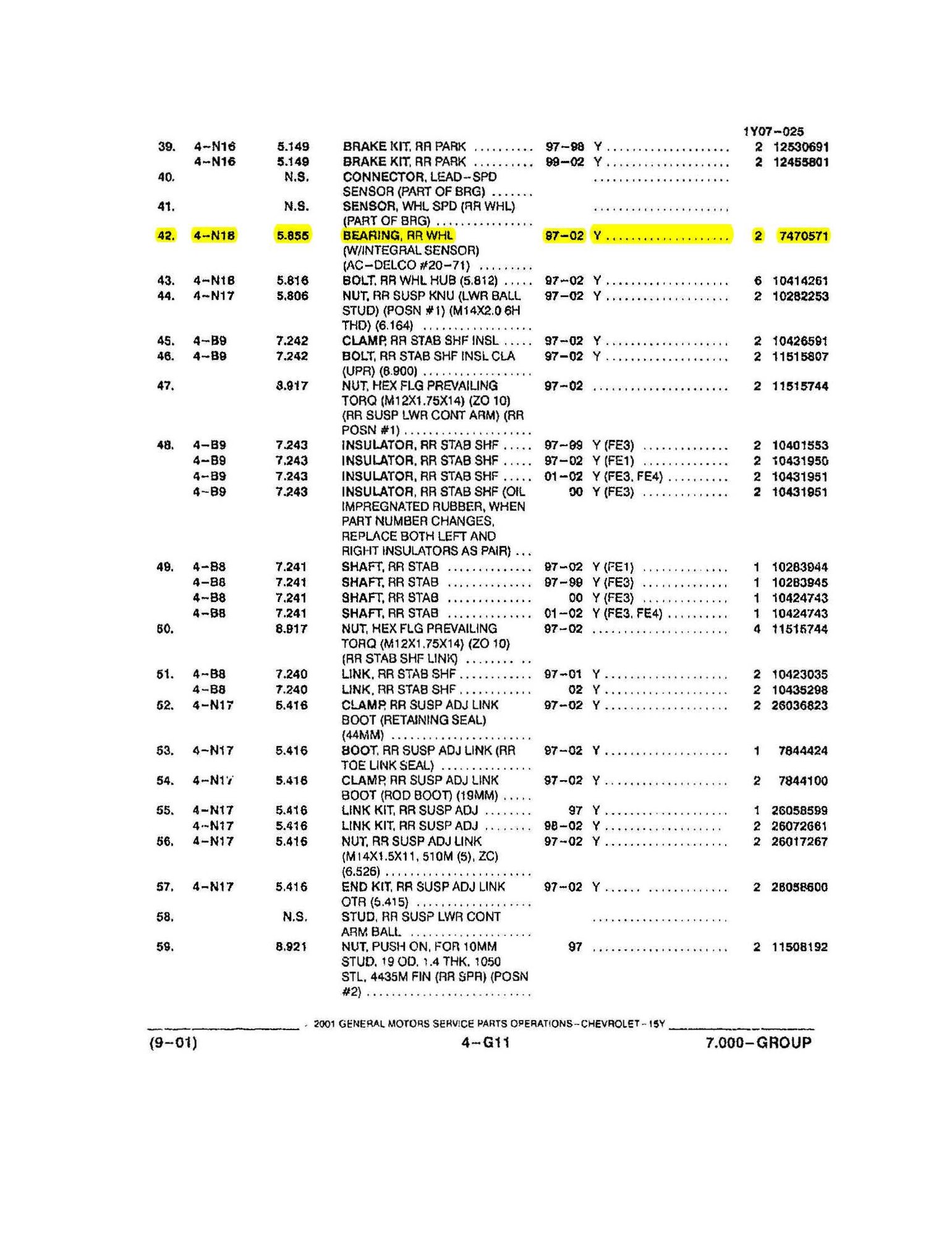

GM called it “BEARING, RR WHL, 7470571”

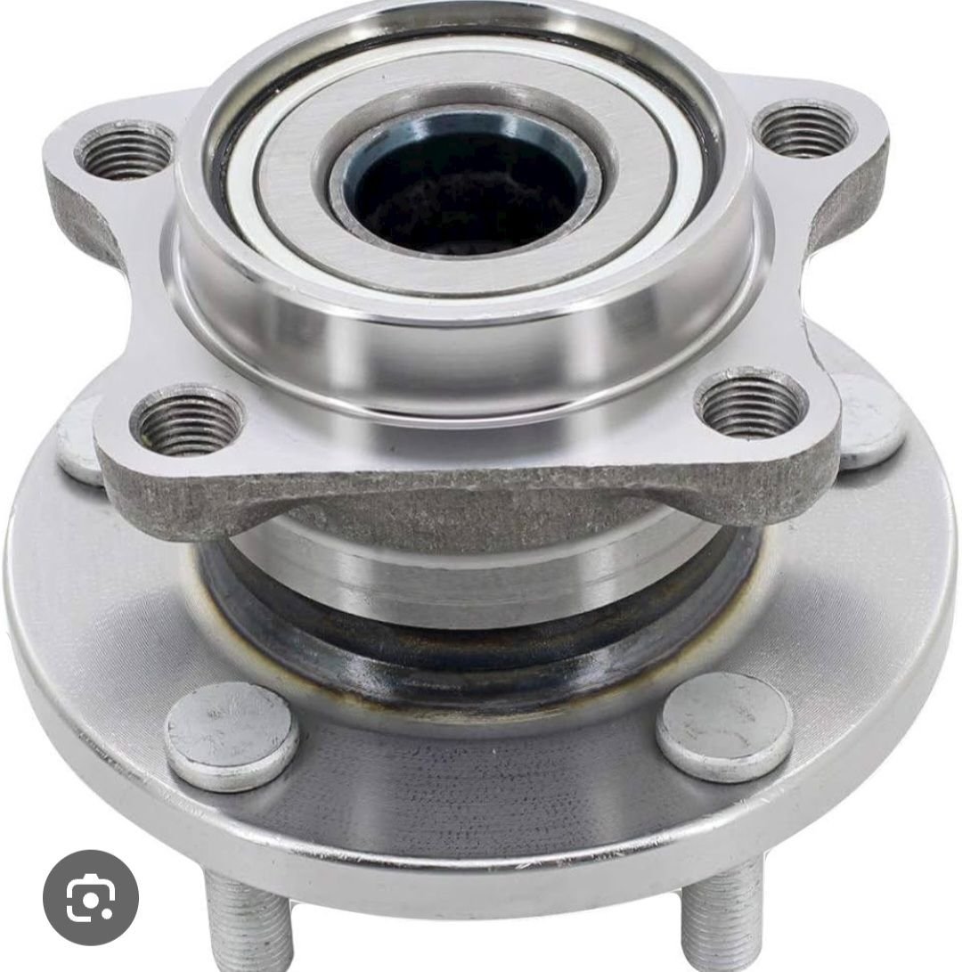

Rock Auto has them under "wheel bearing & hub", which is the bearing and hub assembly the holds the wheel to the car. Those are one of the parts that go bad and causes noise while driving.

Yeah, not so much....and yes "WHL" is the abbreviation for "Wheel"
