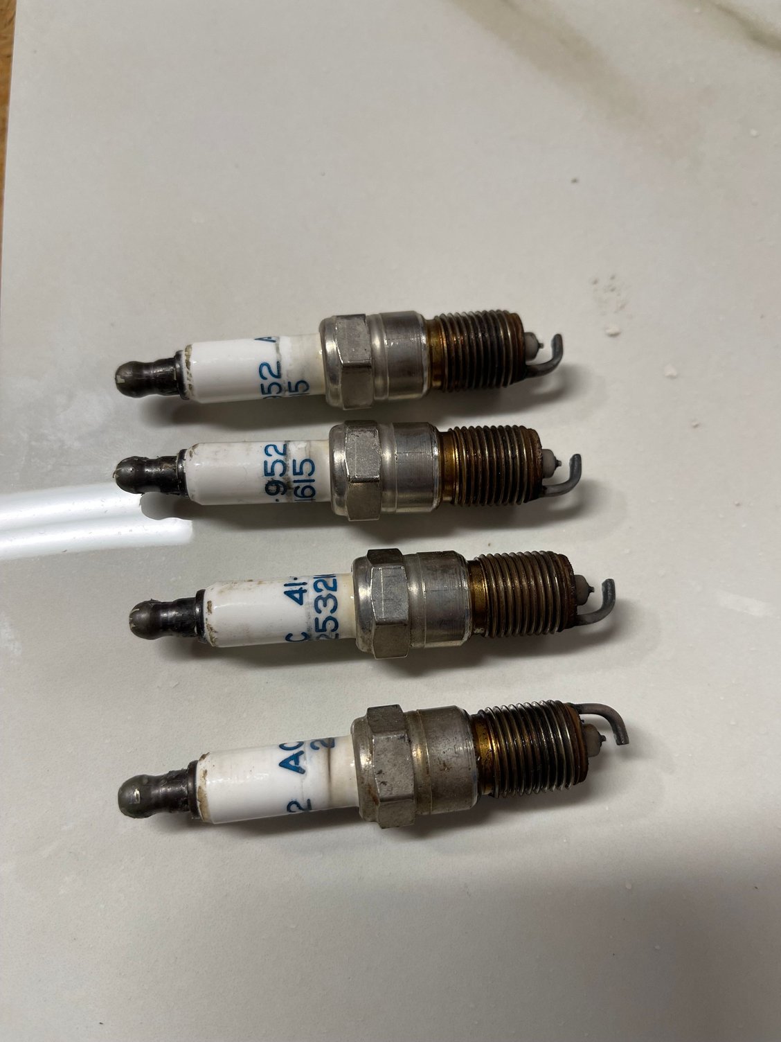

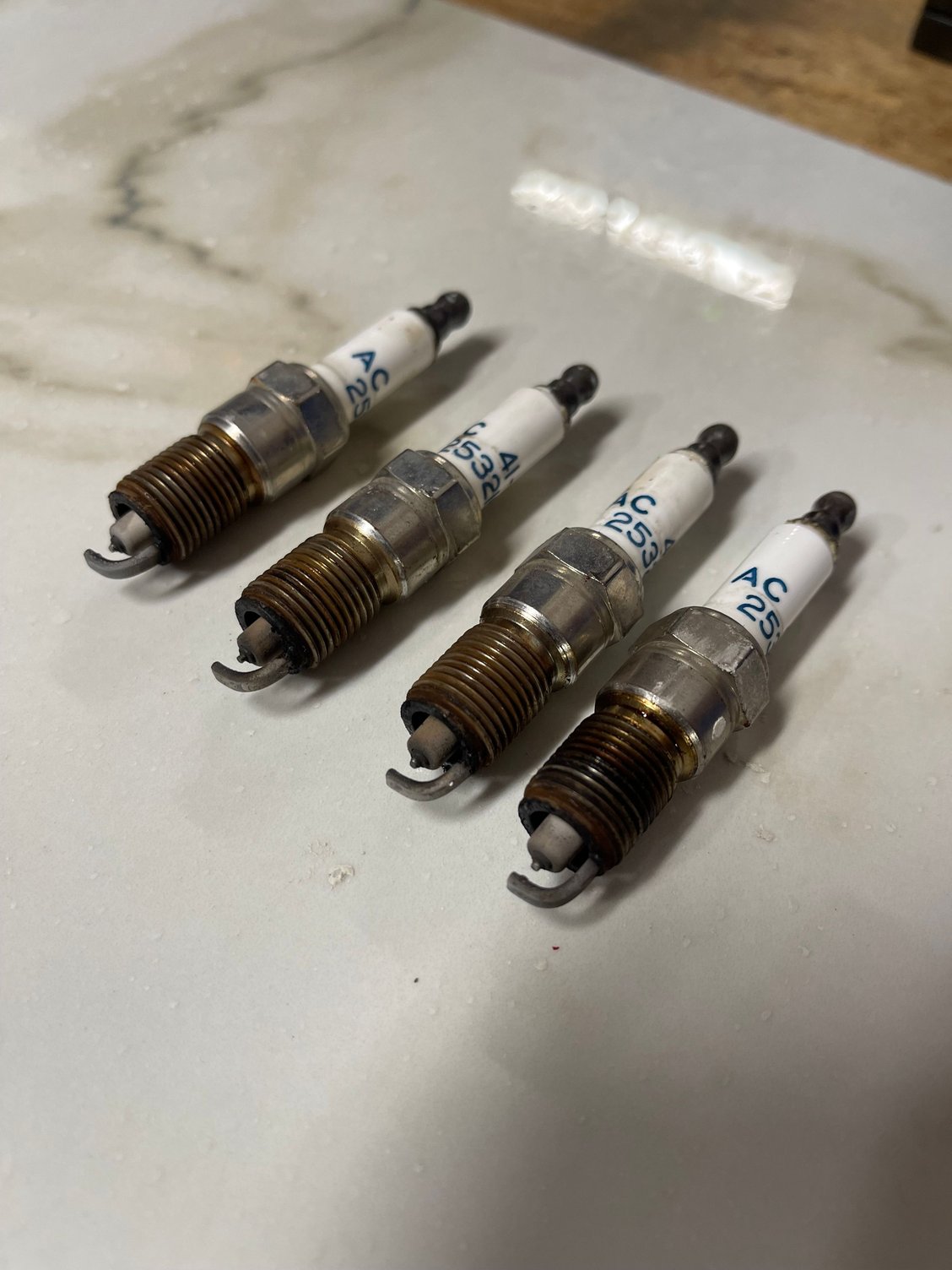

These are platinum AC plugs that have been in the car for at least 40k miles and 14 years, probably longer. I was surprised they were in such good shape. It appears they were gaped at .060 which was recommended at that time. Wires were also at least that old and could have been the originals. Done as preventative maintenance, but was hoping I would be able to tell a difference in drivability which was negligible.
I have a slight hesitation on initial tip in of the throttle that I’d like to address but have no idea where to look for that specific issue. 99 FRC with 86,000 miles. Any help appreciated.

Without a scan tool and sone diagnostic equipment you’ll only be guessing…can’t tell by looking at those plugs if that is why you posted them…could be fuel or even TPS or APP…were the plugs replaced and you still have some hesitation??

Yes I replaced them as a maintenance decision along with the wires. They were in the car when I bought it 14 years ago and about another 40k since. I’m doing other maintenance issues and hoping to solve the throttle response issue along the way.

I though the spark plug gap was supposed to be 0.040" [1.0mm] ?
Gap changed(decreased to .040) when they went from platinum to iridium plugs.

The picture of the plugs are platinum plugs that were in the car when I got it. I’d say they are at least .060 but I also noticed the platinum pads were completely missing on some of them. The new plugs were pre-gapped at .040 but I still tweaked a couple.
