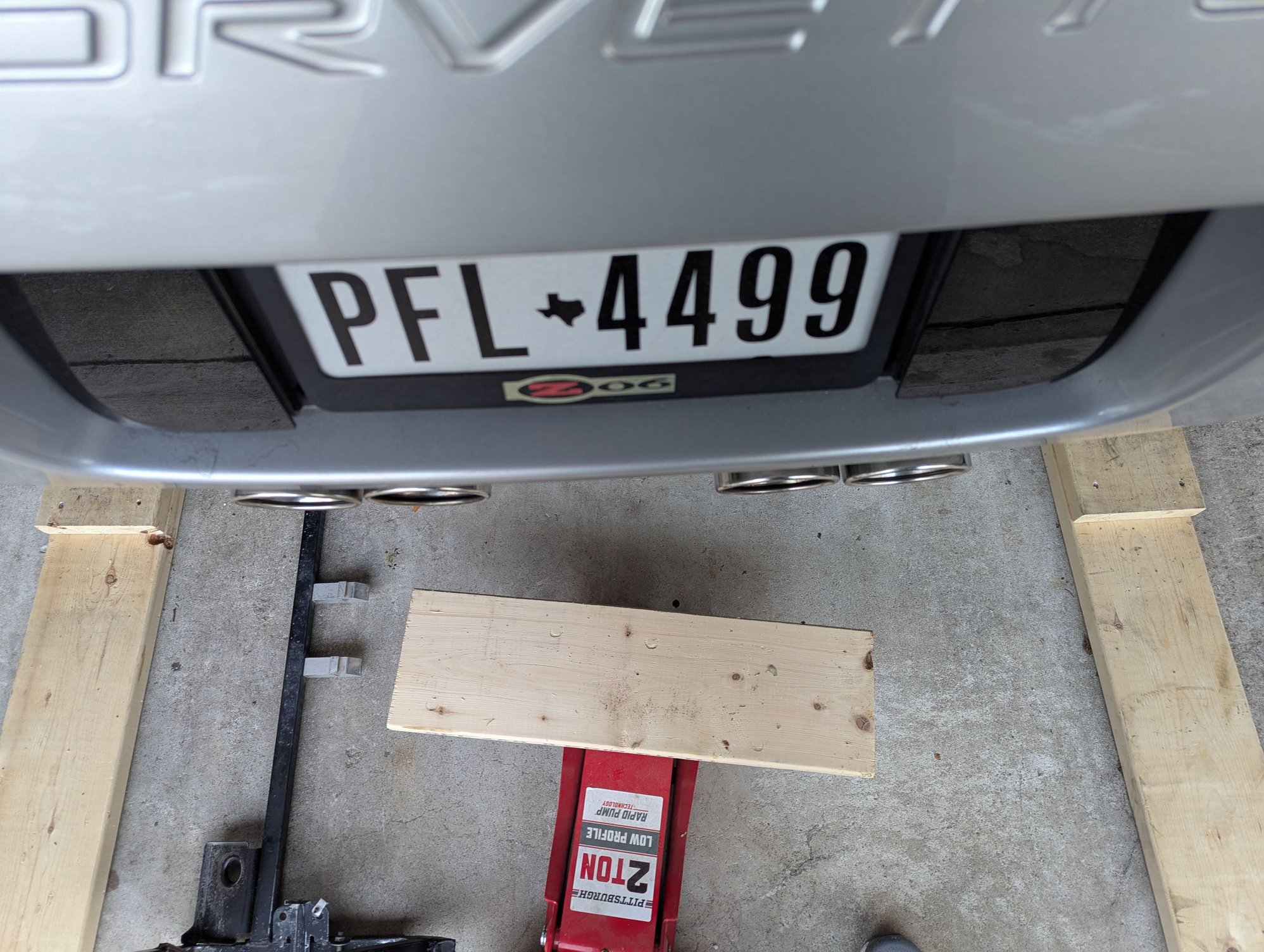

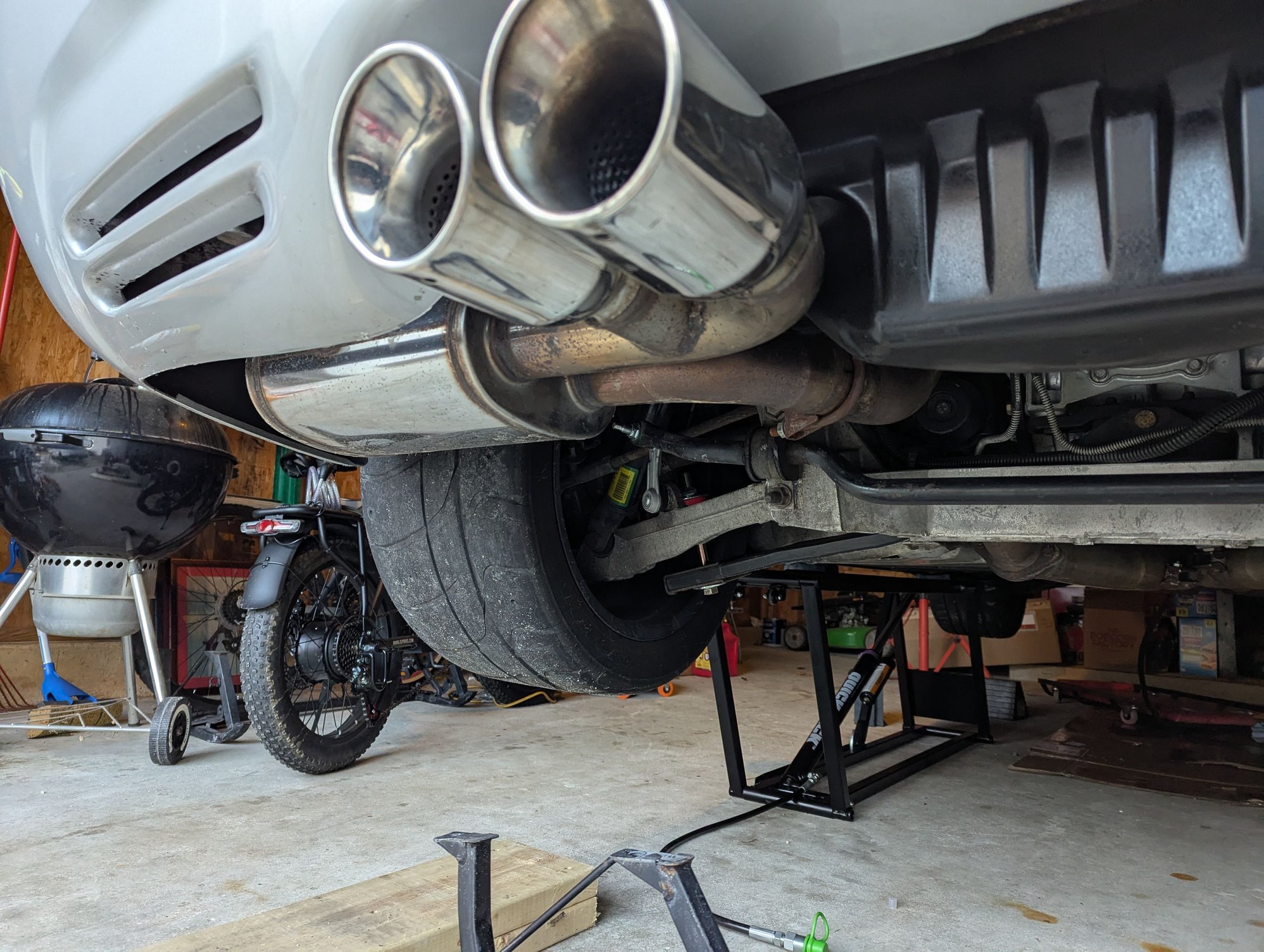

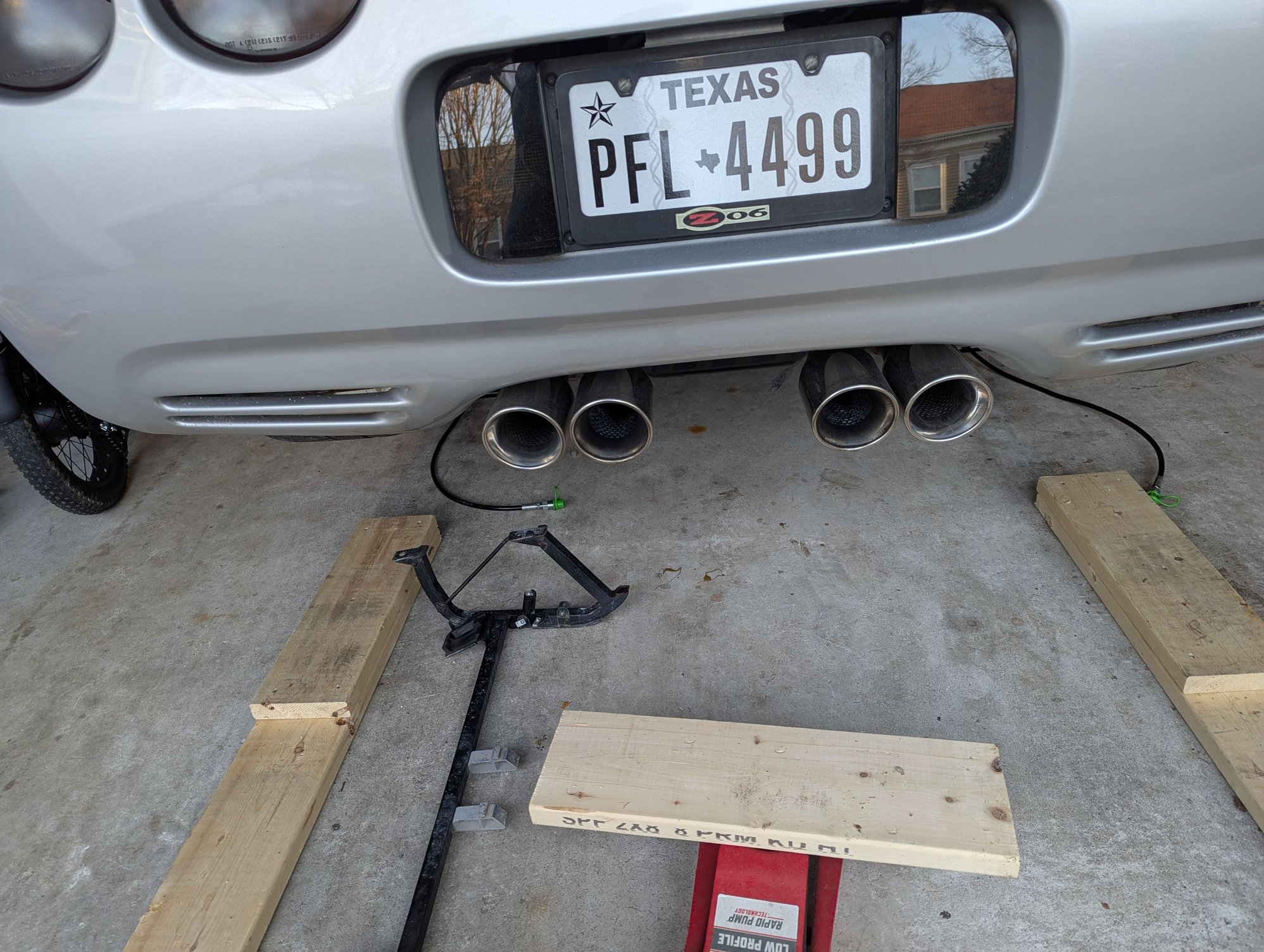

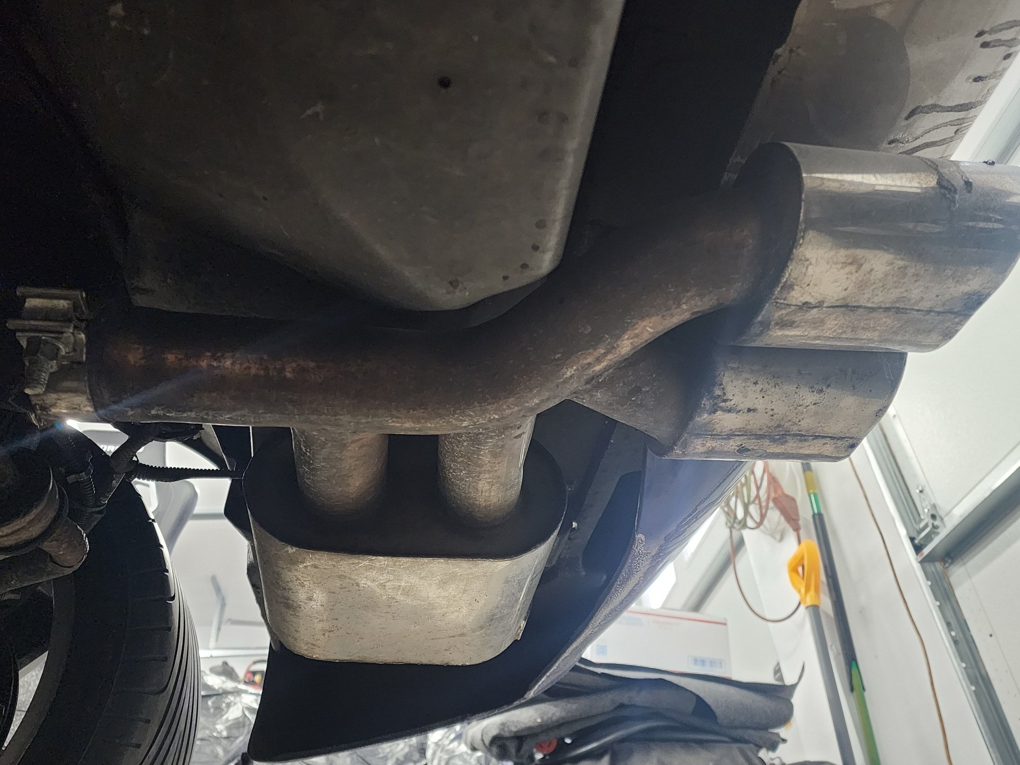

Anybody know who makes this exhaust? Not sure what the cans are doing other than perhaps kill drone. It's stupid loud with long tube's and catless xpipe.

Yeah, the mufflers in that style exhaust are just resonance chambers, not going to quiet anything.
You could add some bullet mufflers up where the cats would have been and knock the sound down some.
