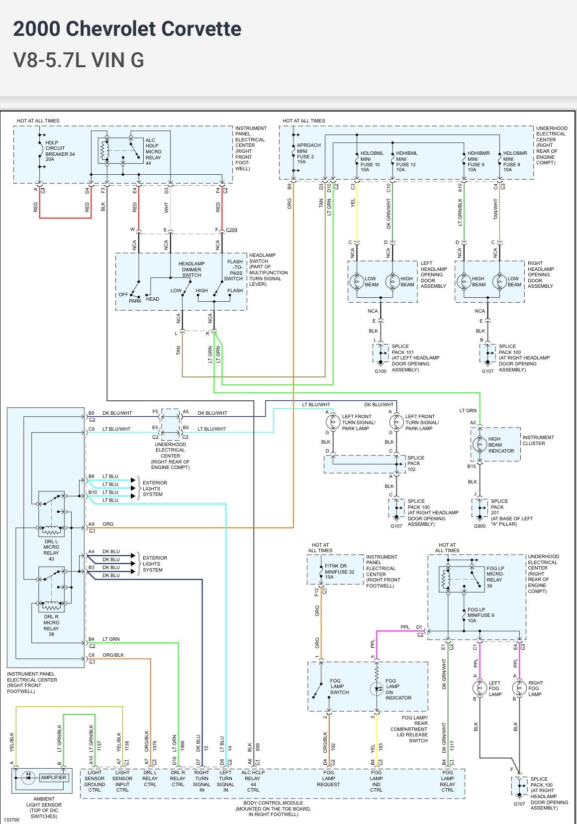

Hello all, I have a base 2000 Corvette, and I am currently having an issue with a parasitic draw. I did a drop voltage test twice, and from what I have saw, the battery has about 160 milliamp draw. When I check the voltage on the engine bay fuse box, I get about a 108 milliamps on the left headlight motor, and 67 milliamps on the right side. After I unplug those fuses to test and see if the amp draw went away, it seems that it hasn't and I now get an amp draw from fuse #25 in the interior fuse box. I check the volt drop on that and the BCM seems to be drawing about 81-108 milliamps. Any help on how to find the problem with this draw would be appreciated!

Now how exactly did you figure out you have a current draw on both motors ??...fuse 25 feeds the IPC and BCM...you can disconnect each one of the 3 BCM connectors one at a time and narrow down your search.

I think my earlier tests were a bit flawed, as now I am pulling 50 to 60 milliamps. I started pulling fuses related to the BCM, so far it was not the lumbar, powered seats, BOSE speakers, interior lights, IPC, or the passenger door module. I also checked the headlight motor fuses #3, and #4 and so far I have come up with nothing.

How about the headlight control module, or you could have some current drain being caused by the alternator. Remove the alternator output cable and measure current drain again.
