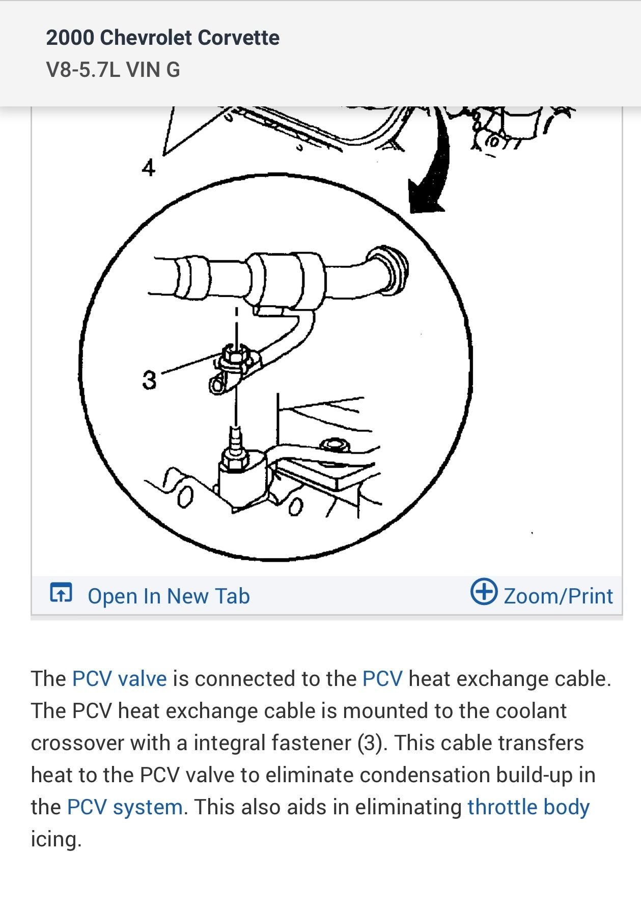

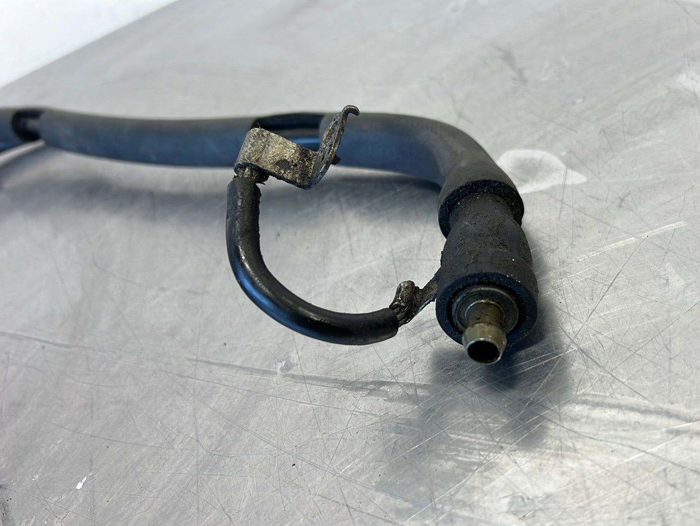

Hi,
I had to replace my O-ring on the Cam Sensor in my 2000 Corvette, so I had to remove the intake manifold. While in that process I had to disconnect the PCV hose at the passenger side of the throttle body. ( I understand that the location of the PCV has changed several times on these LS motors.)
Here is my question; Within an inch or so of the PCV location there is a thick grounding wire ( about 10 or 8 gauge ) imbedded to the vacuum hose, it's about 2 inches long and the other end of the wire is bolted down on the same stud used to connect the air bleed cross over tubing between the right and left heads.
To me, it looks like "They" are intentionally grounding the PCV hose, since it travels along each injector on the right bank of the engine. It looks very factory like.
I am the third owner of this car, I have owned it the past 21 years, I bought it when it had about 20 K miles, I don't think this is someone's add on...
It seems very strange to ground out a vacuum hose.
Does anyone know why?

The lower line in the pic is the Coolant Crossover that bolts on the front of both Cylinder Heads.
On that is a black rubber hose that goes from it to the Throttle Body on the drivers side, then out of the Throttle Body on the passengers side to the Radiator.
Disconnect it from the Throttle Body and barb both ends together. Easy trick to pick up a couple ponies. It's called the Throttle Body Bypass.
On that is a black rubber hose that goes from it to the Throttle Body on the drivers side, then out of the Throttle Body on the passengpassengers side to the Radiator.
OP is asking about this “grounding wire” on the PCV valve.

Thanks for your knowledge. I never thought that they used the wire to conduct heat to the PCV. It makes sense now to keep the PCV from freezing open during extreme cold weather operation.
