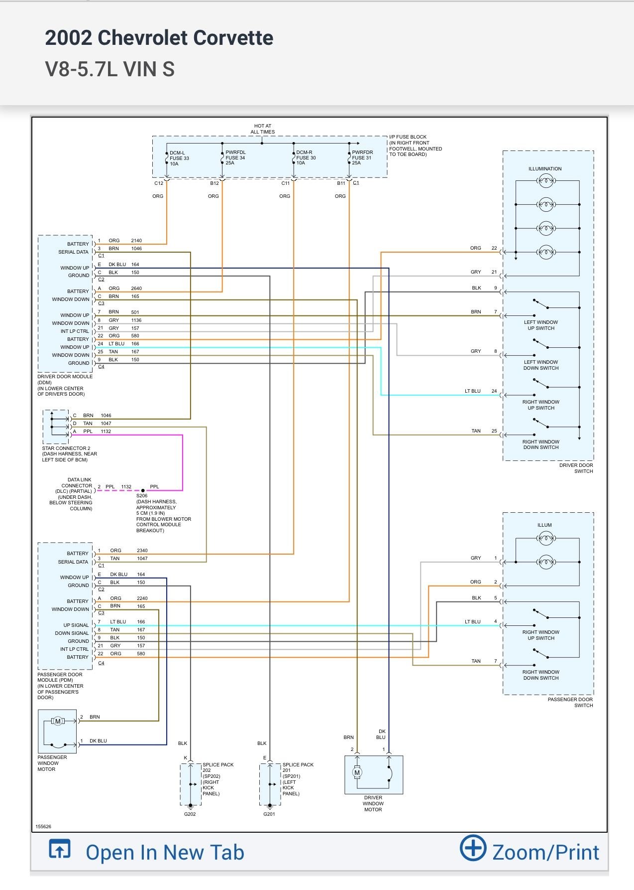

Do you at least have a 12 volt test light and know how to use it ??…wiring diagram for your 02 below…having a factory level or aftermarket equivalent makes diagnosing these issues so much easier as you can see if it’s an input or an output problem…any “B” or body codes stored ??
