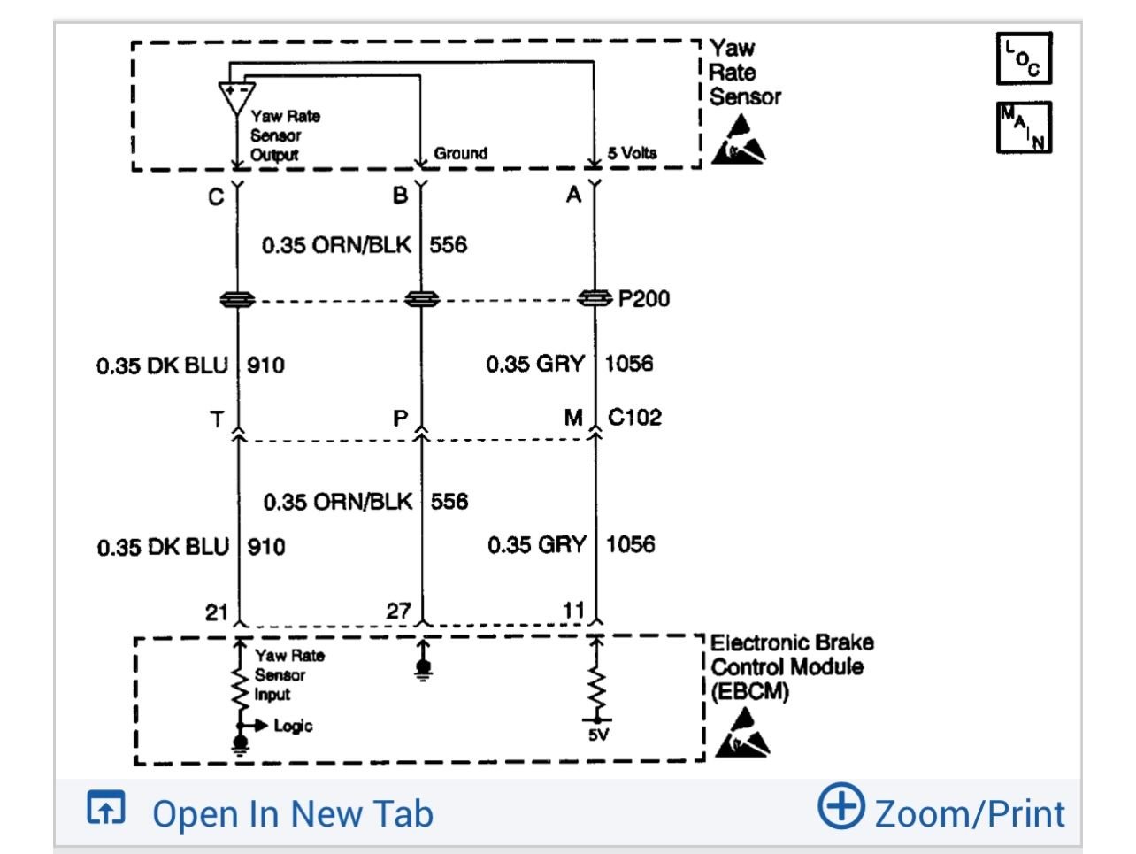

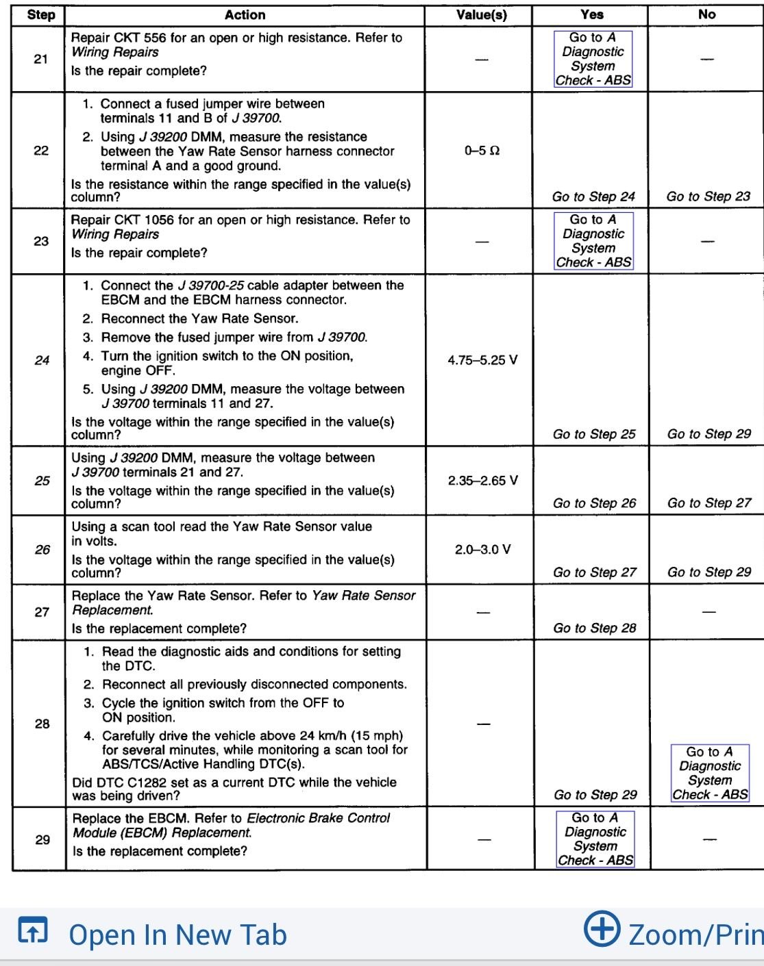

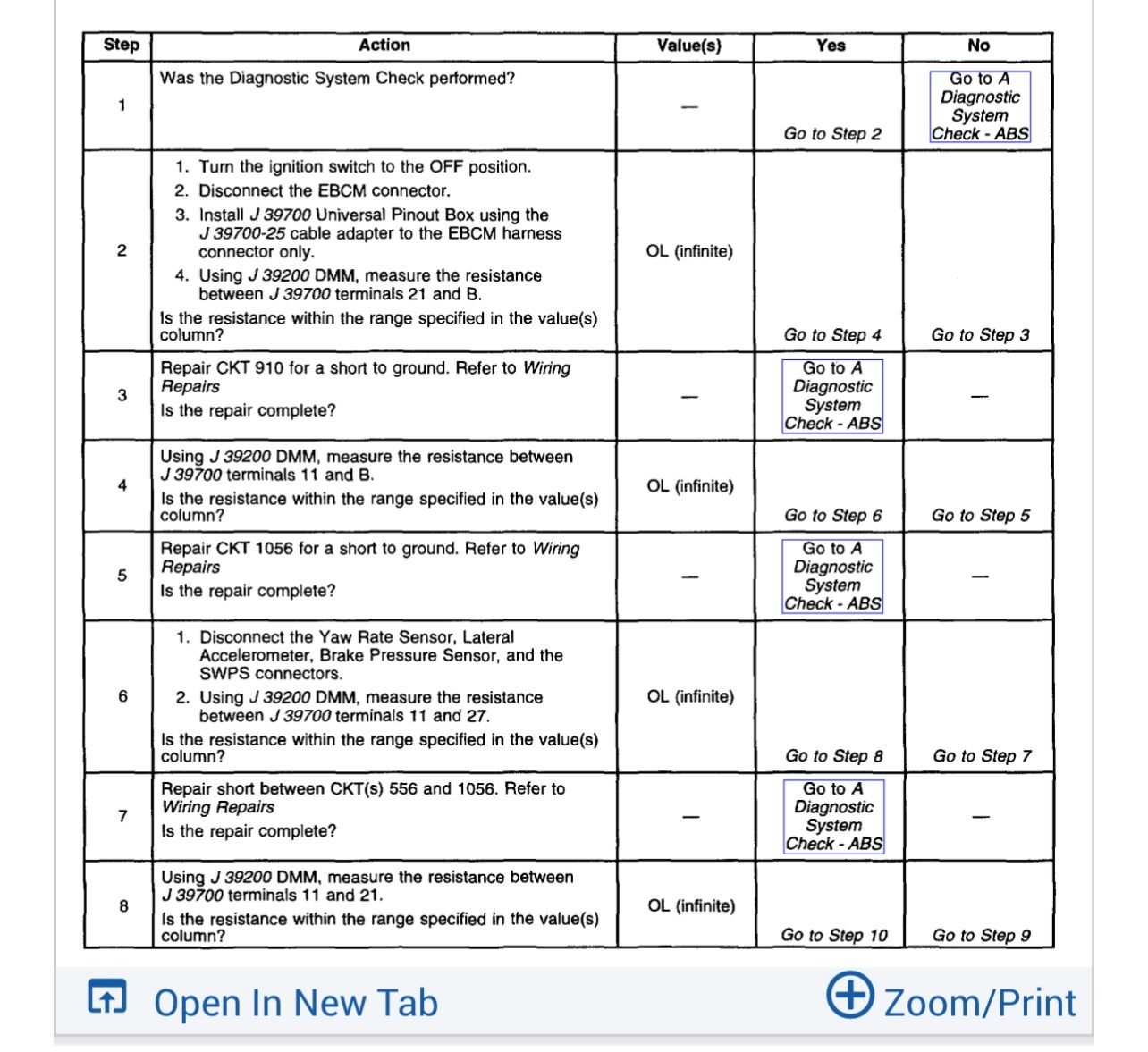

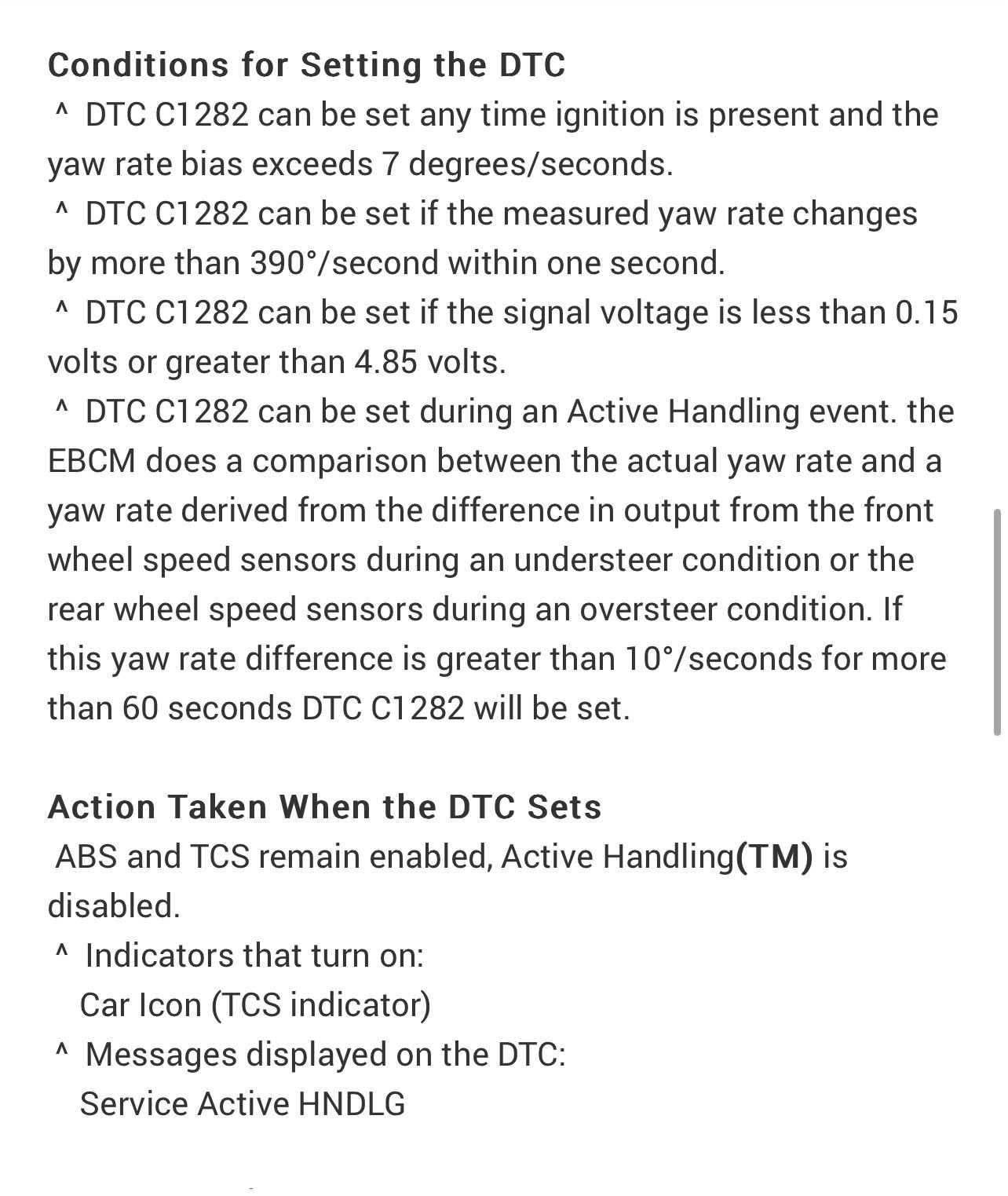

Hey everyone getting code 28 TCS C1282 H after i swing my car, it displays a service active handling sign in the dash but goes away after I turn the car off. Any ideas as to what this is? I never have any problems in regular or aggressive driving and the care slides great too, zero issues other than this sign that pops up. Anything I can do to fix this?
