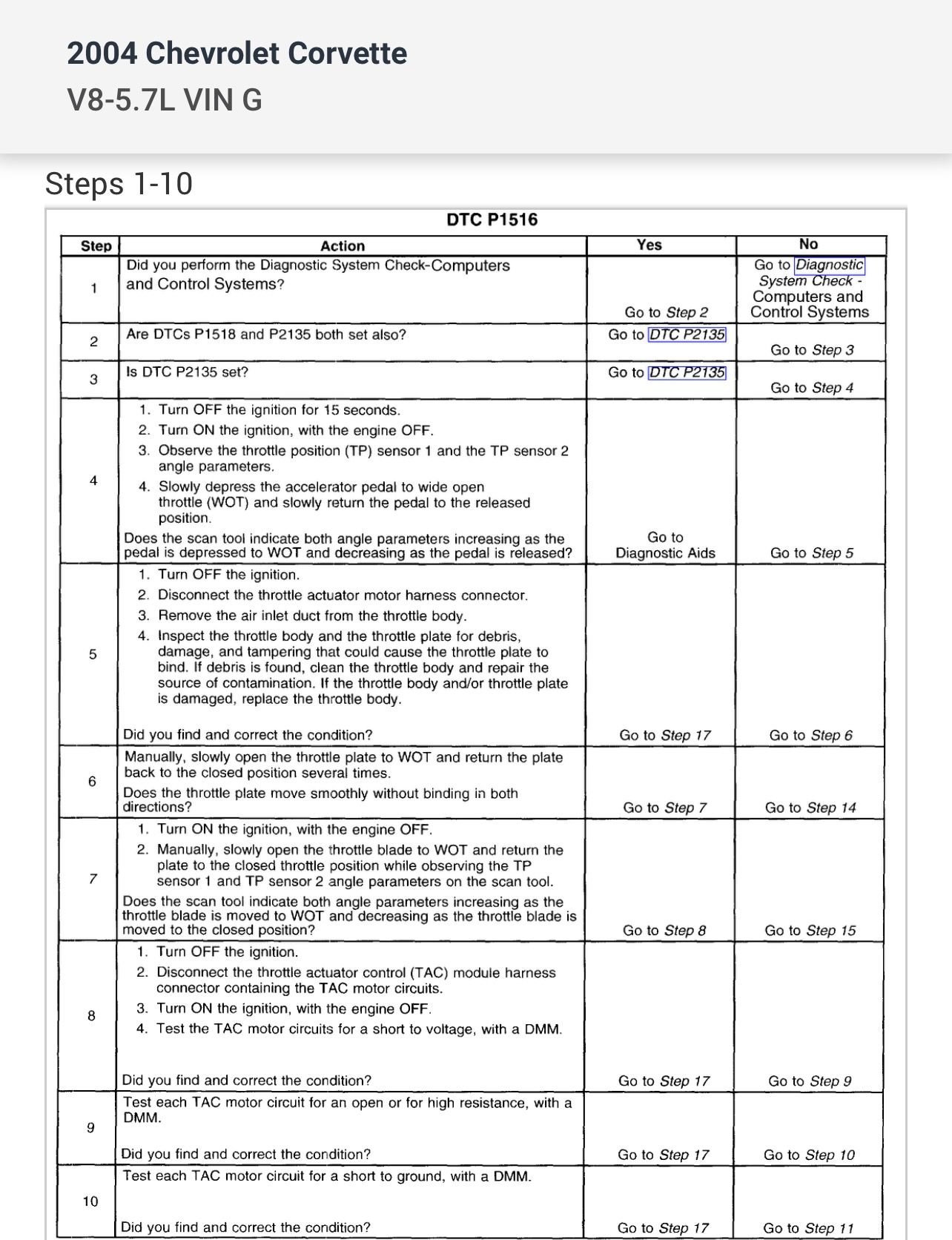

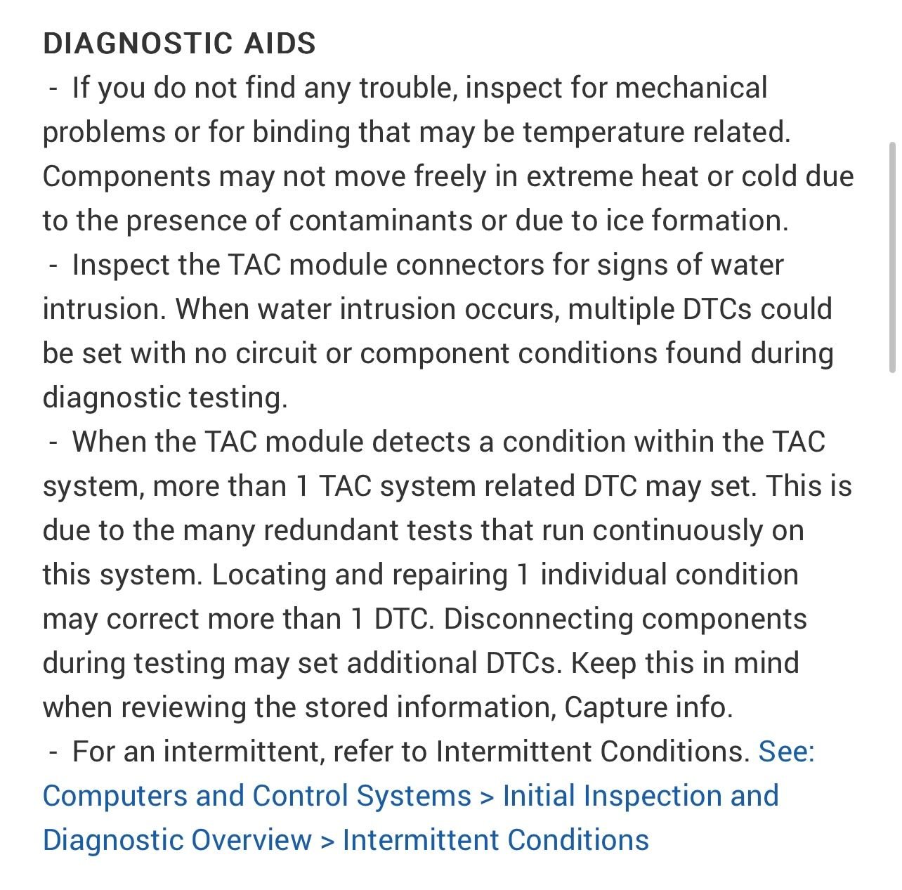

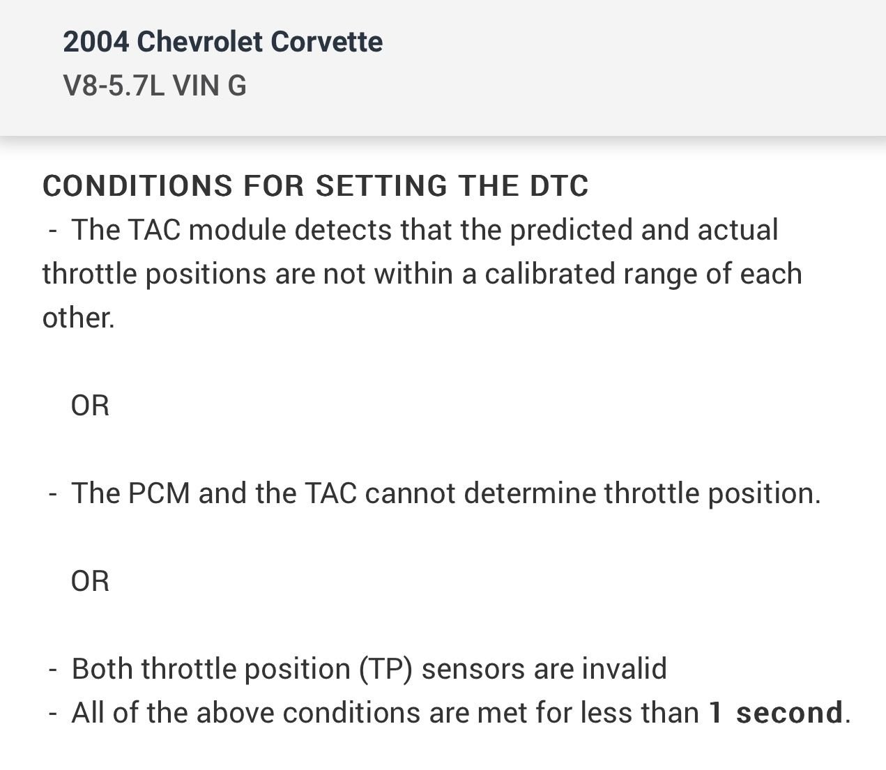

Unfortunately I can’t diagnose it for you and I “test and don’t guess” so I can’t say why these 2 DTC’s are being thrown…if it’s happening around 50% throttle I’d be using a labscope not a scan tool to see if the signals are dropping out…a DVOM or a scan tools refresh rate is way to slow…has your Corvette shop if they are weak at electrical diagnostics which most normally are followed the flow chart below ??…just because your APP and TPS are in “sync” means nothing…the flow chart below may help them…if you are in Southeast Georgia I can recommend a shop…cleaning the grounds unless they are involved in the TB, TAC Module, and APP circuits doesn’t really accomplish anything.

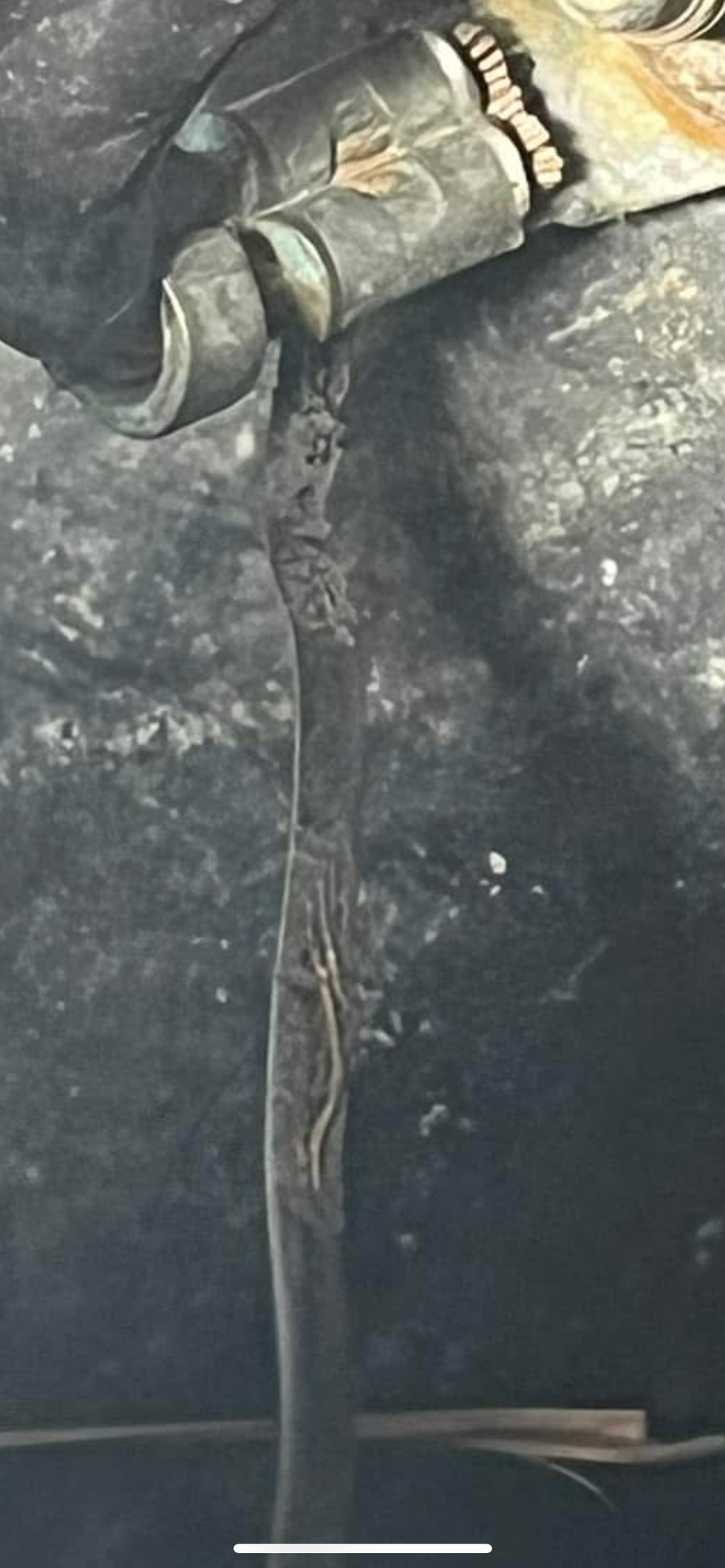

Thanks to help from Bill Curlee. The problem is fixed. Turns out it was a bad ground wire under battery tray
