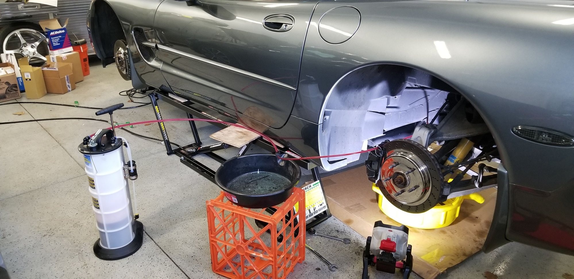

It's not difficult to do, but there are a couple of risks (and maybe a few worries).
The pan does not drain completely so removing it risks a spill. You might want something to cover the floor. A big sheet of cardboard works nicely. (I also used a Mighty Vac to suck out the sump as much as I could before dropping the pan.)
Be careful selecting your filter. Remarkably there is one on RA that (when you bother to read) is for "Z06, shallow pan", and it does not fit. My antenna weren't up. I didn't know the Z06 ever had an automatic.
I found the original filter seal to be too tight to remove without possibly damaging something.
The fill/drain plug is right up next to the exhaust. It looked worrisome, but the exhaust doesn't actually get very hot before the second fill.
Here's my setup. Good luck with yours!
